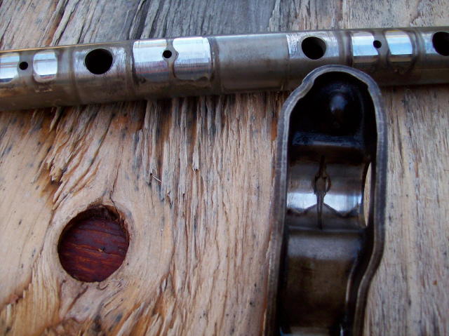

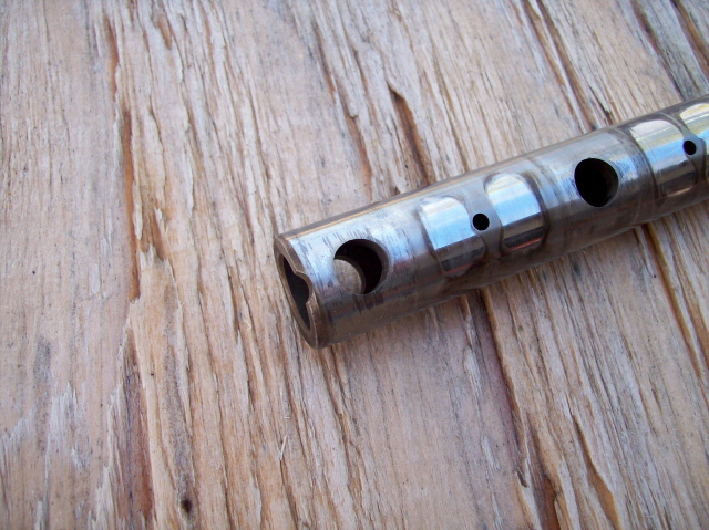

After reading some of the threads talking 'bout the proper install of the shaft I pulled a cover on my motor to see how mine is installed. On my motor the witness notch is down, but I don't have the type of rocker seen in those threads or even in the shop manual. This is the way mine was installed since I've owned it - 18 years. I don't think the motor had ever been messed with previously since it had around 80k miles when I bought it. I had to replace cam bearings a couple years ago, and replaced the cam long time ago but I never pulled the rocker assemblies apart, so the towers have always been in the same relationship to the shaft. Installing the shaft with the notch facing up would put the oil holes on top in plain sight with boat type or stamped rockers. What gives?! Here's a couple pics of the shaft and a rocker, also showing the wear on a 160k mile motor - normal?
I would say that is normal especially since you have had the cam bearings die on you so for at least for a short time the rockers May have been poorly lubed. The oil hole (boat rockers only) would need to be located such that is oiled the load surfaces like you show and not shooting the under side of the valve covers. You had it ok. I just looked at a used boat rocker shaft and it showed less wear but I am not sure how many miles it had on it. Mm sent it to me for a test setup sooooo... He will know.

Thanks for the replies. I pulled the other cover and of course it was installed the same. I also just looked at those pics for the 5-stand. So, is the 9-stand an older set-up? Seems like the shaft could be freshened by welding closed the existing oil holes and drilling new ones on the other side providing a new contact surface? At what point does the wear of the rocker assembly require longer push rods?
The reason I checked this out was because of valvetrain noise. My Scout will sometimes sit 2-3 weeks without being run. I can hear the lifters quiet down fairly quick after starting except for one tapping sound - sounds like the front cyl on the right bank. It does go away after several minutes. This motor has always had some valvetrain noise ever since I've owned the Scout, but the long lasting noise is since the new cam bearings, cam and lifters. I've only put 1,500 miles on it in the last 2 years.
Scouttoo, yes the nine post "stamped" rockers are the older version of IH rockers. Unless you find a good used set somewhere, new stamped rockers just are not availible, boat style are. I think some might say the can rebiuld the stamped rocker but I think the general concentses is just stick with the 5 post assmebly. I you can feel actual wear on your rocker shaft you acn also assume the boat rockers are also worn, possibly causing the noise you hear. I think ihon has shafts and boat style rockers if you need them.
If you go back to the thread for 5 post rocker there are 2 other links in the first post that pretty much tell you all you need to know about the IH rockers and their lubrication problems. Imho unless your shafts clean up better than in your pic, they look worn.

The two pics that scouttoo posted show perfectly normal wear pattern for the boat or stamped rocker assembly as Robert pointed out. And imho, after looking at hundreds of these items, I do not think they are as durable and trouble-free as the original design welded rocker units which incorporated an inserted bronze/steel composite bushing. But then...onna 160,000 mile motor what would anyone expect??? I mean...this shit wears out! It's no different than any other engine, no matter what the "ihc mythology" claims!

Based upon design...boat-type rockers must have the rocker shaft installed to the engine with the oil holes for the rocker bearing point down. Welded-type rockers muast have the shaft installed with the oil holes for the rocker bushings up! That is a simple concept to understand just by looking at each when compared.

Thanks again guys. When I looked at the pieces it seemed to me it was installed properly, I just wanted to make sure. Obviously 9 stands are gonna hold the shaft better than 5 - deflection. I'm running napa 20w50 oil, could there be any benefit to using a synthetic in the same weight to help quiet the lifters or would it be worse? I wondered just how hard the shaft is to drill! I know the rockers are gettin oiled because of oil pooled in the recesses of the rocker. So, longer pushrods can't compensate for wear of the rocker assembly?
The only way to "compensate" for wear in the entire rocker assembly is to replace the shaft and rockers with new! And because of the inherent slop in the boat rocker setup (they flop all over the place at speed), that won't make any difference either unless the lifters are at the end of available "travel" and can't compensate for variations in valve train total dimension.
With the boat rockers/shaft ya can't even measure the wear inna cumulative fashion as ya can with the welded rockers/shaft. Ya can only measure the "roundness" of the shaft at the point of contact. If you are concerned with the rocker/shaft wear, then simply replace both assemblies with new parts, those are very reasonably priced! You would need only two shafts and 16 rockers, ya don't need all the associated "conversion kit" parts.
