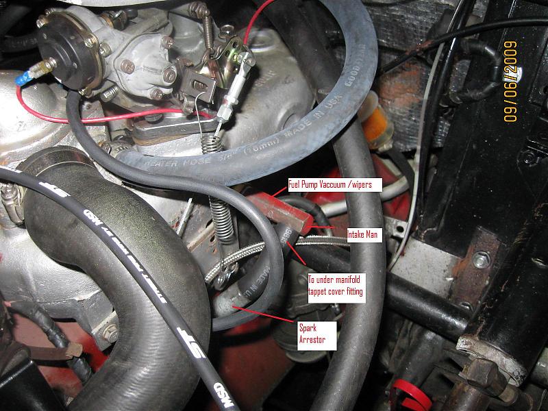

Here are pictures, tappet cover fitting through, spark arrestor, into manifold, fitting in mani also has vacuum wipers on it. I have cleaned the spark arrestor and checked function, and it flows from crankcase to vacuum manifold

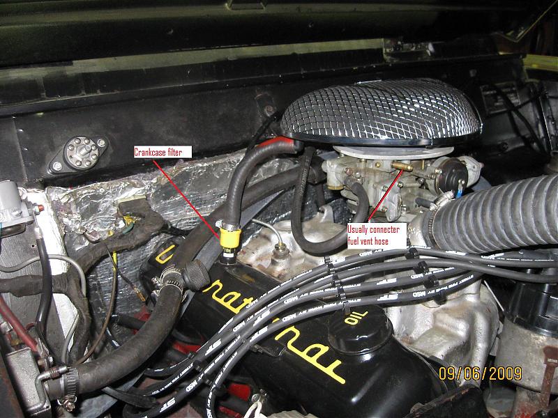

flow through air filter, into valve cover through cleanable cranck case filter, not a pcv or check valve.

Good pics, but you have your labeling mis-represented.
The flame arrestor component is mounted in the valve cover, that is a simple canister containing wire mesh and is not a check valve of any sort. And in a "closed"-type pcv system that is the fresh air source (pulled through the clean side of the air filter assembly) that allows clean/filtered air to enter the inside of the engine.
The device you have labeled as "spark arrestor" is a "cleanable" ac sparkplug p/n cv 619 pcv valve. See this thread:
http://www.forums.IHPartsAmerica.com/gas-engine-tech/2244-servicing-cleanable-pcv-valve.html
Most likely it is installed backwards. It is a one-way valve that functions as a "metered" vacuum leak under certain manifold vacuum conditions.
One end of that pcv has a threaded nipple that is one-piece with the body. That end must go to the manifold vacuum source on the intake manifold. The other end has a pipe nipple screwed in..that side must be connected to the fitting on lifter chamber cover.
If the pcv valve is not plumbed correctly, the crankcase is being pressurized and can't "breathe through the pcv system...thus the oil liquid/vapor blowout from the filler cap area.
If the pcv is plumbed correctly on your engine, then it's most likely clogged and prevents proper pcv operation...clean it!
To check proper flow direction for the pcv valve, it should allow flow in only one direction...it is a one-way check valve with a calibrated balance spring.
