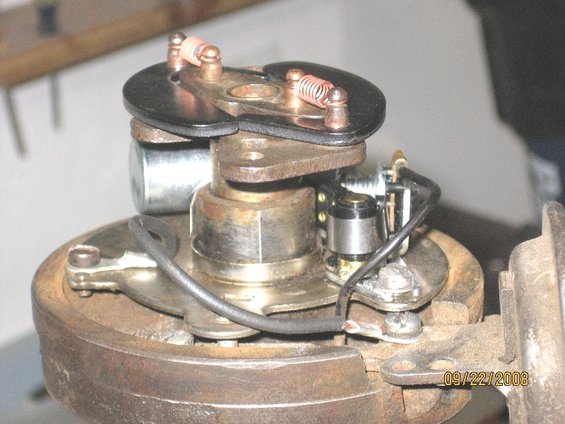

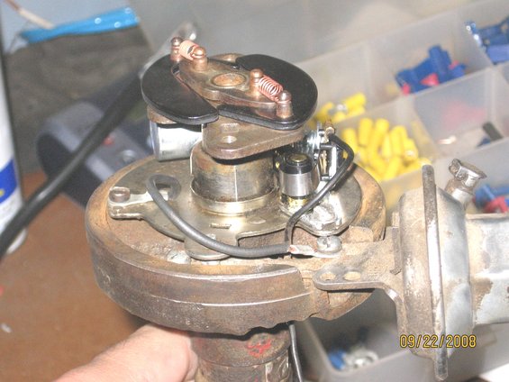

Sorry, its a delco on a 1961 152. You can see the tab just to the right/under the coil lead wire. There is a small solder spot on the dist base plate just to the left of the wire, and above the square hole that I am assuming had another tab. Also included a shot of my points that is apaprently the replacement. Any comments on this style of points micheal?

That braided copper wire is the ground or "bond" connection between the upper and lower breaker plates. Since the upper breaker plate rotates onna bushing when actuated by the vacuum can, the plate must have a continuous ground path to the distributor body.
It's very common to find the wire connection either broken, or the entire wire missing. That was the case with the distributor in this pic. So I fabbed a new ground lead that is routed so that it allows plenty of flex/movement without binding the upper breaker plate. Even though the distributor body is painted, the paint is removed from the ground point under the vacuum can mount screw.
Your other pic is a delco "unipoint" set. That was developed in the mid-70's as an "enhancement", combining the separate breaker point and the condenser together as a set to make service a bit more efficient. The unipoint will backfit into any of these delco distributors.

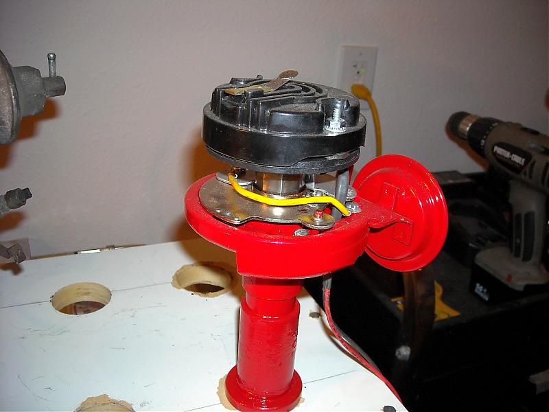

The distributor in my pic has been converted to a pertronix trigger and has had the mechanical advance curve modded. I've not installed it for a test unit yet as I want to put a few more miles on the currently installed Holley before doing so. That one is for an sv application...the only difference between that distributor and the same item for the 152/196 app is the fact that it has an eight lobe breaker cam, instead of a four lobe cam, and the advance curve is somewhat different.
The trigger wheel for this delco pertronix app is selective fit-mounted under the rotor, quite a bit different from a pertronix module used in a Holley distributor. It has to be shimmed to the rotor to achieve proper trigger wheel air gap over the pertronix pickup.

Here's another shot showing the p-tron module, the air gap between the trigger wheel and the module is critical as that determines the dwell. And it is adjusted and locked in only after the endplay is set for the distributor. Endplay is controlled by shimming the distance between the drive gear and the end of the shaft housing, ya want that around 0.010" for most accurate timing control throughout the rpm range.

Thank you. So I can mount the wire in any fashion that works so long as it mounts tot he dist plate and somewhere on the vac adv? I can reuse the vac adv tab easily, and can just mount the other end to the points screw or drill a new hole? Looks like you used 12 gauge wire, is that right?
One other newb question, but where does the coil lead wire attach? It looks like yours mounts to somehwere up into the points? (or in your case the pertronix?)
That's a 14 gauge wire, 16 gauge might be better as it's more flexible. The wire does not have to be insulated...it'sa ground! Radio shack sells small quantities of braided "bonding" cable that would be best to use, I was simply out -of-stock at the time I did this one.
Don't drill any hole! Just use the mounting screw for the breaker point set at one end, and one of the screws for the vacuum can at the other end.
That braided ground wire was originally spot welded on the upper and lower breaker plates to create the ground path.
All you need to insure is...the upper breaker plate to which the points mount must be grounded to the distributor body. Other wise, when the points are closed, no current will flow through the primary circuit.
The wire from the coil negative terminal goes to the insulated connector point on the unipoint set. That wire must be insulated from ground so that the breaker point can act as the "switch" for the primary circuit of the ignition system.
So I have instadlled the recurve kit, and re done the ground wire on the dist. Not sure which springs to use for the curve kit?
Installed teh ground from the front screw on the vac advance to the unused screw seen in this pic. The screw all the way to the left on the dist plate
Still not sure where on the points the coil lead goes. The only screw on there is spring loaded, and just behind the condensor. Is that the correct location?

Regarding your unipoint set and its connection to the primary pigtail...your tag end of the wire has a "fork" terminal right?? Simply push the fork down between the white insulator and the insulated breaker point "spring" that touches the insulator. The spring holds the fork connector in place against the insulator making good contact. If you put the fork terminal on the ground side of that insulator (against the frame it snaps into), the primary pigtail will be permanently grounded, no switching action, and no spark at the plug!!

This look about right? There is no white insulator, but black instead. I believe this is the point you are referrring to.
You got it!!! Nice work!
I said "white" because that is what is shown in that original pic you posted. But I've got several sets of "unipoints" here also that use the black insulator!
Color don't matter as long as the fork of the connector is insulated from ground!!
Shit...obviously I'm colorblind too now! The unipoint in your first pic does have the black insulator! I'm just used to seeing these thangs over the years with white ones!
I told ya...ya gotta double check anything I say/write!!!!
