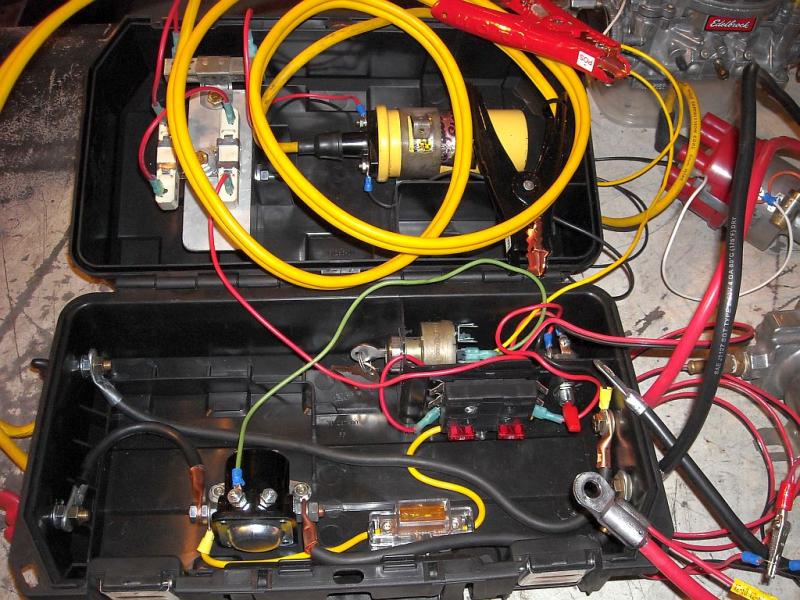

I keep on hand in my shop a standard motor products ru10 for the application you describe. For a v8 breaker point ignition when used with a coil with a primary resistance of 1.4>1.8ohms, that is a perfect match of coil saturation/breaker point current draw vs. Breaker point service life. A wells cr 107 works just fine also, it's well withing the tolerance band for a v8 breaker point distributor if used with a proper match coil.
A wells cr139 is rated at a nominal 0.8 ohms, way too low to use with a v8 coil application, but perfect for a 4 cylinder ignition as long as a coil with a 3.0 ohm primary resistance is used. I also sometimes use two wells cr 139 resistors wired in series for use with a v8 distributor.
In this pic you see my "electrical system in a box" as described in this thread:
http://www.forums.IHPartsAmerica.com/electrical-tech/1843-electrical-system-box.html
The various ballast resistors that are mounted can be configured to provide various values depending on whether I'm going to install it on a four, six, or eight cylinder engine. Those are all various wells part numbers though brand name doesn't matter at all, only the value of the resistor.
