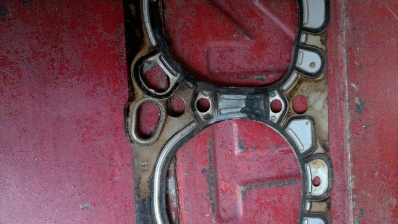

Just an update, headgasket is bad. You can see the clean area. I am checking for warped heads, today (finally got a "real" straight edge, for such things). I May have to send out heads to be shaved, if bad, as no one in town does heads anymore :(
You're going to want to shave those heads. Iirc the new head gaskets are .040 thick and the old steel shim ones are .016. Check the seats and guides while you've got the heads off. Next question how to the bores look?

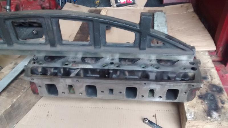

Checked heads with real gauge. .004 fits under bar on both heads. So. Looking to get them decked. As that is above spec. Sigh. Here is pic of gauge.
I feel your pain.
