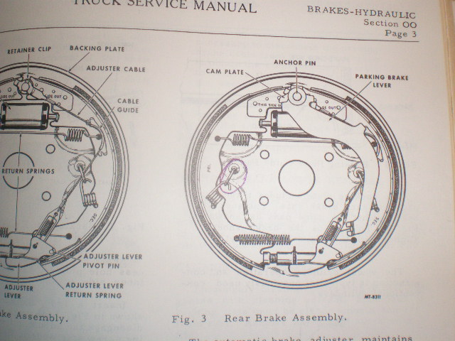

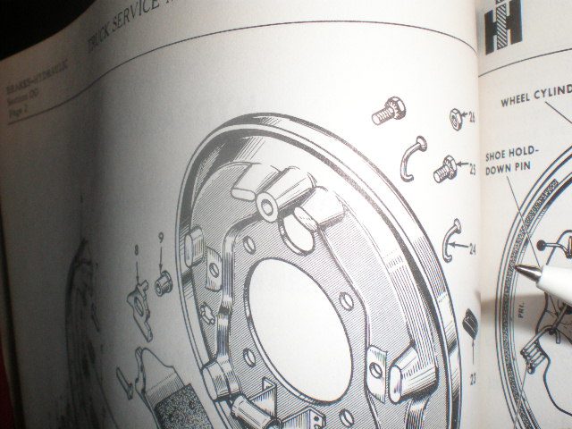

Grind off or chisel off the " brake shoe spring hold down pin " that go thru from the back side of the backing plate.that actually hold the shoe's on.the 1st pic you can see my pen pointing at the hold down pin.( #24) thats holding the spring tight to the backing plate.get rid of that an it'll loosen the shoes, pic # 2 show's the pin holding the spring to the shoe,it's circled.then you can move the drum off or away more to get a hold of the adjuster better.Jeff
