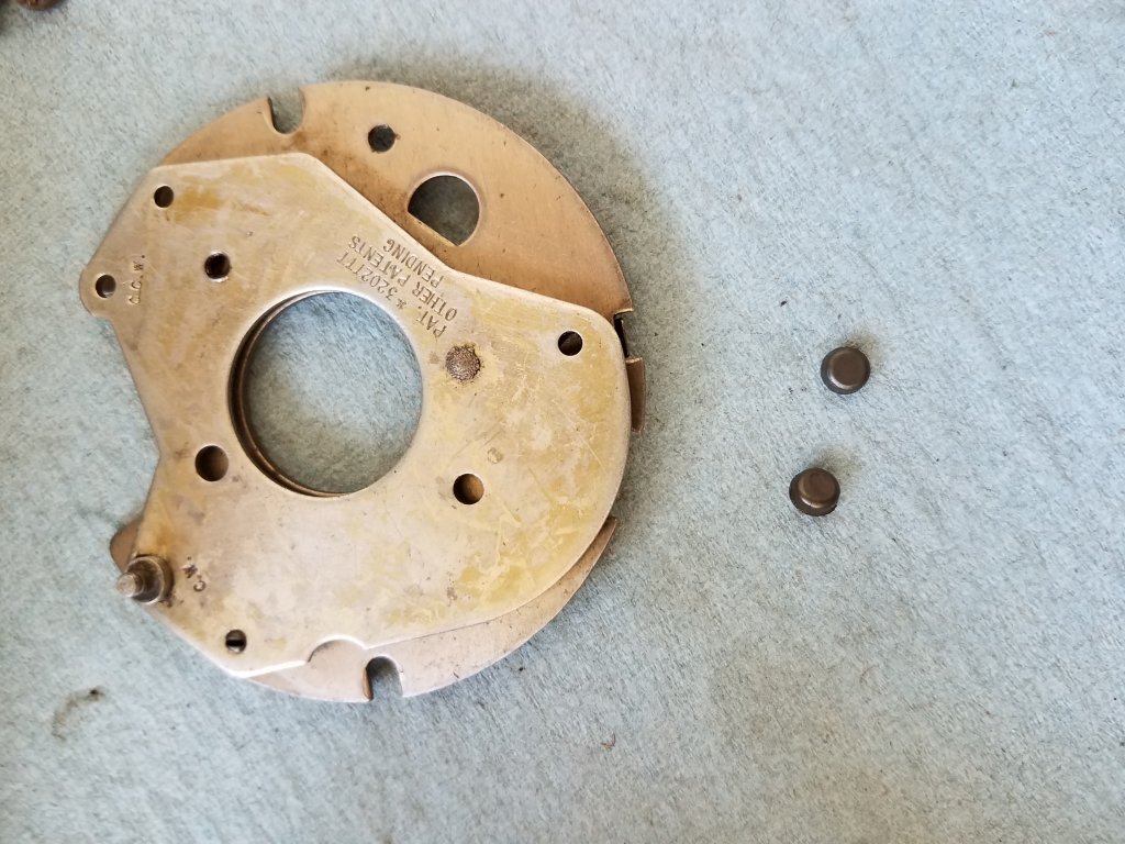

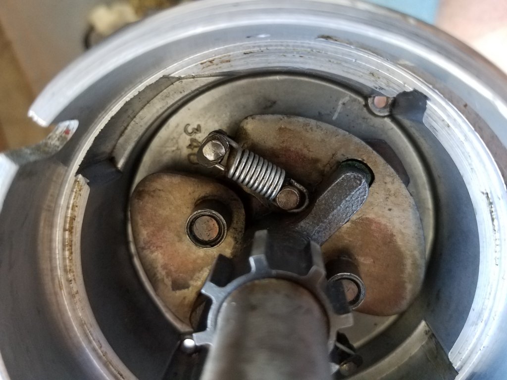

Hi All, My 345 engine is out for rebuild. Last night I partially took my Holley Gold Box Distributor apart to remove and clean 47 years of grime off of it. I was planning on upgrading with a Pertronix Ignition system. I noticed two of the three plastic isolators that sit between the breaker plates were bad. Their plastic legs that hold them in the breaker plate were broke off. Also I noticed one of the advance springs seemed to be loose but not coming off its post. Any suggestions? If not repairable and I need to go with a new DUI distributor what headaches may I occur for fitment and movement for tuning? Pictures attached for viewing. As always all advise is appreciated. Have a great day.

You probably want to read all the way through the product description page for this item in the IHPA webstore. It will answer your questions, or at least provoke you to have more specific questions to ask the gang via a phone call during business hours.
Mallory sells a advance recurve kit that has springs and bushings. I used bits and pieces to refresh a Holley GB distributor that received a Pertronix conversion. DUI is a waste of money for what you get. If you want a HEI conversion, look up Bill Hamilton's pages here. Benefits include: easily replaceable parts, and if you ever go FI, (which he sells here), you're already halfway there.
I gave IHPA a call regarding my breaker plate and they suggested to make a trip to IH Only in Lancaster that they may have the parts I'm looking for. Lucky for me it is only a 2 hour drive. I picked up a good used vacuum curve plate, 2 barrel non-egr manifold for my 345 and a RPT power steering bracket that eliminates the smog pump. Mike also took a look at my distributor and checked for side wobble on the shaft and looked at my springs and said it was in good shape to use with the conversion. All is good. Thanks for the info on the recurve kit you suggested. I will look into it.
