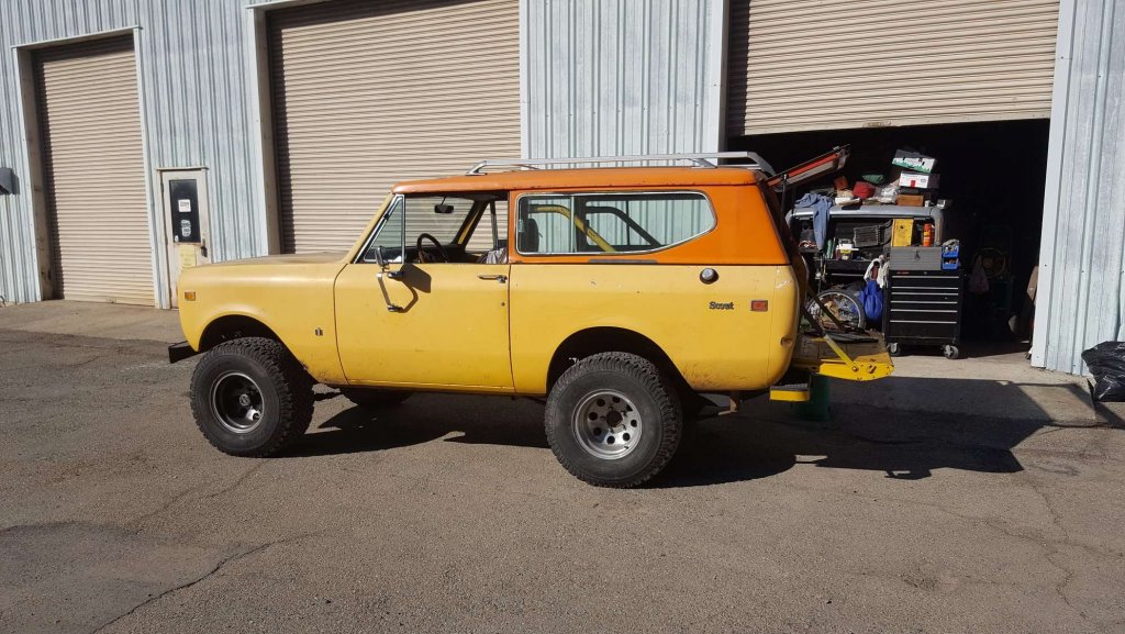

I have done the shackle reversal kit install. Along with rebuilding both my axles with new gears and other new parts. I also did the Cut-n-Turn on the front axle. Still sprung under. After getting the alignment done, it handles awesome. Especially after installing the X-cross brace kit. Scout now handles almost better than my 2002 Toyota sequoia.
wow...impressive, thanks. what lift do you have? did you use lift shackles in the rear?
No clue what springs are installed. The current springs, 2" body lift, rear shackles and mismatched 33" tires were on it when I acquired that scout. Not sure exactly the length of shackles, but me thinks 5".

At semi full compression while turning right, I do get a little fender rubbing at the lowest forward corner of the left front fender.
Other than that, no other problems with suspension. So far
