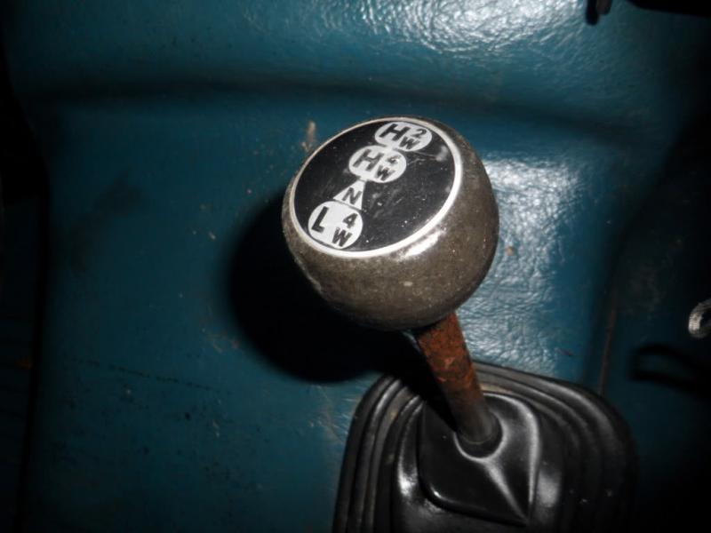

Transfer case:
tc-141 is IH code 13141 which is a new process model 202, single lever - two speed transfer case.
Shift pattern from front to rear:
2h-4h-n-4l, photo attached.
Thanks for the IH codes for the np 202. That helps.
And also for verifying the 202 shift pattern - wanted to be sure it hadnt been switched out - as it doesnt feel like its going into 2hi.
