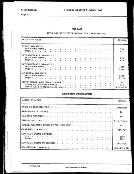

Around the lower portion of the distributor housing there should be a thin aluminum band that is stamped with the delco part number for that distributor (there are many part numbers used on these engines).
Then compare that part number to the matrix shown in the service manual for all delco part numbers used in the 152/196 engine series, that tells what the specs for that distributor are, they do vary from p/n to p/n, they are not "all the same".
The most common delco p/n used in the earlier 152 is 1110266. Attached is the specs for that sparker. Keep in mind, the rpm specs are distributor rpm as used with a distributor machine, not engine rpm.
