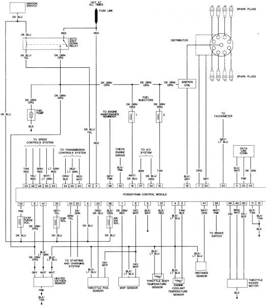

Thanx for the reply! I have a wiring diagram from chiltons online. Acording to it, the pos side of the coil is run on a relay controlled by the ECM. The neg. Side goes directly to the ECM. I tried putting 12v on the pos. Of the coil (stock wire disconnected) just to see if it'd work. Still no spark.
Dodge made their system a little less user friendly by putting the ignition module in the ECM.

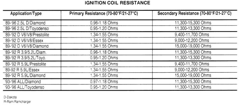

Looks like the main relay for the ignition and fuel should be checked first. For power but I will upload the wiring diagram, coil specs and a link to the no start trouble shooting basics.
