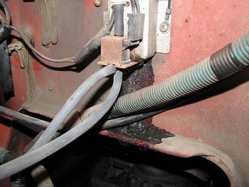

That is why I suggested you totally bypass the dtm system and drive the rig and determine what happens. There are other "things" going on throughout the entire emissions/drivability scenario on any emissions engine, stuff that changes to some degree continuously. You May in fact have other issues happening intermittently also.

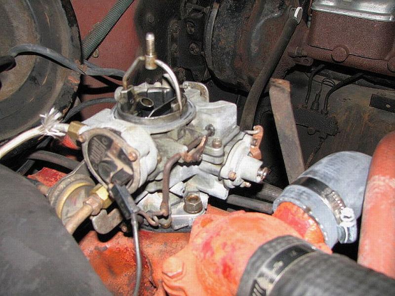

Good to have you back mayben. The entire dcm system is unhooked. This is what happened once it was unhooked, but I bet the motor is not hot enough when I am making adjustments. I'll readjust everything tomorrow.

Ok with dsm disconected, I took the Scout out for a good drive,motor good and hot and came abck to make my adjustments. The motor being hotter put my idle speed up around 600 rpms so I put them back to 550 rpm. Rechecked timing, adjusted the air mix on the carb and rechecked the rpm's, which were still at 550 rpm. Took it back down the road and came back , killed it, and it caughed a little out of the tailpipe(light backfire). Confused!
So...your latest testing indicates the dtm module is punkee. Put a replacement on the list of parts to look for, that has nothing to do with actual operation/drivability of the entire machine. You will come across one at some point.
