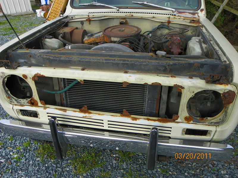

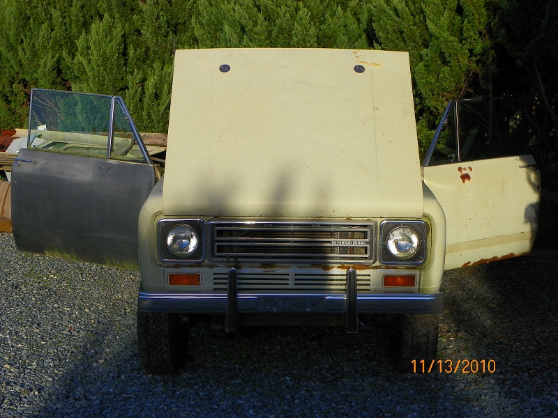

A friend of mine found a 78 Scout II in a back yard and bought it. I soon talked him in to selling it to me. I've had it for about a year and a half, mostly sitting and waiting. The truck was sold new in hanover,pa. From the condition it's in, I think it was garaged for most of it's life!! Some one had started some metal replacement (rockers & floor) and not done a very good job. That's all coming out. It's a 304/727, d-20 w/d-44's, bench seats, no a/c. The truck is pretty much all there.
I've found a fresh '75 casting 392 to go in it!! This engine was built by a 42 yr. IH diesel engine mechanic to put in a t-all for pulling events. Got a nice cam, all new internals & a tq for go juice. I've got a close ratio 4-spd. To go behind it.
Build plans include 4" rc springs w/SOA, reverse shackle, 2" body lift. I haven't figured out the steering yet, but I got time. I found a 79 s II donor (rust bucket) including the parts for the auto to manual conversion, bucket seats, all good glass and a bunch of other stuff.

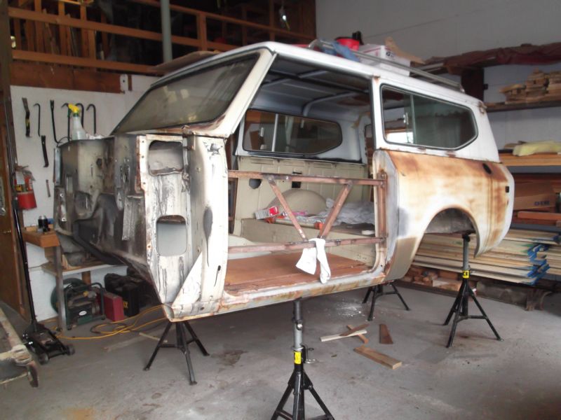

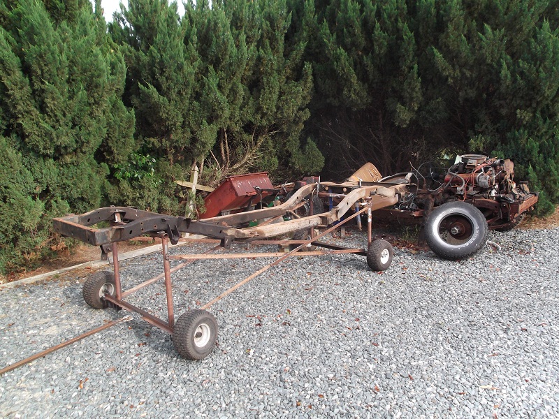

Currently, the truck is completely disassembled: body off frame, both on carts ready for fab. Being a woodworker/cabinet maker for 20+ yrs., I'm slowly converting my shop from wood to metal!!! Working on this Scout is another reason to buy more tools!!!

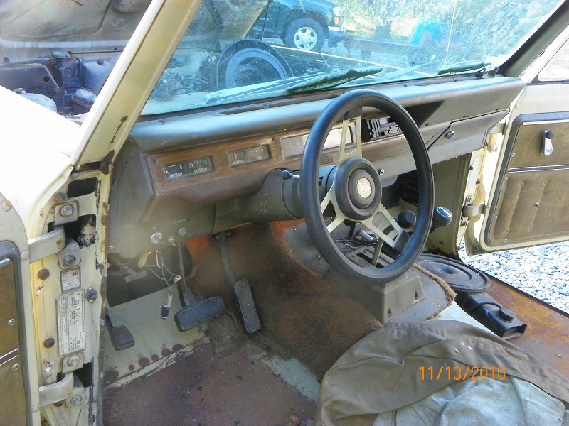

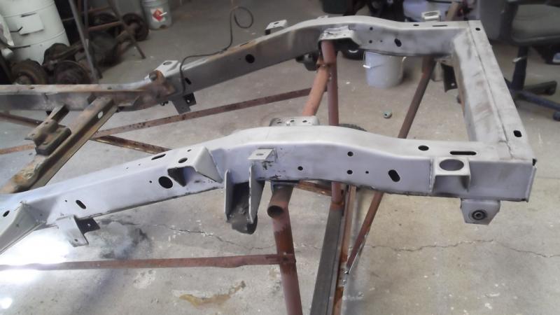

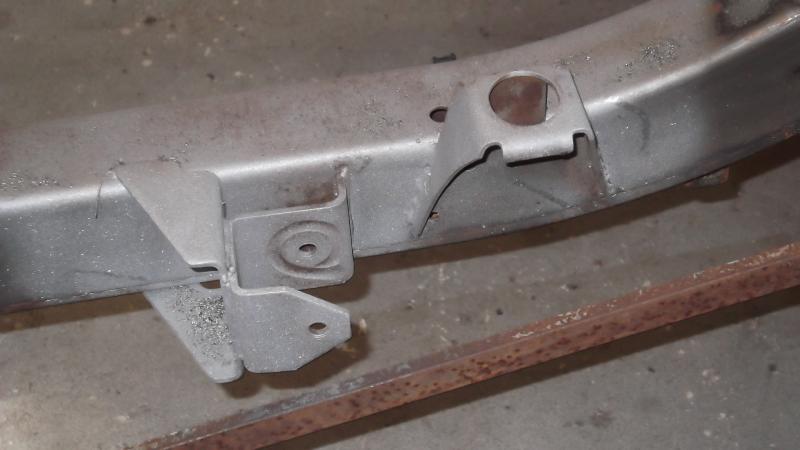

Well, after long last, I have really begun to put this thing back together!!! I began blasting the frame Saturday,just cleaning the areas necessary to begin the SOA, c & t, new lift springs and any other frame work necessary. I'll do a complete blast when I'm ready for paint. So far, everything looks pretty good!!! The only real "wear" I see on the frame, bracketry, etc. Is at the driver's side, inboard of the front rear spring mount. Hopefully it can be seen in the picture? I'm going to fill teh wear with a mig bead. Opinions?
More frame pictures. I have parts in fab for a 1 1/2" body lift. I have reinforcements in the works for the spring hangers & body mount posts.

I've heard you should drill a small hole at each end of the crack first, then v out the crack with a grinder for maximum penetration.
Your mig will do a great job as long as the amps are up enough for the thicker frame steel. If you are worried about metal fatigue you could overlay a plate after grinding the repair weld smooth.
As long as it doesn't interfere with anything you will be good to go!
The spring rub on the hanger is about 1/16" deep with no visible crack. Since I'm installing new alcan's, I don't want them to "take a set" from the stock springs. I plan on welding in short passes so as to prevent overheating then grinding/filing the surface flat.
I do have one more issue on the frame to address. I have to replace the rear crossmember with one from my donor. Apparently, the Scout took a slight hit in the rear or backed into something. The bumper was bent as is the crossmember. I had to cut notches in it to reach the gas tank bolts. I'm going to pick up some grinding wheels today and get on that tonight. More to come................

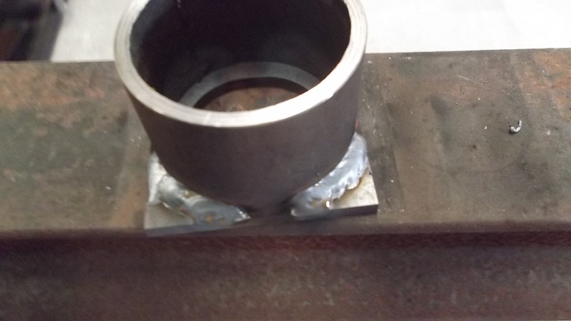

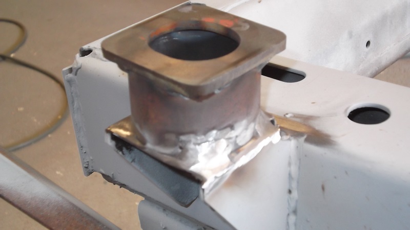

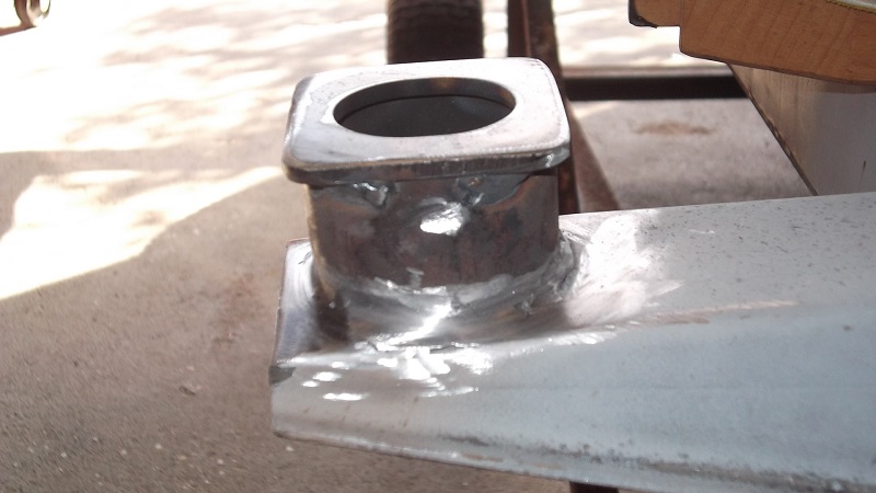

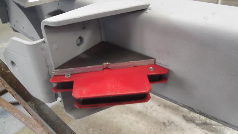

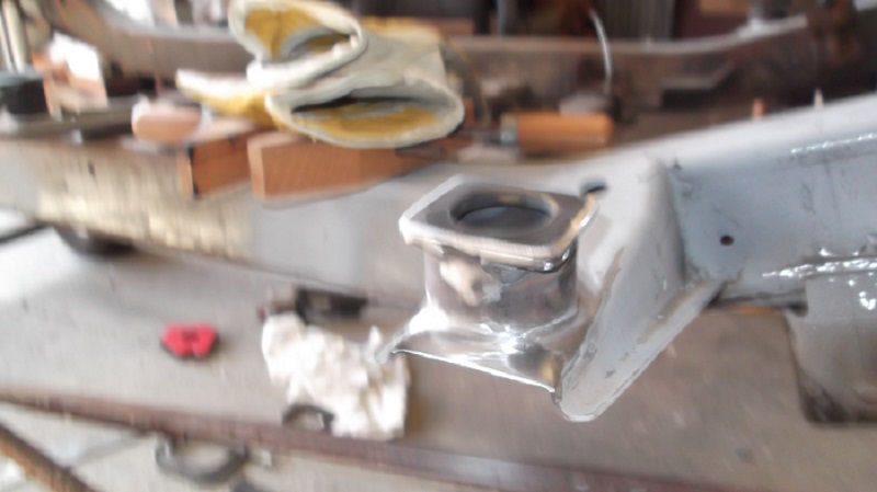

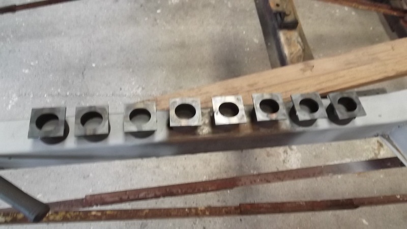

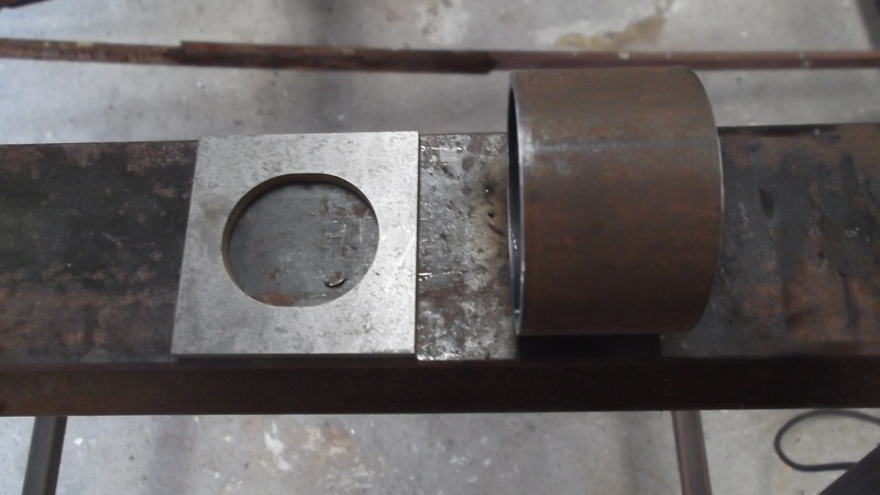

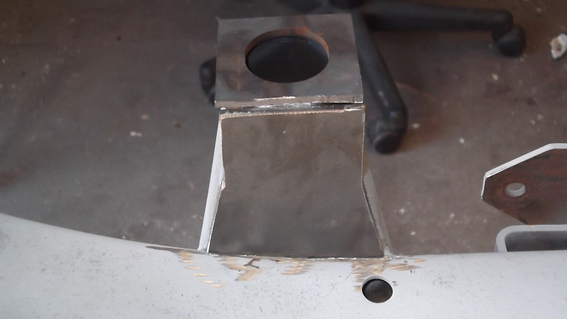

With the expert help of drt steelworks, we fabbed up my body lift parts last weekend. The new mounts are 3/16" plate with an identical oval hole as stock. They are welded to a piece of 2" id welded pipe that rests perfectly flat at each mounting point. The new Energy Suspension body bushings from IHPA fit inside the pipe with a small amount of "wiggle room". I like this set up as the bottom of the bushing and the bolt/nut are protected. I have to "round out" the original oval bushing holes in the frame to insert the new bushings from the bottom. I began final location of the new mounts tonight. Once oriented, I am indexing and marking the position of each. I will grind the square corners down before attaching.

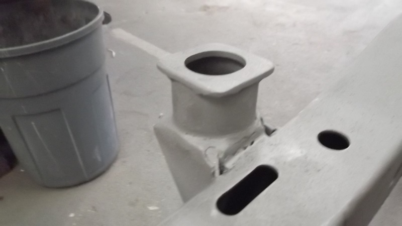

I now have 6 of 8 new body mounts in place. I have to r&r the rear frame crossmember before I can do the rears. My donor has a good one, just got to get to it.
Because I'm changing the suspension geometry and center of gravity, I'm reinforcing mounts and brackets as can. The new mounts as shown, with the new bushings from IHPA provide right on 2.5" of lift. That said, I'm "thinking" about the "paul harvey" #aka - the rest of the story# concerinng mounting things "body" related.

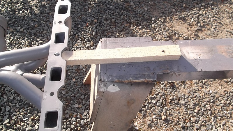

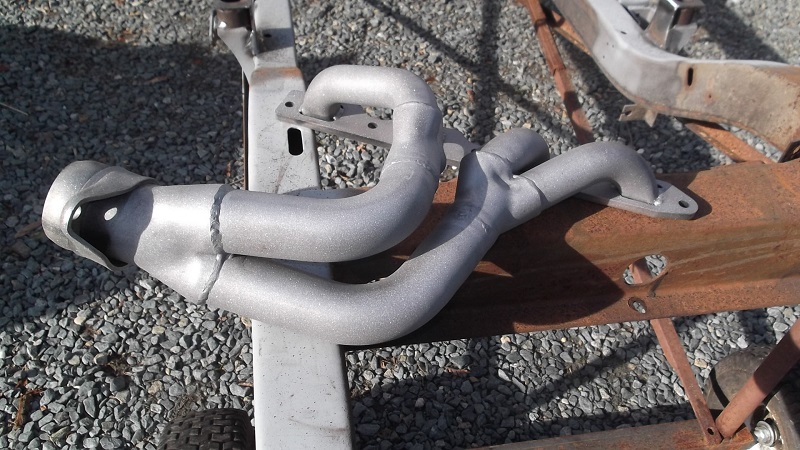

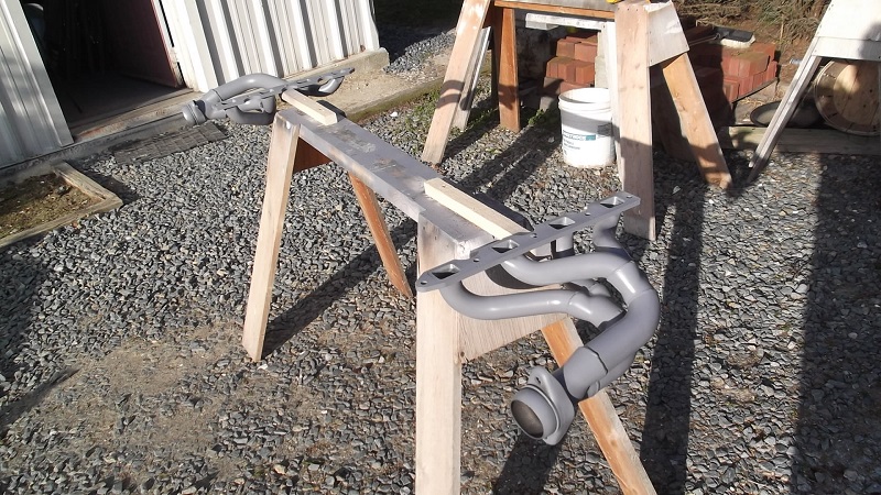

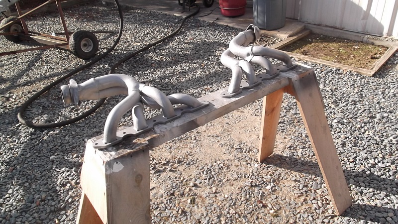

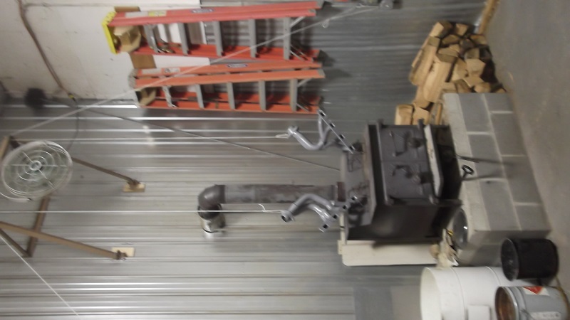

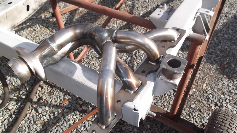

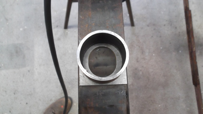

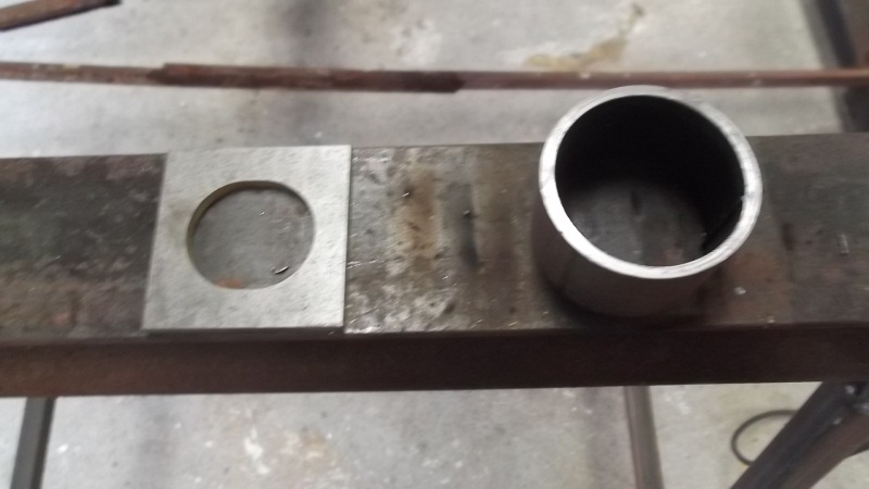

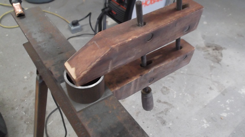

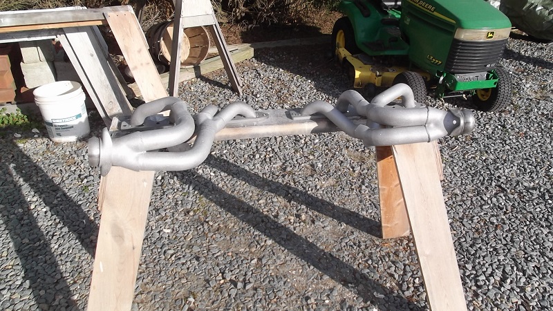

Since it was sooo nice today and I did have the blaster runnin', I cleaned up the stan's tri-y's from IHPA with a low pressure blast to prepare for finishing. The "blue" dissapeared quickly as did the marked "center line" of the tubing. The tubing and welds are beautiful after blasting & priming. They should finish up well. I have a plan to "bake on" my finish coats involving my winter shop heat source. Won't need heat much longer so gotta get this done.
A saw horse, couple scraps of wood and a few screws provided support for the headers, either side up. I used vht gray primer. After curing the primer, I will apply and cure several costs of john deere black muffler paint. From what I can figure, it's the stuff!!! We'll see??????????????/
You do really good looking work codeman. Looks like everything is coming along nicely. I'm curious about your body lift though? Why did you choose to go the route you're going and how much lift will you achieve? Also, what size shoes are you going to put on her and are you looking to avoid modifying your fenders to avoid rub?
Thanks for the complement!!! I try hard to think things through, looking down the road to the end result. I guess that comes from years of home building and knowing what can happen if you don't!!!
I'm doing the lift this way b/c I don't like the design of the "standard" lift kits on the market. To me, a big block with a long bolt through it provides the opportunity for movement. Since the body is off the frame, the weldments can be attached and be very strong. Fortunately, drt steelworks has been a valuable resource for fabrication. We duplicated the oval holes in the frame body mounts on 3/16" plate, 2.5" by 2.5". The 2.5" square dimension is a perfect fit at all mounting points. It allows for very easy alignment of the weldments visually and with a straight edge. Then, we cut 2" id pipe to 1.6" long, trued one end on the lathe and finished the other to 1.5" overall length. The new mounts sit completely flat on the existing frame mounts and provide significant surface area for welding. With the new body bushings from IHPA, the total body lift is right at 2.5".
I"ll be going SOA, r/s, with new alcan springs providing an additional 2 - 3" of lift. So, I guess I'm looking at about 10 - 11" of lift at the rockers. As far as tires, I'm thinking a minimum of 35's??? Once I have the body back on the frame, I'll be able to determine actual clearance. Then I'll decide????

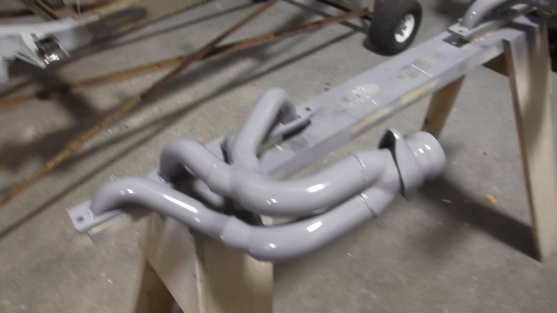

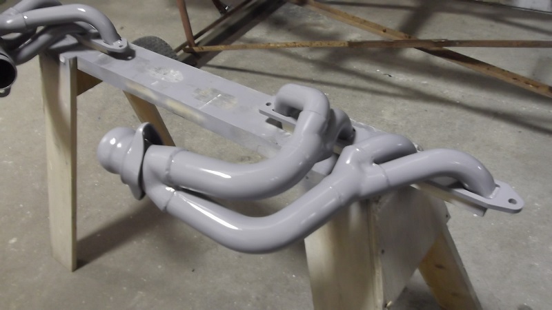

A week later and another coat of primer on the headers. The vht directions say to allow 1 week for curing if you can't com-lete the finishing in one operation. I hung them over my shop stove for a while before doing anything. Then, after they had cooled to ambient temperature, I scuffed the stan's up with scotch brite, wiped them down with a tack rag (previously used but still picked up alot of dust), recoated with primer and made my best attempt at "curring" the paint. Tomorrow, ill scuff again and apply the 1st coat of jd muffler paint.

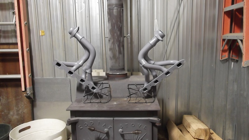

I got some more paint on the headers this week. I scuffed them Sunday afternoon, put another coat of primer on and hung them over the stove for the night. Monday, I scuffed the primer, sprayed first coat of jd muffler paint and hung them over the stove.
A friend has an infra-red thermometer he gracoiusly allowed me to borrow. I've been burning this stove for 14 years and never knew how hot it got until last night. As you can see, the ir thermo tells the story!! I shot it at the top of the stove. The vht paint online "instructions" indicate the paint should be cured in stages to 600# f. I'm not sure the headers actually got that hot, but I'm good with where I am. The headers reached about 400# last time I checked. I'd turned the lights out in the shop, too dark for a photo, but the stove was full.
The last picture is this morning after 2 coats and hanging to "cure" overnight. The jd paint says to allow 36 hrs. Between coats, so I'll scuff and coat tomorrow night.

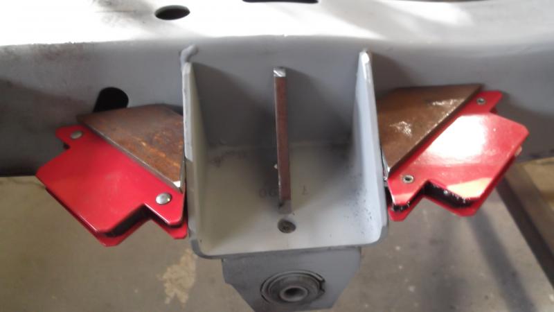

I finished 6 of the body mounts this weekend. I still have the 2 on the rear cross membber to do when I get it replaced. I shot them with primer to see how much more blending work they need. I think I'm close.
I also got the 3rd coat of jd muffler black paint on my stan's headers. The jd paint is a satin finish. I hope it stays on!!! I was able to "cure" it to 400 degrees, +/- hanging over the shop wood stove. I know that's no where near exhaust temp, but it's better than nothing?????
I'll get some buds over this week to flip the frame over and remove the rest of the brackets to prep for the reverse shackle kit. Also this week, I'll be ordering a set of new alcan springs. I'm thinking somewhere in the 2.5 to 3" lift range. Any thoughts on spring lift??
