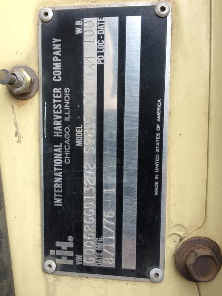

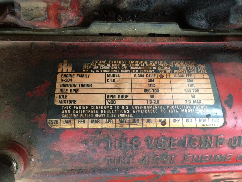

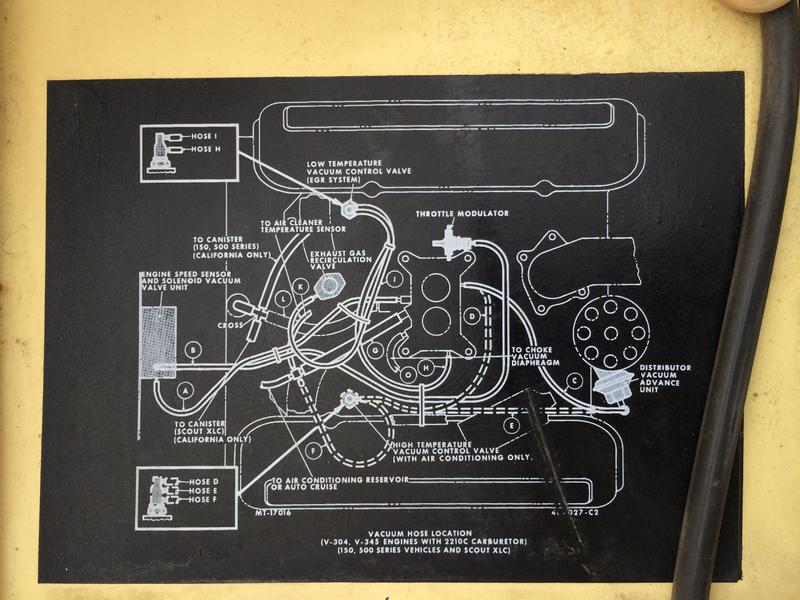

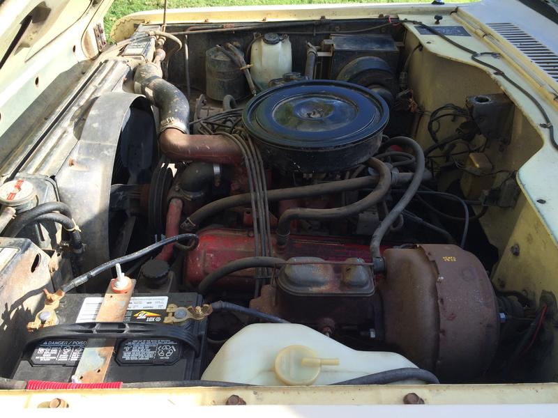

So…I spent the next few days doing my own research. Here’s what I know about my ’77: first off, it is a ’77, and not a ’76. The vin starts with a “g,” I have the original 1977 owner’s manual, and my dmv registration is for a 1977. The vin plate indicates a manufacture date of 8/11/76, and vin #g0062ggd13292. The sticker on the valve cover indicates v-304 calif., August 1976. And most importantly, the vacuum diagram does not show an air injection pump. I am confident that the vehicle is completely stock (I.e., pump was never removed, and sticker was not replaced). There is absolutely no evidence of an air pump having ever been installed.

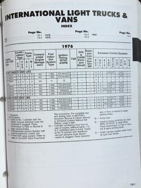

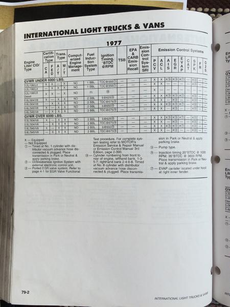

After doing my research, I went to another smog shop. The guy was really helpful. Unfortunately, he came up with the same thing as the prior shop, but he was cool enough to allow me to look at his book with him, and even take photos of the ’76 page versus the ’77 page.
So here’s my quandary now: I have a completely stock, unmolested 1977 Scout, yet I’m unable to smog it because it is allegedly “missing” the smog pump, even though it was clearly never equipped with one in the first place. The smog shops don’t care what my vacuum diagram shows; they’re relying on their book.
Here’s my theory: my Scout was built in August of ’76, meaning that it was likely one of the first 1977 “model years” off the line. I’m speculating that they built it like a ’76, but sold it as a ’77, and now almost forty years later, I’m paying the price.

*photos of the engine compartment, line set ticket, vacuum diagram, valve cover sticker, vin plate, and “smog book” pages are attached for reference.

What a pita. Your assumptions are probably correct. Based on the verbage contained on your emissions sticker, one could reasonably assume that the 1976 model year CA emissions standards were still in effect on that date and hadn't yet been supplanted by the 1977 standards. If only you could find out with certainty on what date the 1977 standards first went into effect, you might have something. If that date happened to fall any time after your Scout was manufactured, you might be able to convince the jackbooted smogtroopers that your early '77 model Scout, having been produced prior to the 1977 standards going into effect, was therefore subject to compliance with the prior model year emissions standards, which were still in effect on that date.
Get in touch with a local referee and have a friendly discussion with him regarding your problem. You'll need information regarding when your Scout was built and sold. A LST ect will May/help. You can reference the engine number and vin linked by the LST to determine authenticity of your Scout.

Thanks for the feedback guys, I appreciate it. Looking at the sticker on the valve cover, I think it's pretty clear that the vehicle was built to meet '76 emissions standards, despite being a '77 model. Hopefully the referee can exercise enough discretion to deem this as being acceptable and compliant. I'll gather my documents and make an appointment.
