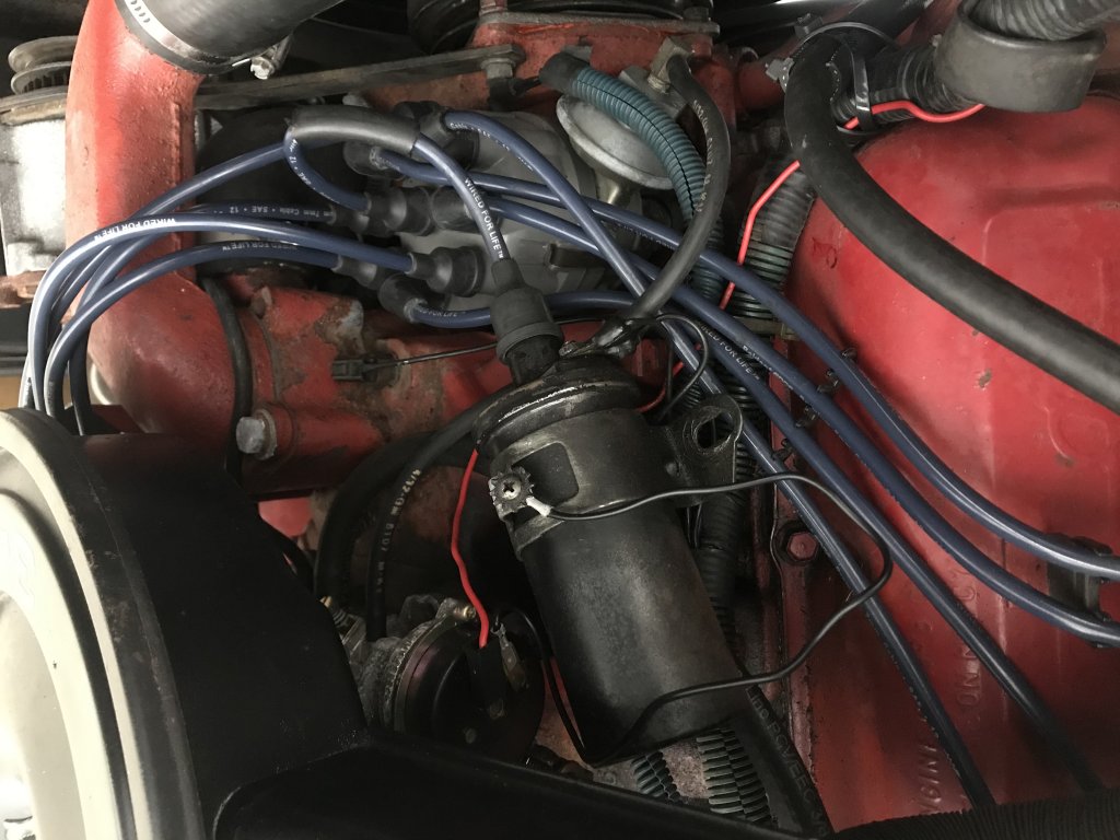

In process of changing plug wires. Also will replace coil. My question is about proper coil. Can I use a Pertronix 40011 Flamethrower, 1.5 ohm?

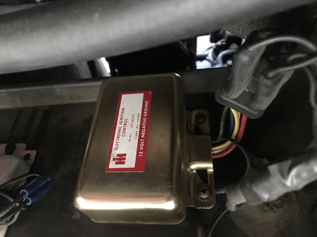

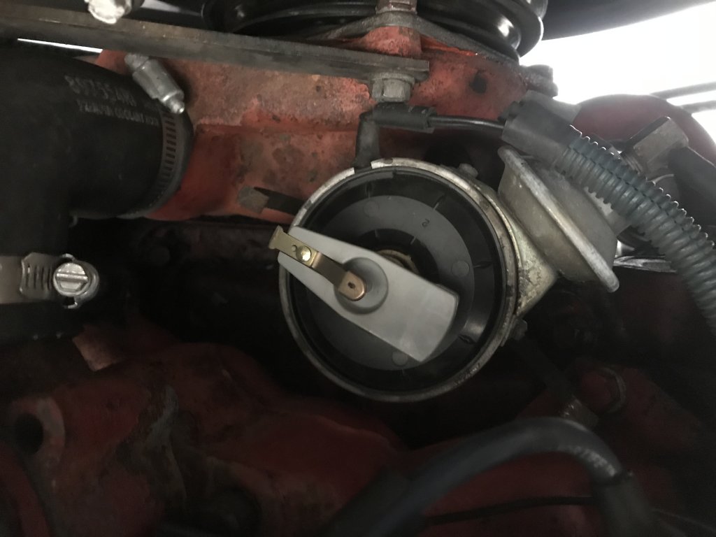

I have IH gold box ignition control. IH # 451565C2. See photo. Dist is a Duralast, maybe?? Or just the cap was replaced. Dunno for sure. Has no markings on it except Made in Mexico. See photos.
Existing coil has no markings. Ohms ok at 1.5.
Need to confirm if the P-tronix is a straight install given the Gold Box and Dist. Specifically, is resistor something I need to sort? I measured Key On ~10 volts at coil while using a jumper to ground. Battery has normal 12.3 V.
When I remove jumper voltage goes to 6V.
Does the 10 volts denote existence of resisitor? If so where, I don’t see anything. Is that internal to gold box?
Or am I overthinking this? Open to other options.....

For now I just want to replace the really old coil, keep same dist set and gold box.
The 10 volt thing has me wondering tho if new Ptron coil will be ok. If Flamethrower (with its built-in resistor) wants full 12v, is 10v enough to satisfy Pertronix’s spec for “approx 12v”? Does that 10v indicate/confirm existence of a resistor somewhere? I cannot find it if so.
Thanks guys. Question answered. Pertronix said ok to plug & play. Confirming same info from int77345.
I think the 10v I saw was via measuring across the coil while all leads connected. I pulled + wires from coil, checked voltage again, and see I have the full (and required) >12v direct TO the coil. My existing coil has internal resistor. My hunch is the responding Pertronix Tech knew that and simply confirmed I can plug/play the new base Flamethrower coil into my Holley electronics. Guess that would be aka Flamethrower I.
** In the meantime I also read thru a number of Ignition forums and rediscovered the history of the old 72” resistor wire once used in early versions of Circuit 16. I can’t find any evidence this wire is in place. If it is, it’s not terminated and is out of service.
I was determined to understand why I was seeing the 10v. I feel better now. All good. :)
The resistor wire should have been long gone by 1977 model year. The Holley gold box setup is period correct for approximately '75 through '77 Scouts. If the stock coil is still producing a spark, then there's nothing wrong with it. It could at least be retained as an emergency spare if nothing else.

long shot to, but you had your distributor cap off. did you get it back on perfectly ? and is it tight ? when i dont get mine on just perfect i get a little miss to. some times a big one.
Ummm.....pretty sure. I’ll double check cap. Am also keeping eye on the new dist wire boots (all 90*), tite fit and watching to assure one doesn’t slip its way loose. Gonna replace a few with 180* terms to address that. Stutter was there before new wires. Think I got a virus :)

All better now, purring like kitten. Dist cap was ok. I re-seated new plug wires on cap, must have been one not clipped-in well. Happy.
