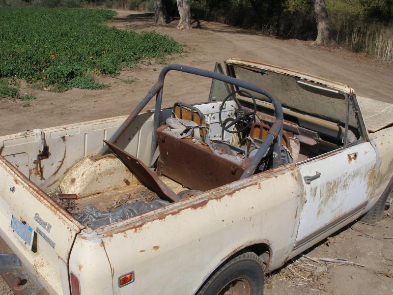

Hello all!
Assuming I am doing this right, the attached picture is of a 1974 Scout II that I am "inheriting" from my old man.
I need a "country gun truck" in order to take my son out shooting when he is old enough. (he is not yet two, wife says he can learn to shoot at eight, so I have six years to get this done).
This vehicle was a project purchased but never followed through on by my old man. I am hoping to realize those same dreams except within the next six years.
It looks a little rough, though everything is supposed to be there, just needs tlc and some replacement parts.
The details (as I know them) are: 196 ci. And the single photo you have attached here.
Any input on this restoration (or maybe only rehabilitation) is much appreciated.
Specifically, I know (from my uncle) that the hood is basically a rust festival that will require replacement. Short of that, no one has run it in at least 8 years.
Thoughts on likely trouble areas, and potential fixes will be much obliged!
Thanks in advance.
Cbathe15

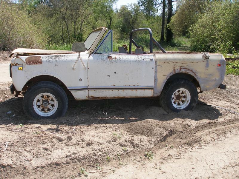

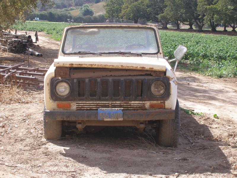

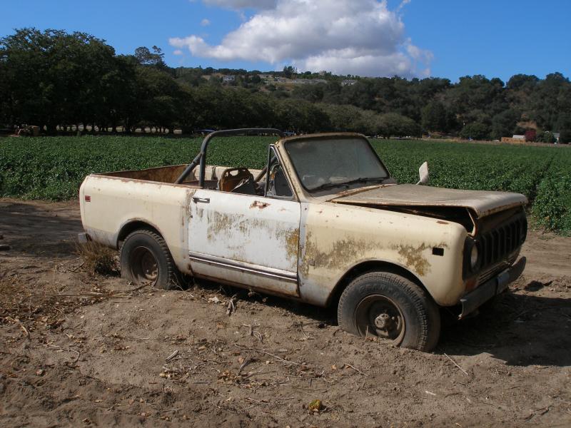

New pics that came in today. Looks like im in the hunt for some seats as well as a driver's side front quarter panel and a driver's side headlight.
Anyone have any info (or know of a previous thread) re replacement headlights?

Worry about getting it running first. The fuel tank is probably full of water and rust if it's been sitting with no gas cap. Make sure the engine isn't seized.
Where are you located? I have my old seats out of my 73... They were out of a mitsubishi eclipse, and I had the seat bases cut down to fit the tilt of the seats. I just put some corbeaus on a custom seat bar mounted to my cage, so I dont need these any more.
A little rough? I'd say its a lot rough. I'm not trying to hurt your feelings, just so you know. I also don't know how common scouts are in your region, but from what I can see in the pics, and considering it hasn't been run/driven in quite some time, that Scout would honestly make a better parts donor than a builder platform. You're looking at big bucks to get this thing to where it is a reasonable daily driver. The interior is pretty much toast from dash to tailgate. I see quite a bit of surface rust, and no doubt some of it has progressed to body rot. We don't have the first clue what condition the entire drive train package is in, but at minimum it will all require at least some freshening up. I see this project gradually deteriorating to the point where first your son loses interest, then you lose it too. Six years would be plenty of time to get it where it needs to be if you are able to be persistent, have reasonably deep pockets, access to tools, and good luck sourcing the parts you need on a regular basis. It's also plenty of time to get disgusted and discouraged with it before you even get the chance to enjoy it. I'm not saying don't do it. Just be sure you guys are going into this thing with your eyes wide open and make an honest assessment of the deal. It May seem like a good idea on paper to you right now. How about three years from now when you're still missing parts and you haven't been able to drive it yet? Young people tend to lose patience and interest in things like this pretty fast if they aren't able to enjoy a small taste of the honey every now and again to keep them enthused and focused on the big prize. Might be money and for damn sure time ahead to keep your eyes peeled for one that is a little closer to game time, while saving this one to harvest parts off of. It hasn't cost you any money yet, so it won't hurt anything to sit on it for awhile while you and the boy go on occasional "scouting missions". Just a thought. You do what you feel is right. We're here to help either way. Best of luck to you.
This looks like great project if you have a good space to tear it down and the time/patience to work it over. You'll find a ton of good resources on this site as well as a great supply of needed parts from the site host (ihonlynorth).
Also, I think if you can find the line ticket my money's on this being a converted SSII. Aside from the grill you can see the outline of the SSII door inserts around the door openings. In particular look at your scout4 picture. Ignore the donor steel that has the aluminum molding and you can see what I mean.

Not to burst your bubble, either, but I agree with scoutboy about being a lot rough. I finally had a chance to look at the other photos you posted. :yikes: as been mentioned, this will take a lot of time, didication, and lots of patience to bring it back to life. I can understand if this being a sentimental item, but, also previousely mentioned, you might be better off finding another Scout in better condition and use this 77 as a parts donor. Just some tough love on this.
This project of restification is doable. But again it will take lots of time and quadruple the money. Which ever route you decide to take, we still will be here for advice if need be. Best of luck
