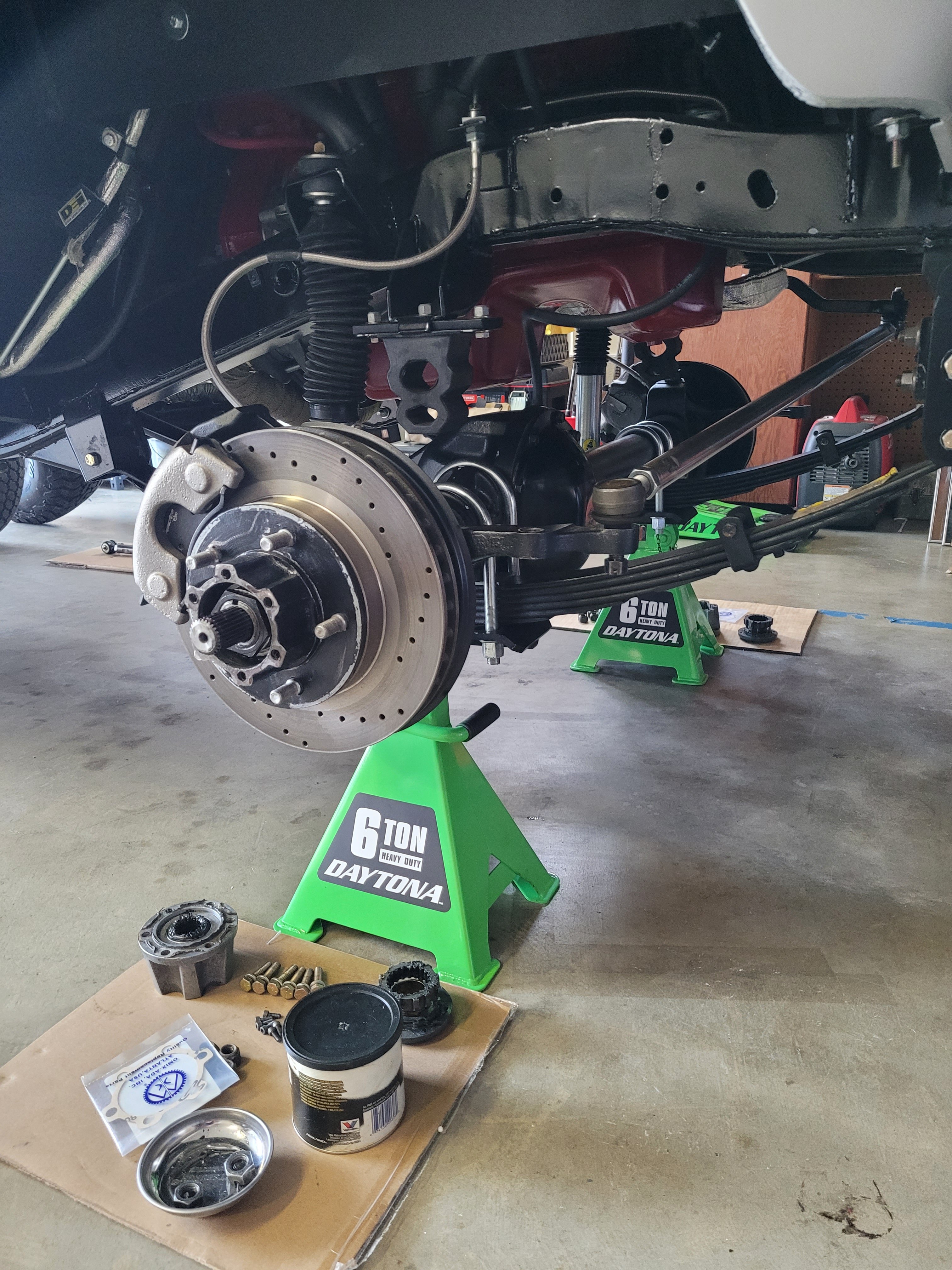

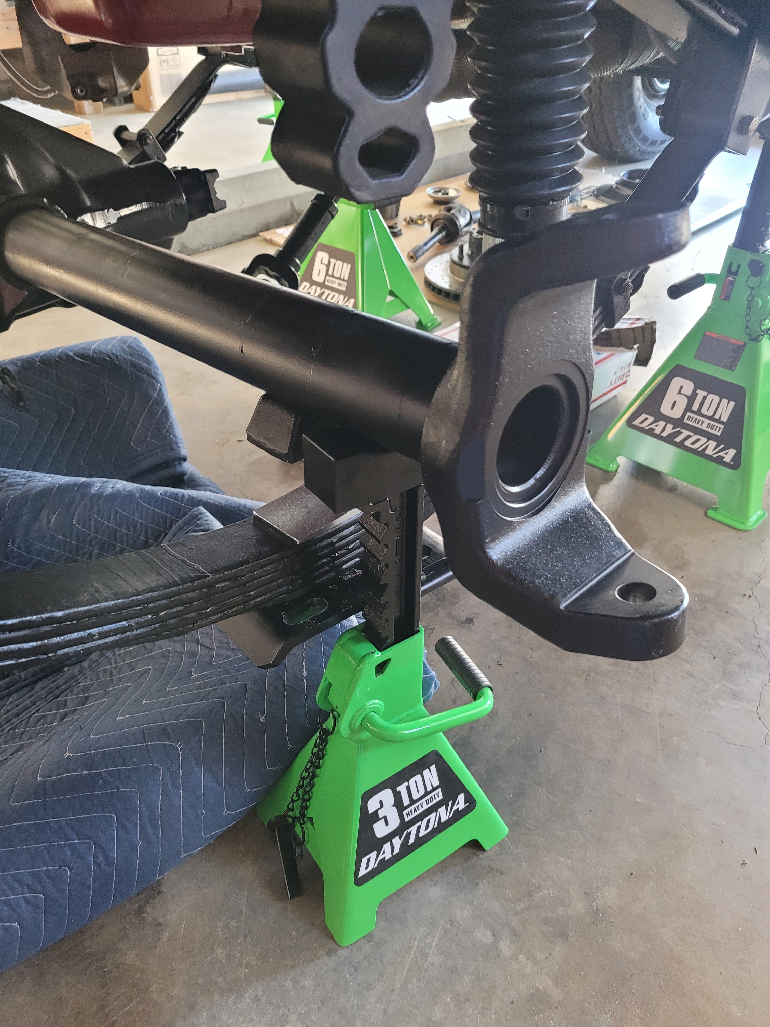

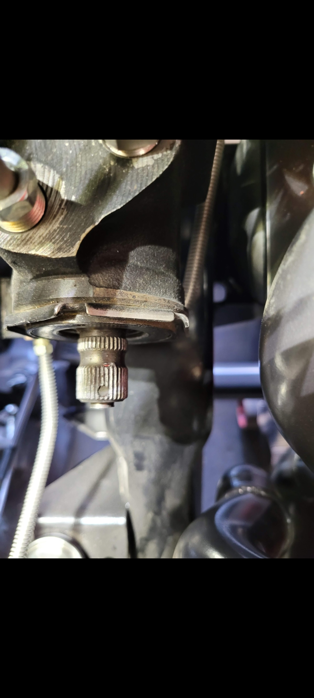

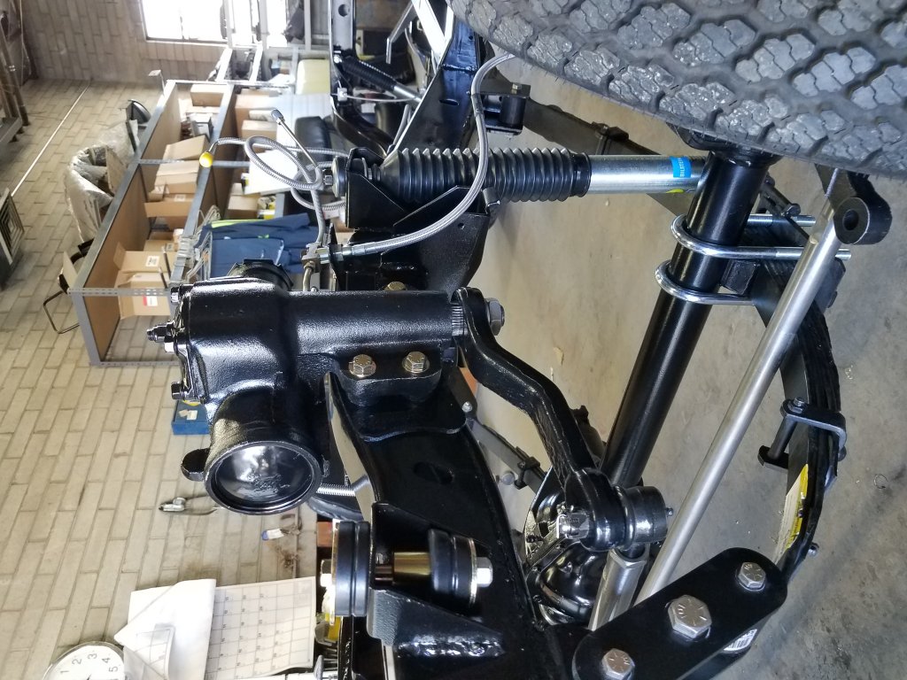

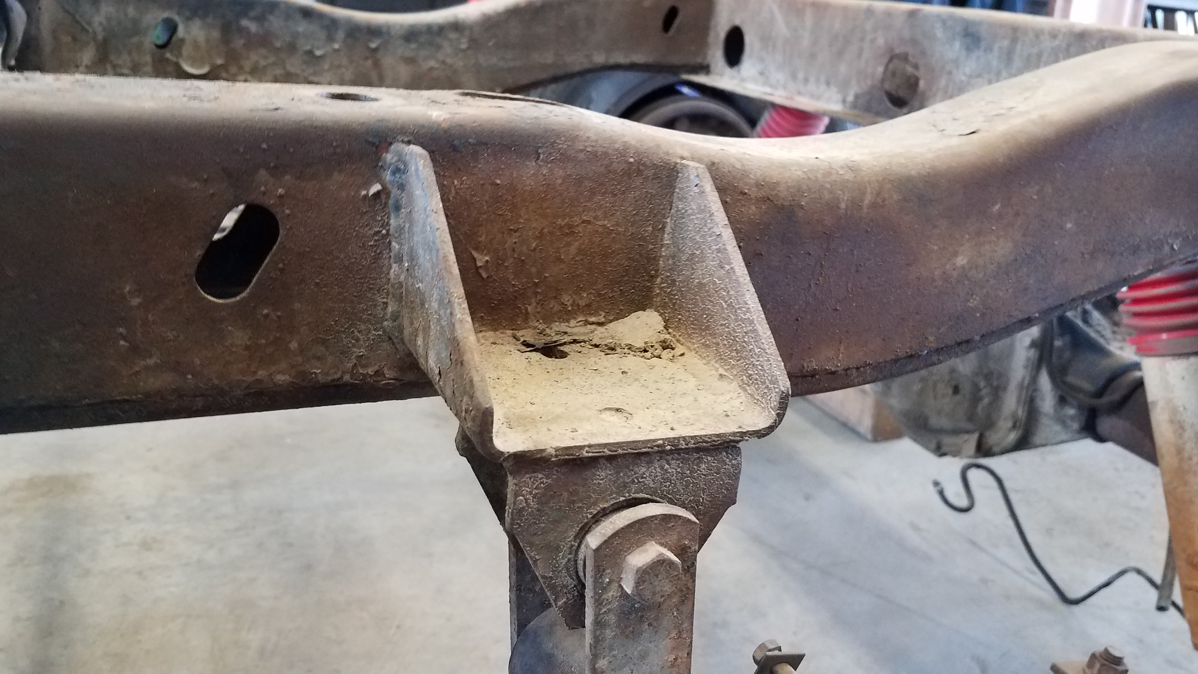

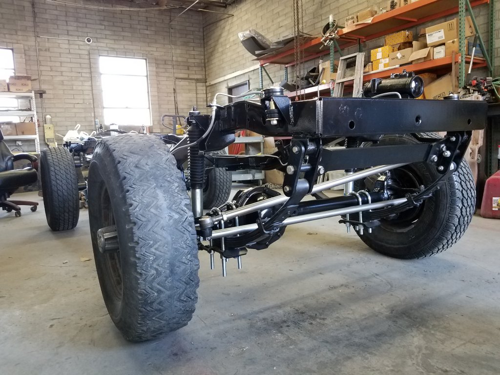

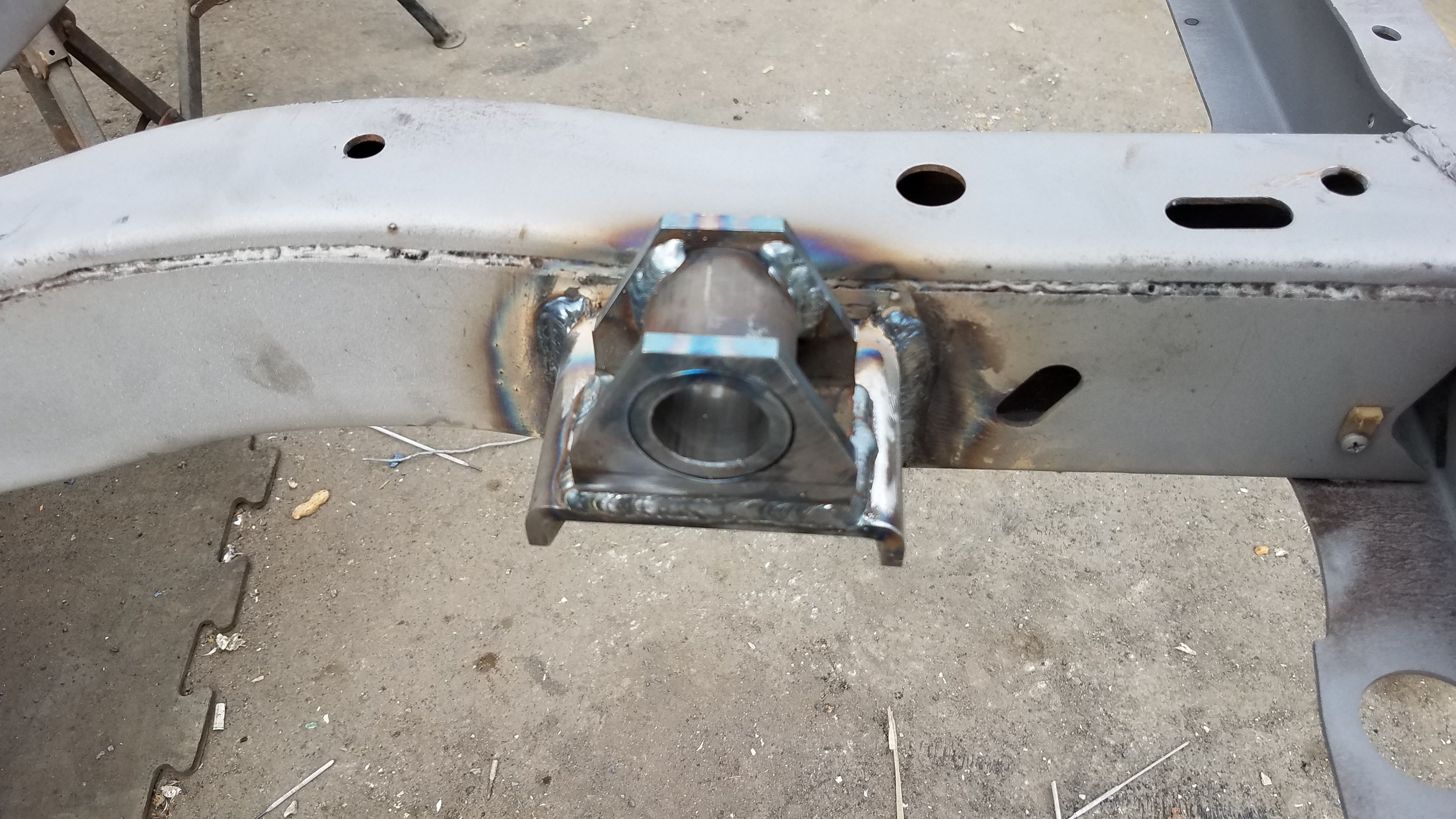

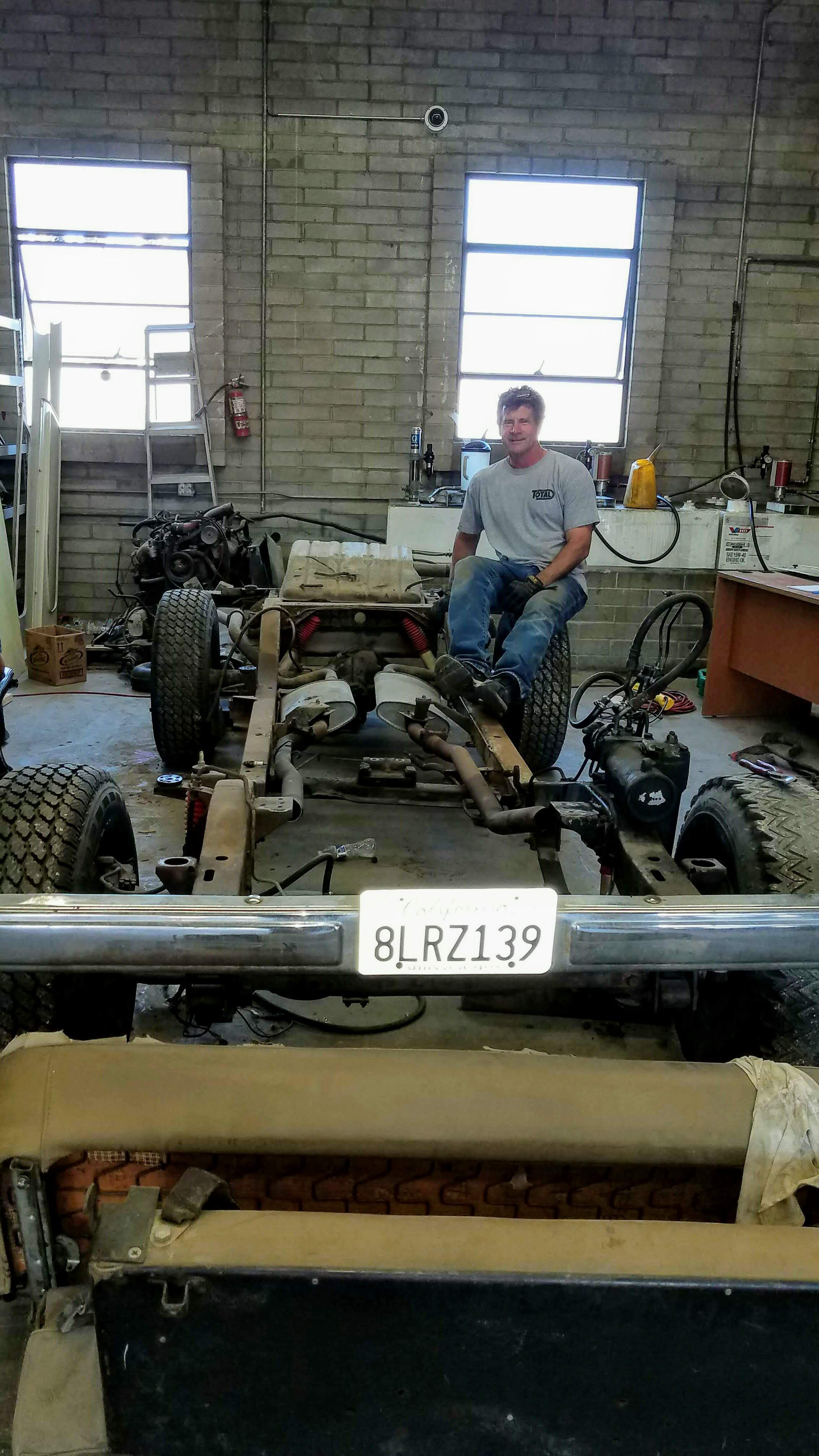

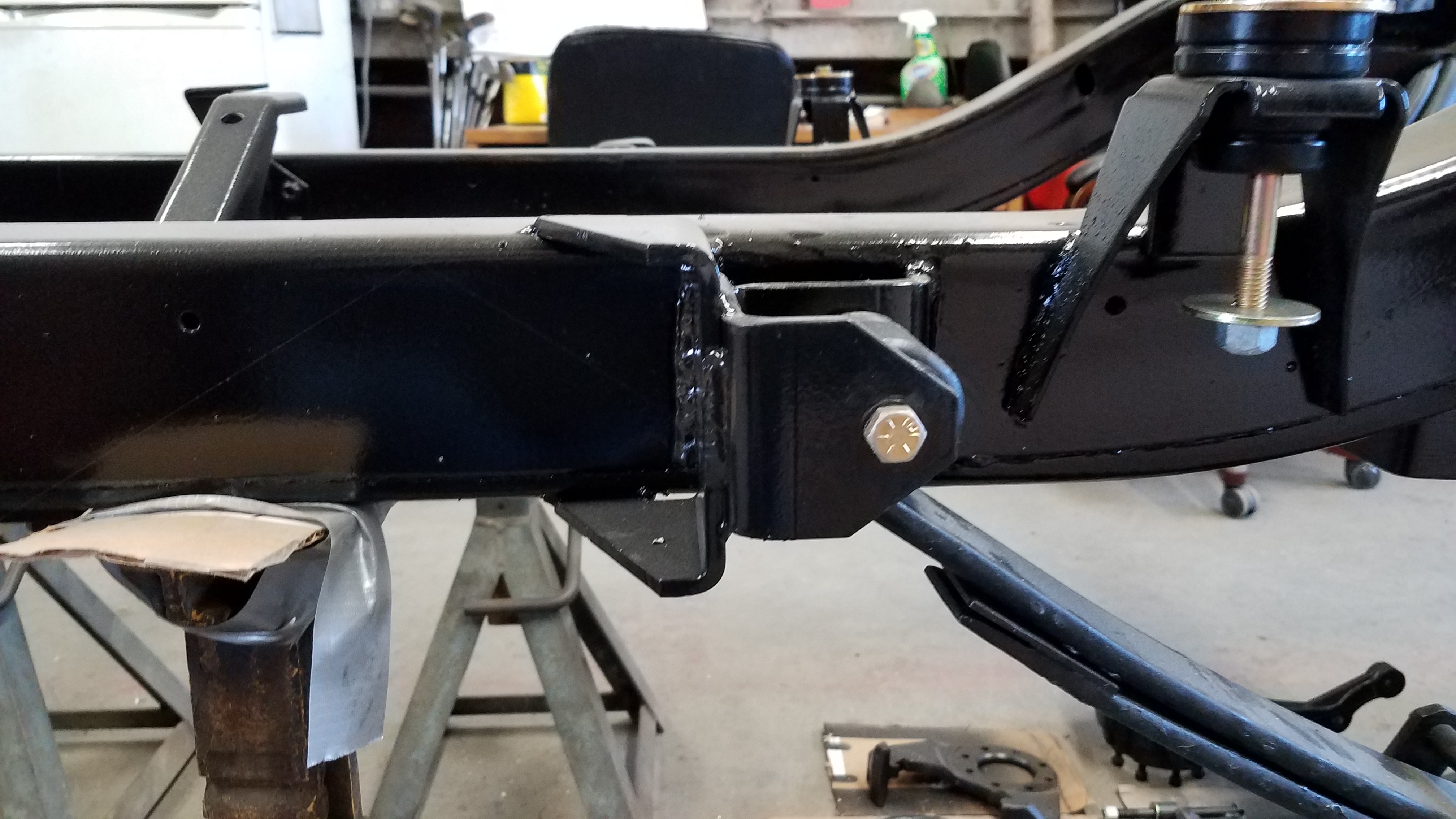

Unfortunately I did not know that was going to be an issue when it came to installing the Borgeson Joints. I thought it would have been a simple bolt on application. The power steering gear was rebuilt prior to re-installing the steering column and the Borgeson Joints. From the picture I included on the last post. Did I leave enough of a nub? Do I need to have the steering gear rebuilt/re-adjusted. Should I purchase a replacement steering gear from a reputable source? What would be your suggestion? Thank you for the advise.
I've recently retired and I'm looking forward to getting this on the road. After the steering is 100% satisfactory its off to get the AC system charged then minor body work finished and painted.
Unfortunately I did not know that was going to be an issue when it came to installing the Borgeson Joints. I thought it would have been a simple bolt on application. The power steering gear was rebuilt prior to re-installing the steering column and the Borgeson Joints. From the picture I included on the last post. Did I leave enough of a nub? Also I loosened the lock nut to adjust the set screw. Do I need to have the steering gear rebuilt/re-adjusted. Should I purchase a replacement steering gear from a reputable source? What would be your suggestion? Thank you for the advise.

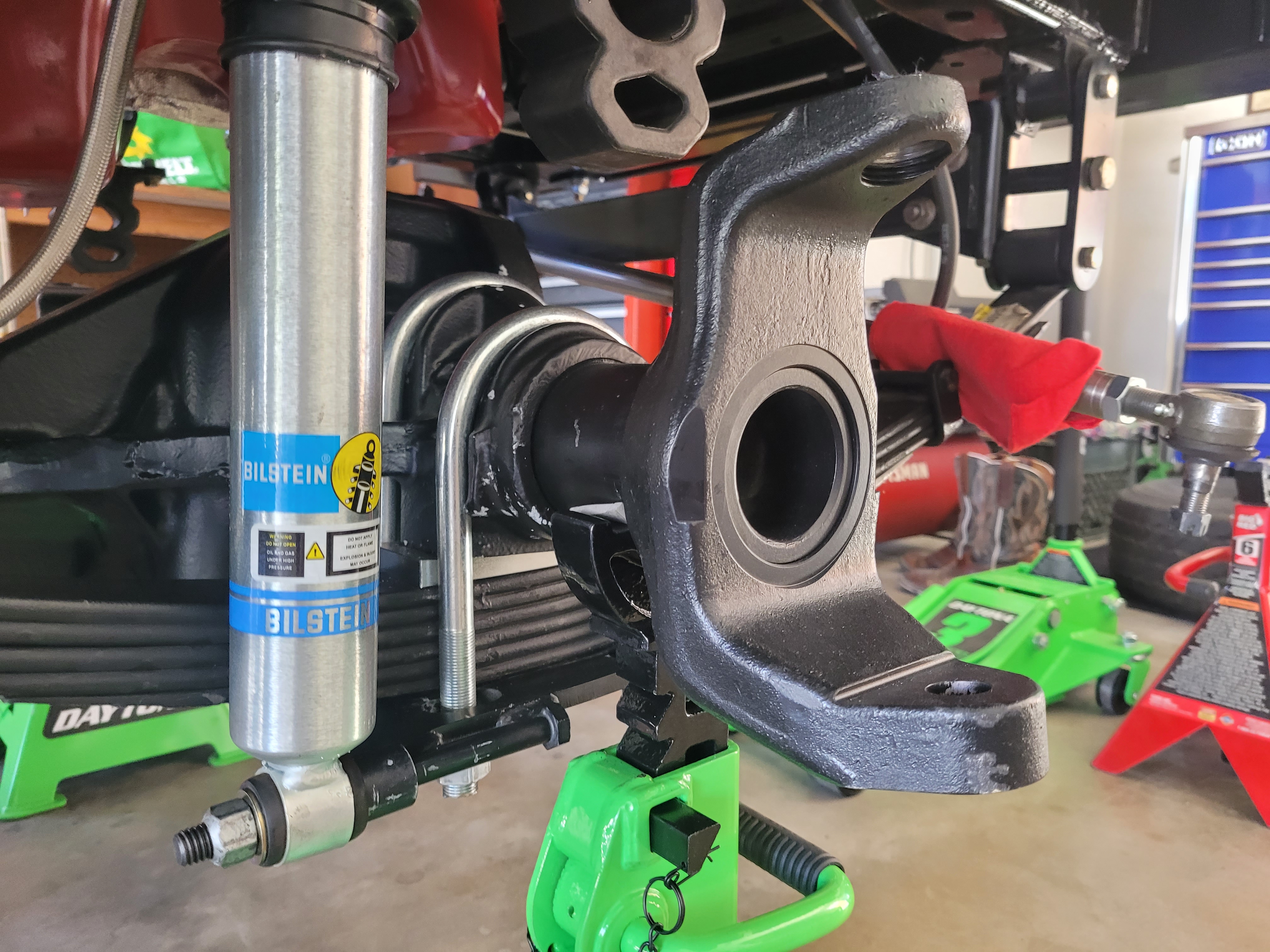

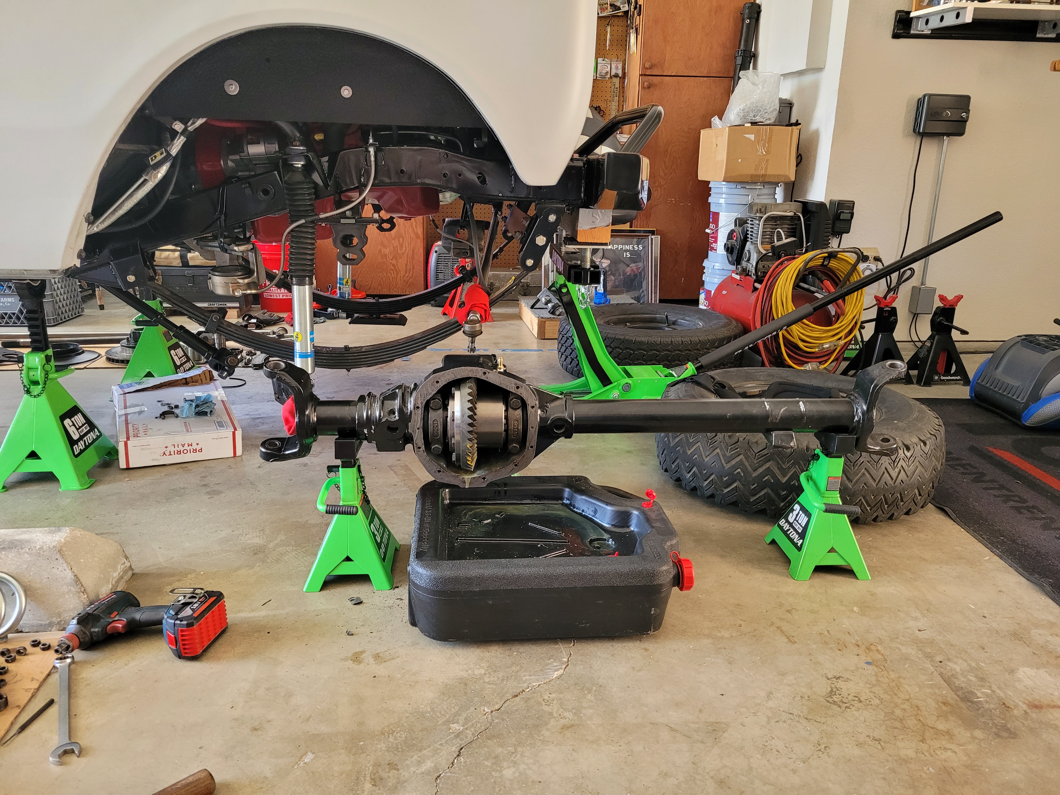

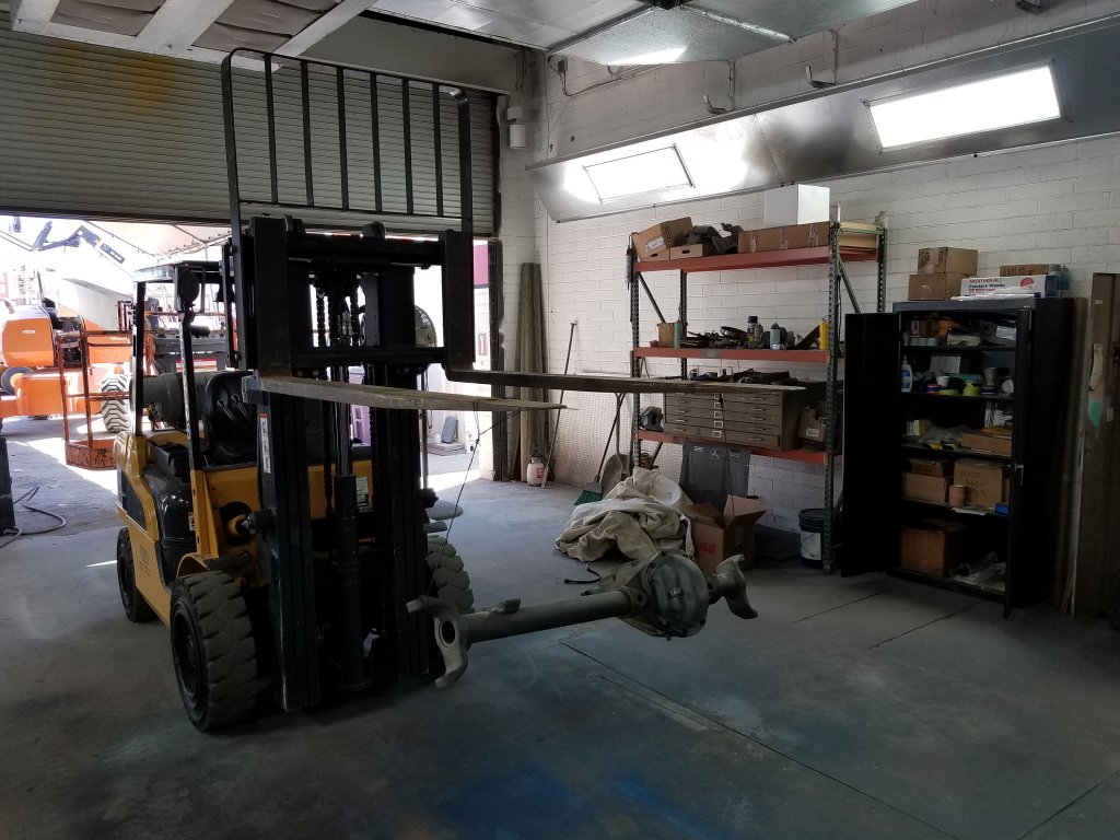

Winchested, the springs were attached before the cut and turn. I was in a crunch for time to get the Scout off my prior owners business. The business was going to be sold sooner than expected. I could not find any one local to do it. After getting the Scout running and driving, it was wondering left and right approaching 30 mph. I pulled the front axle out and took to IHPA for the cut and turn. I explained to them the suspension that was on it. After installing the front axle after the cut and turn it drove 95% better. It only gets a little squirrelly on bumpy roads. I will have to get a angle finder and do what you suggested to see where the caster is actually at. Thanks for the advice.

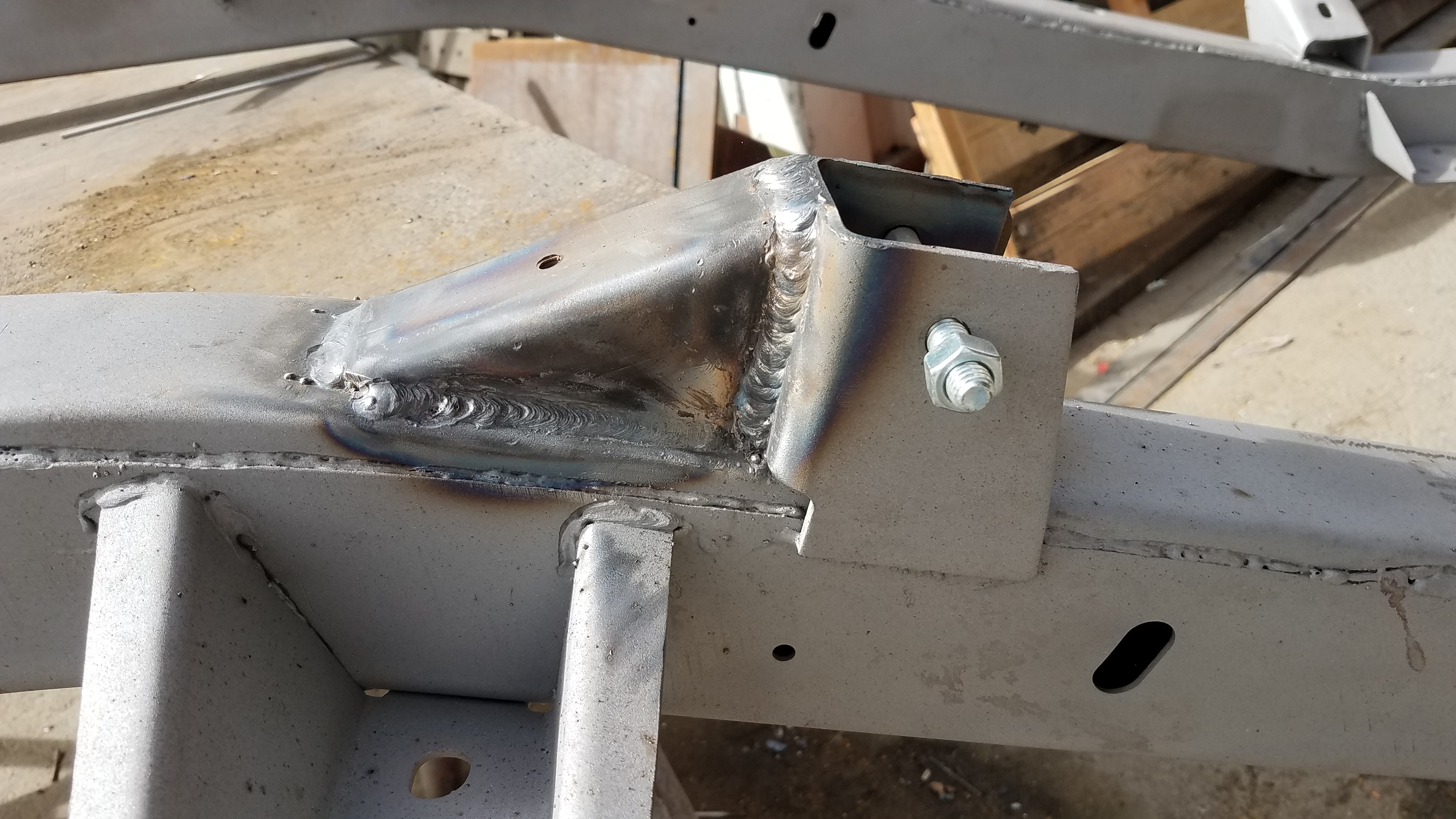

Hi Zaedster, thanks for the reply. I did have the steering gear rebuilt. Was it the best shop in the LA area, I'm not sure. They did mark the setting with a white marker and I can adjust it back. To me the steering wheel had to much play and seems to be better now. When I installed the Borgeson Joints I did have an issue making it fit with that nub sticking out. I can't remember if I discussed this on the phone with IHPA or thru the forum. I was advised to cut that knub off to make the joints fit. There's a picture attached of my cut on the nub. On smooth roads it drives great one hand on the wheel. It's only the bumpy roads that make me uncomfortable.

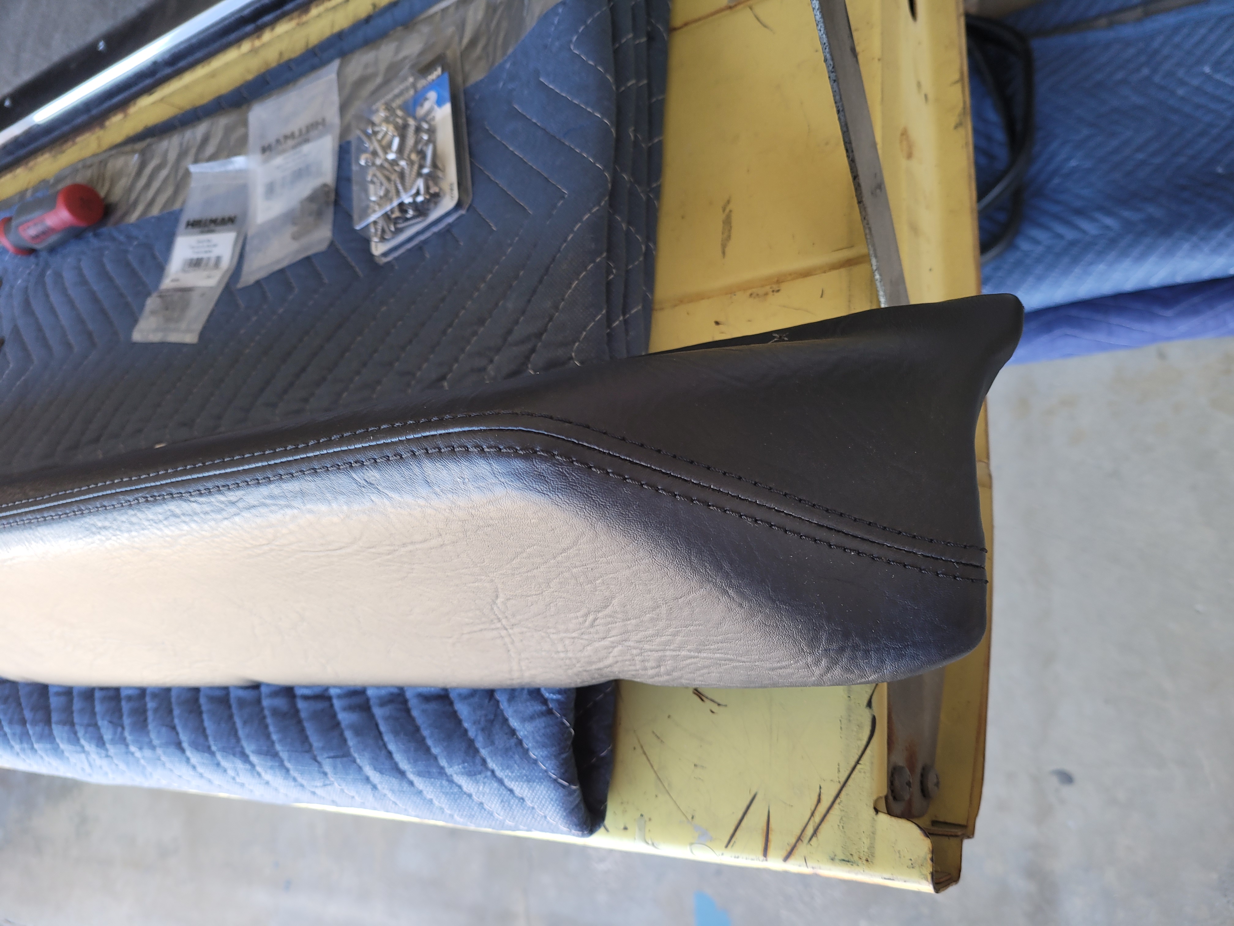

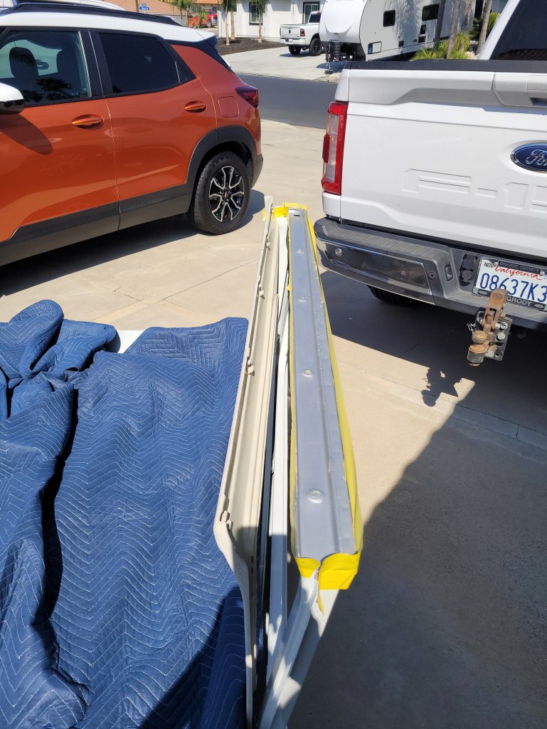

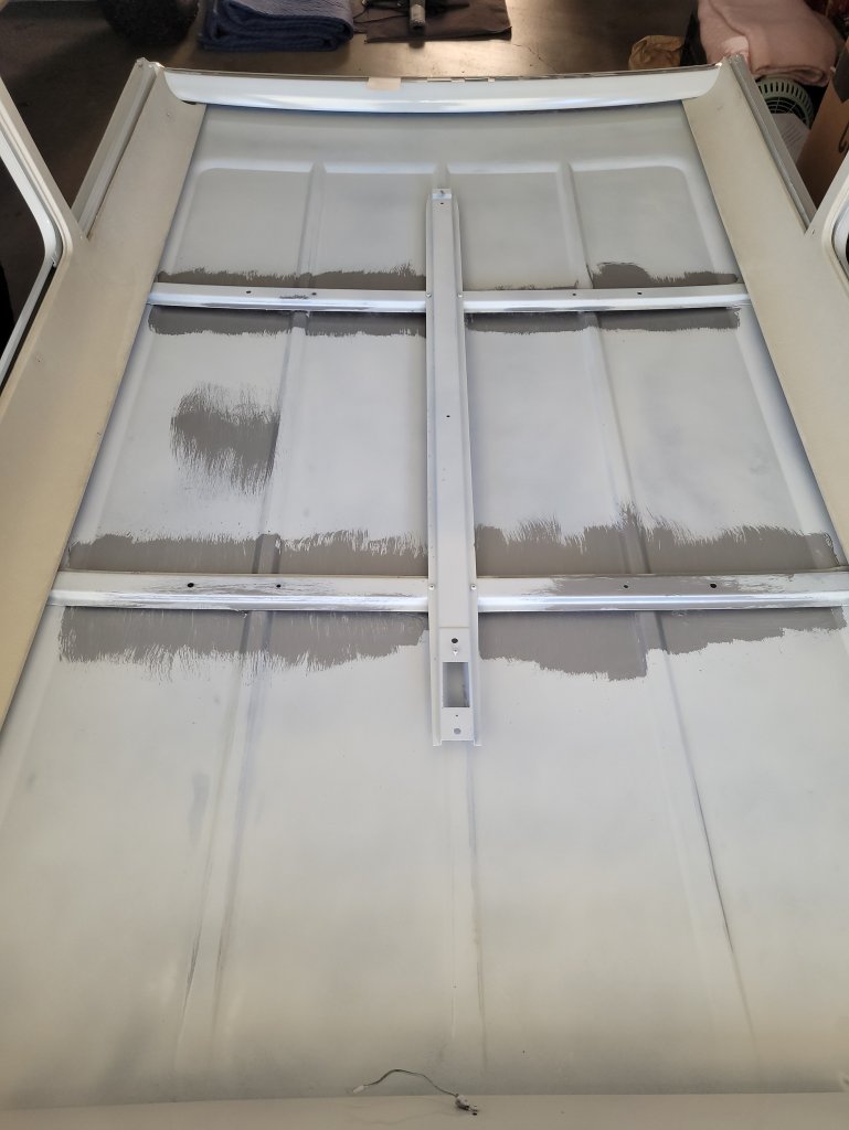

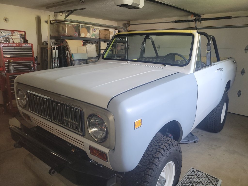

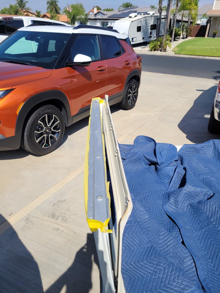

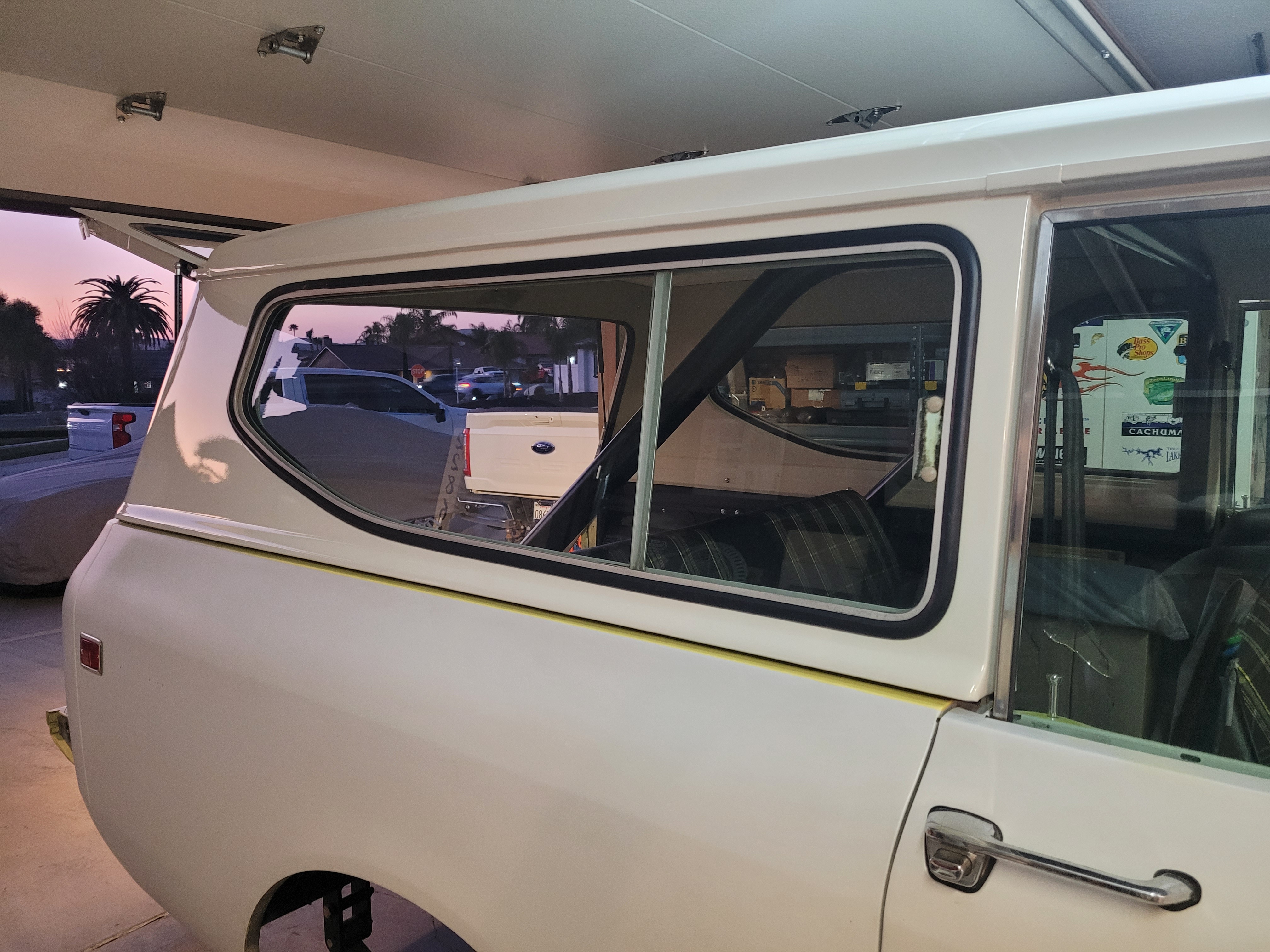

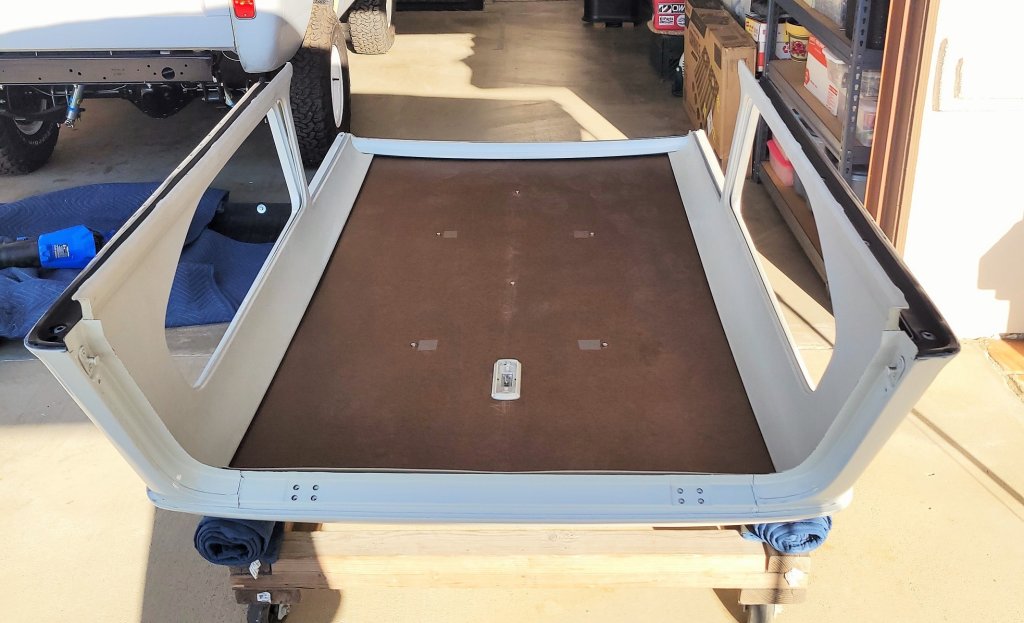

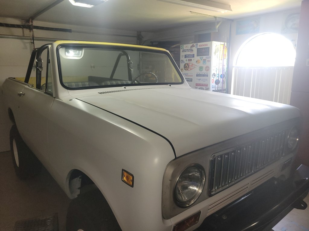

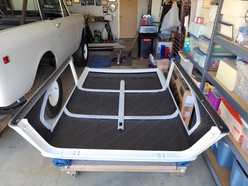

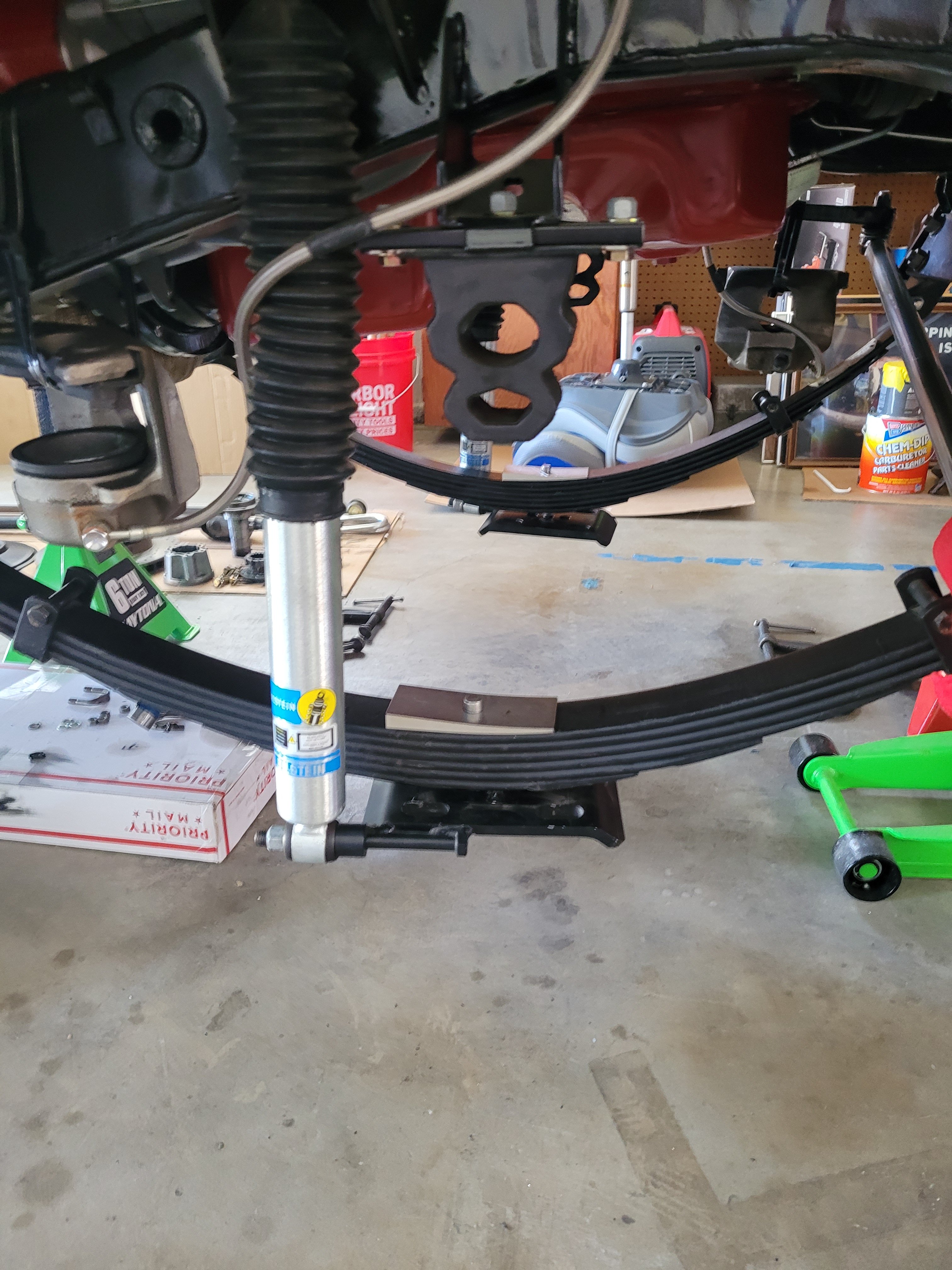

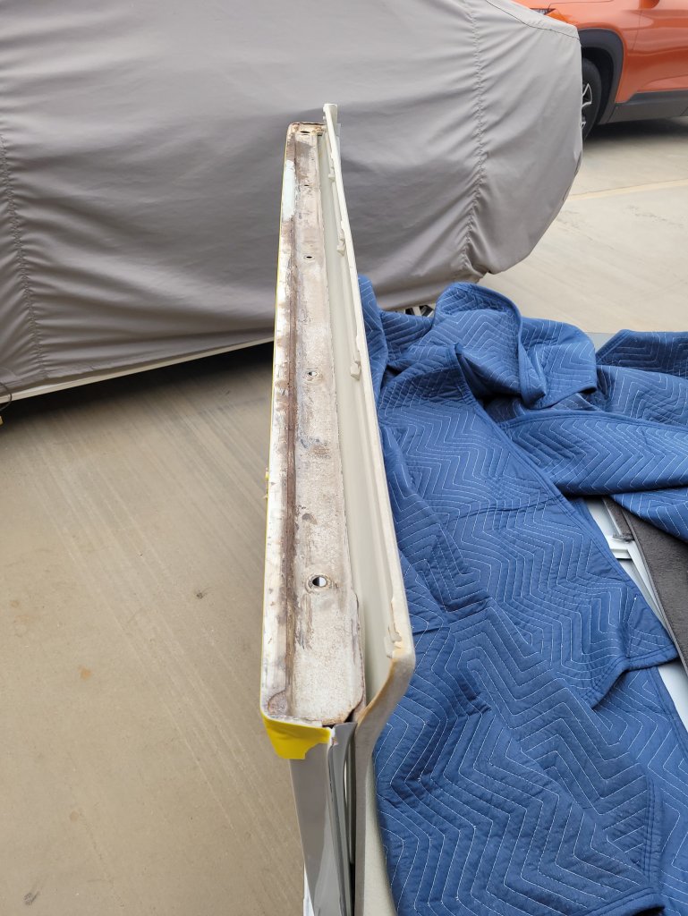

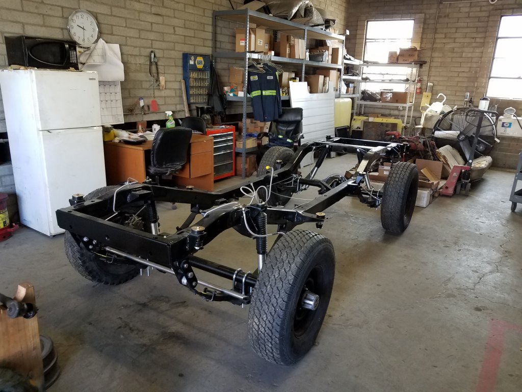

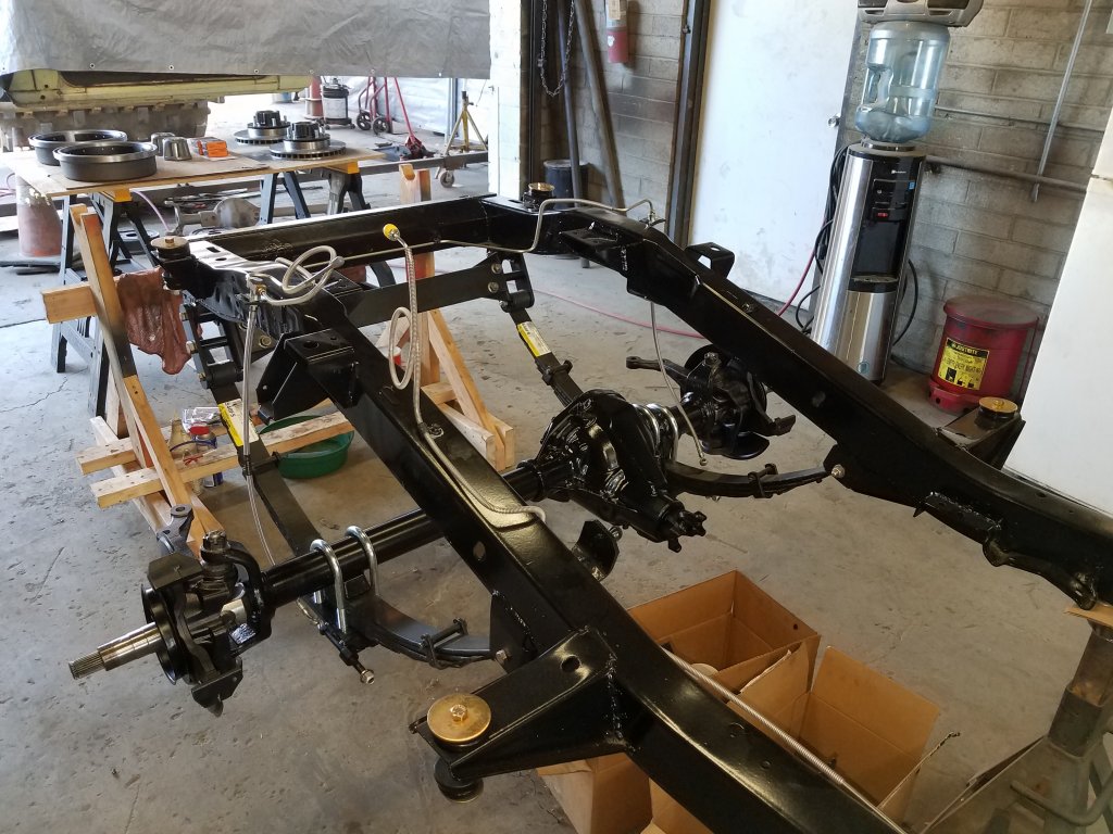

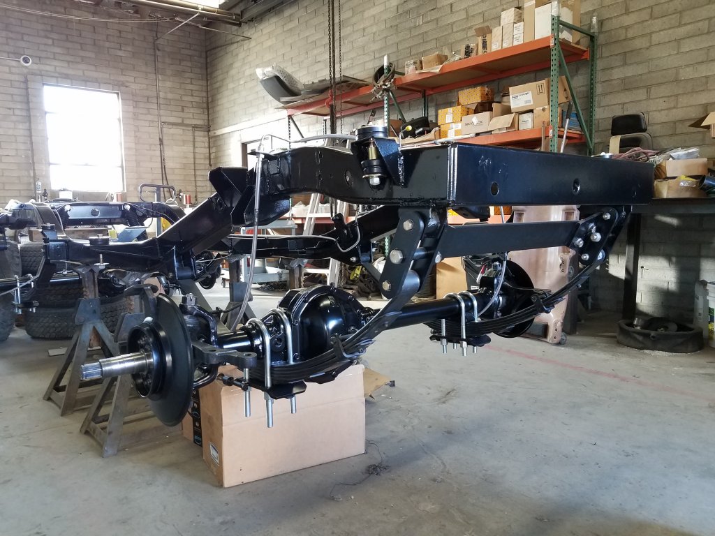

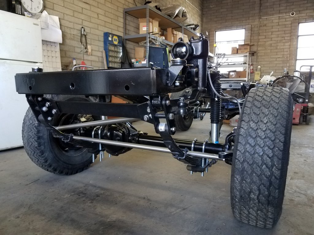

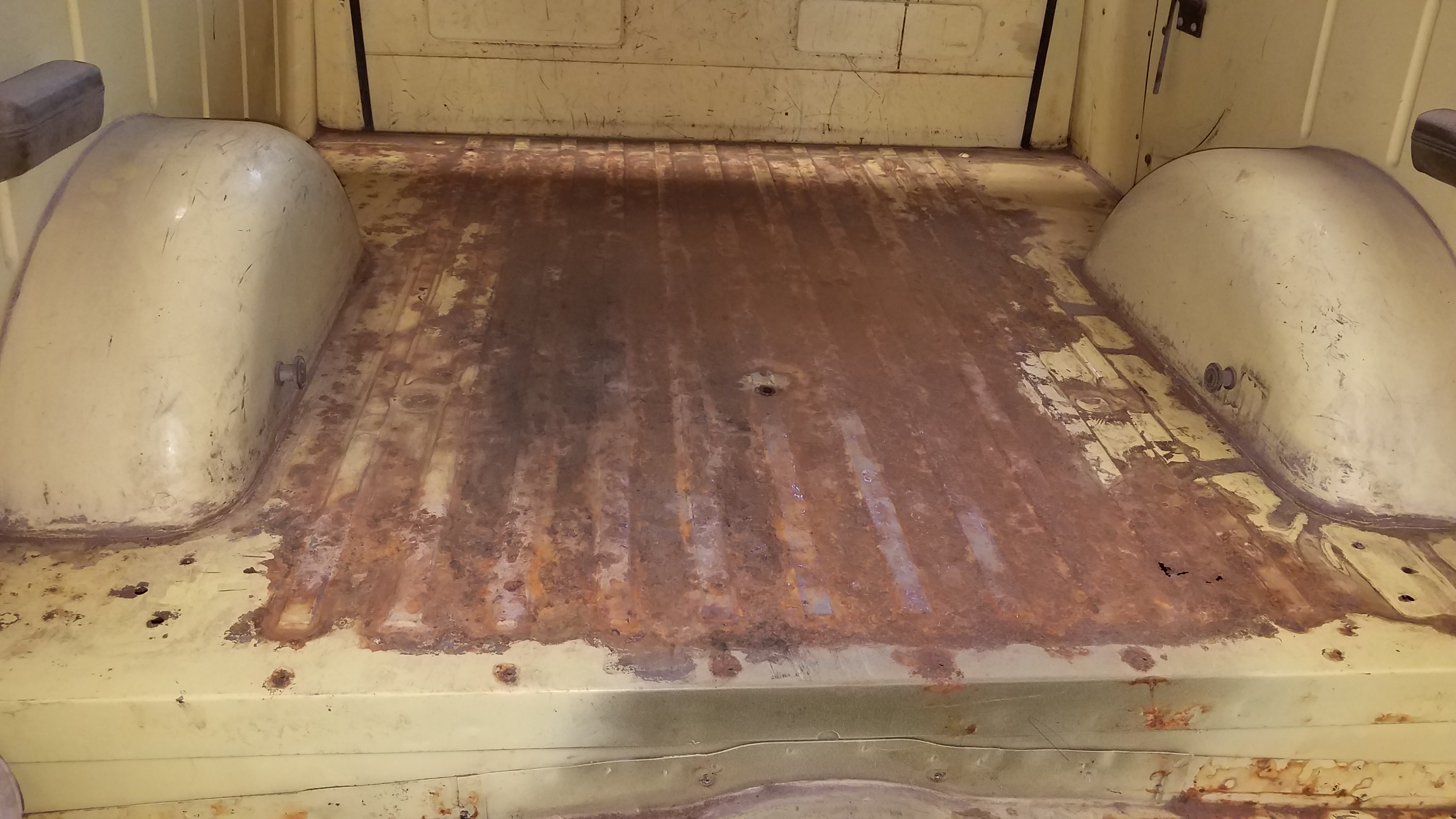

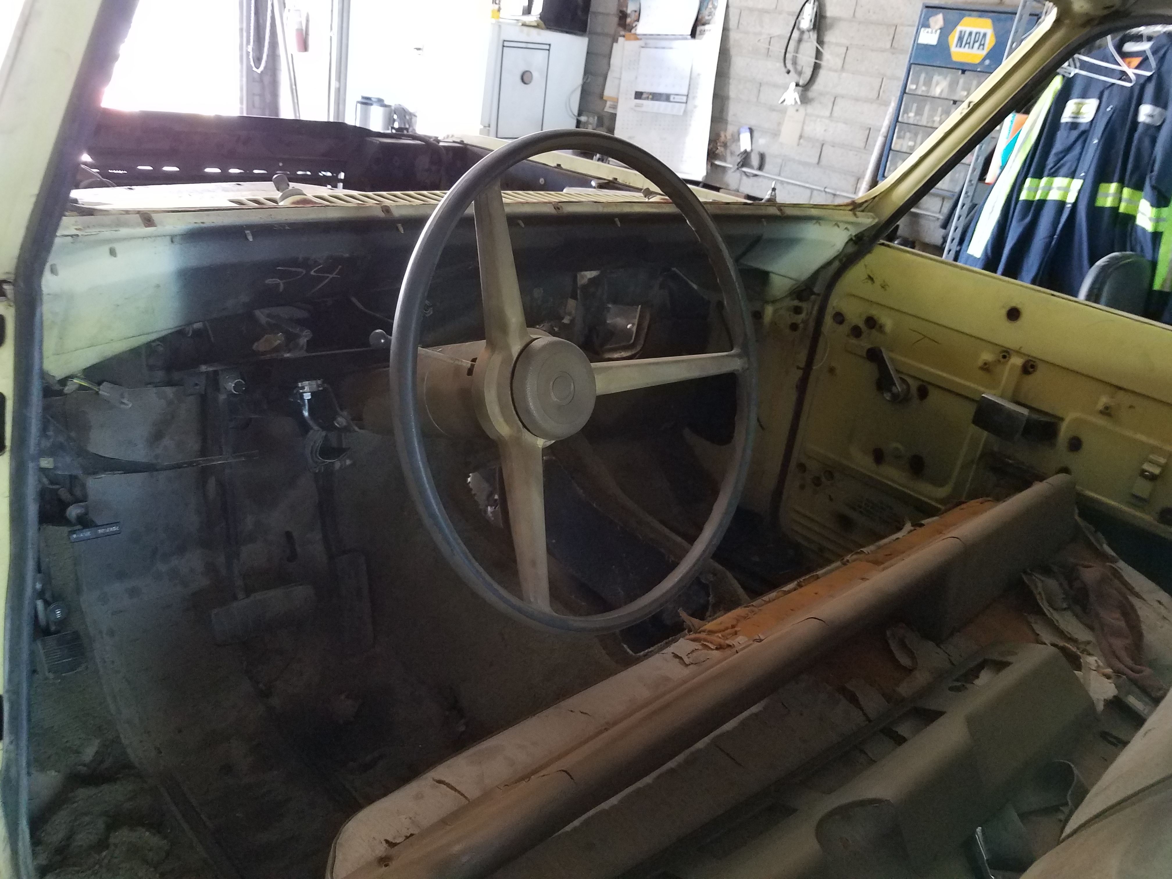

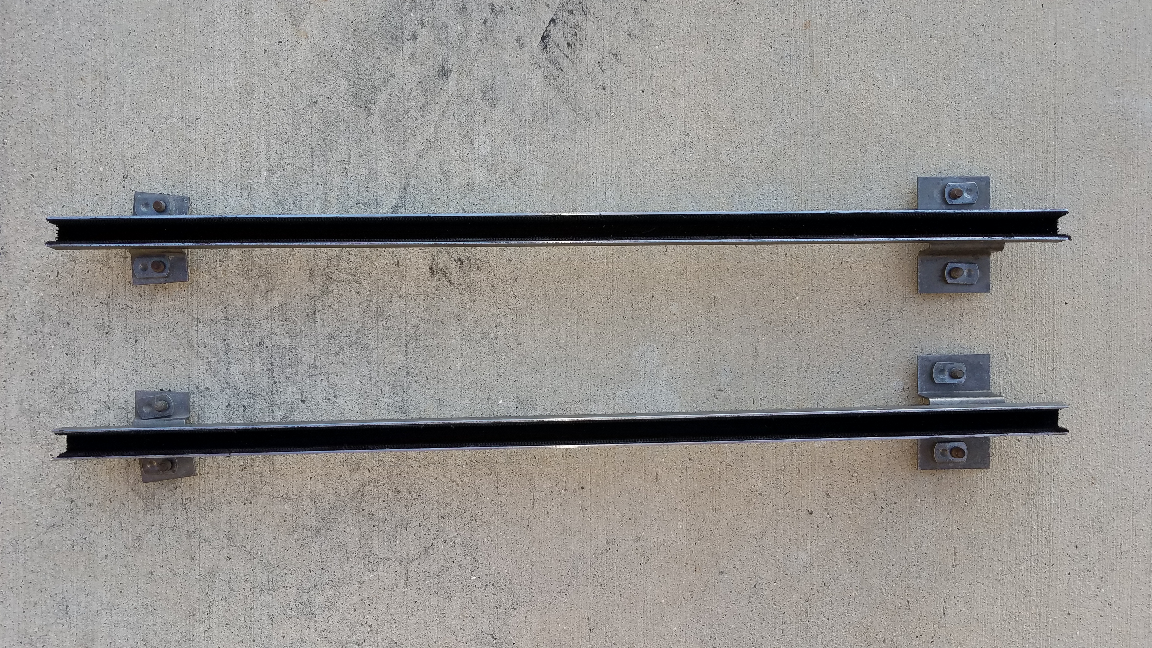

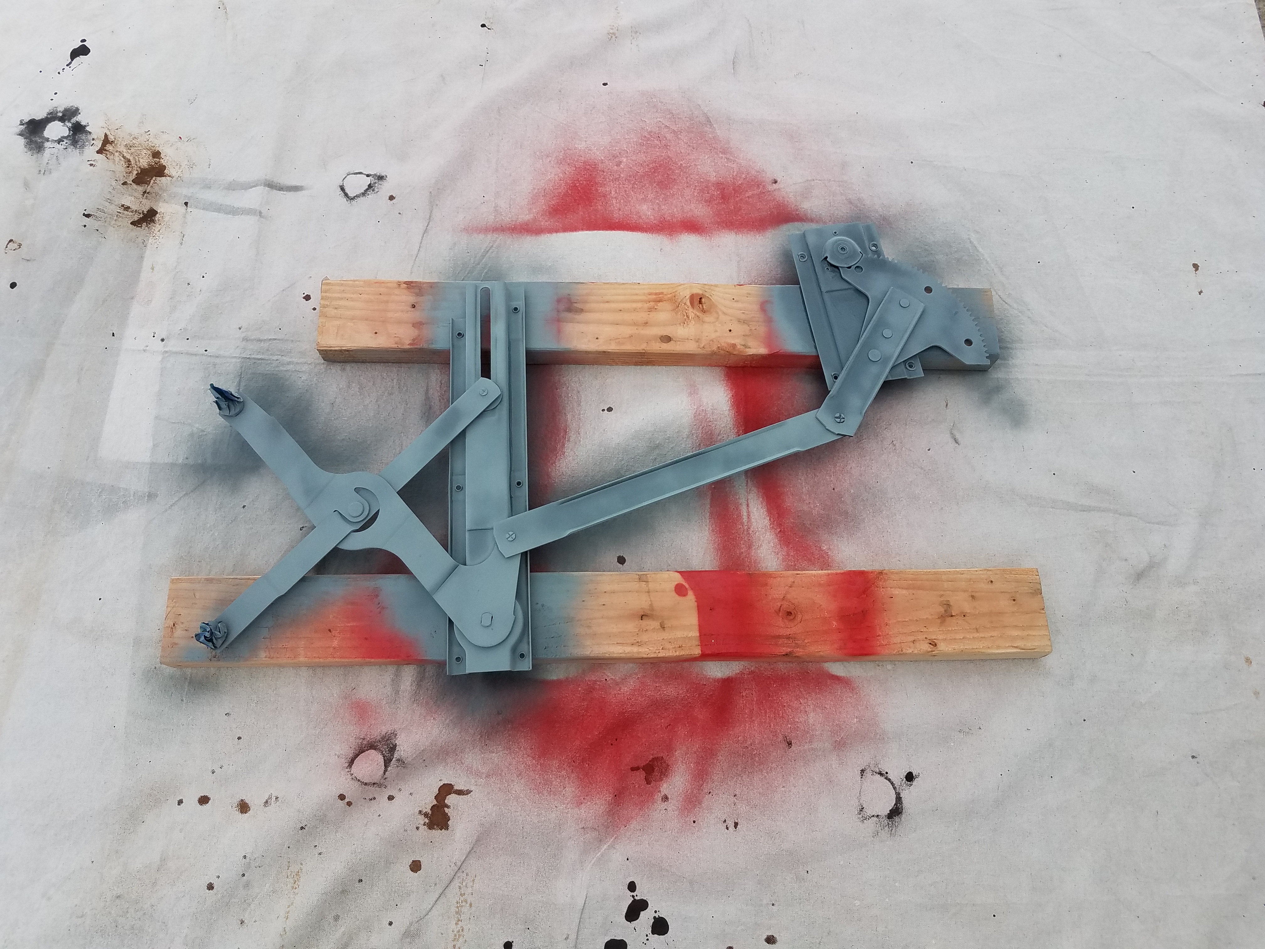

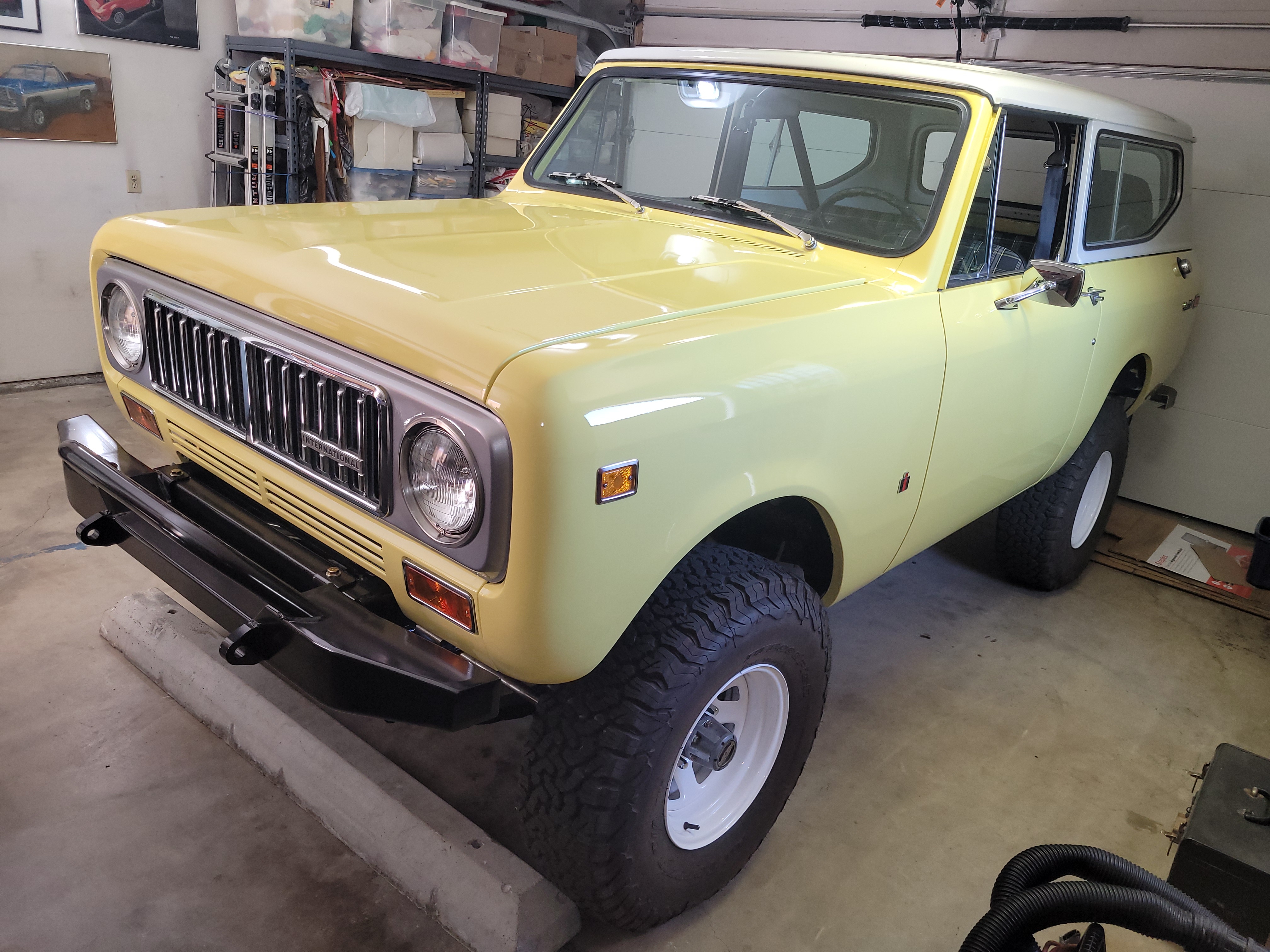

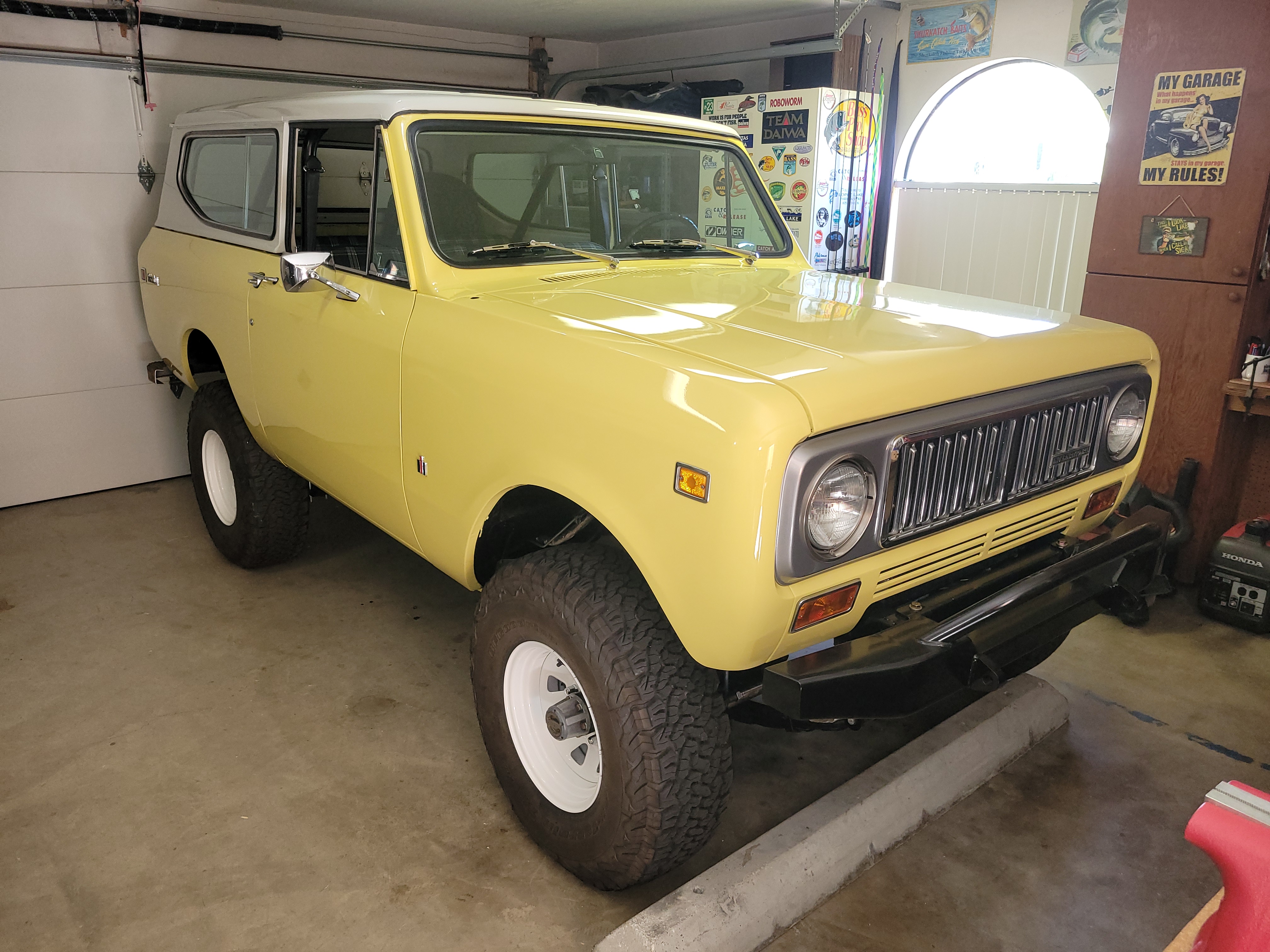

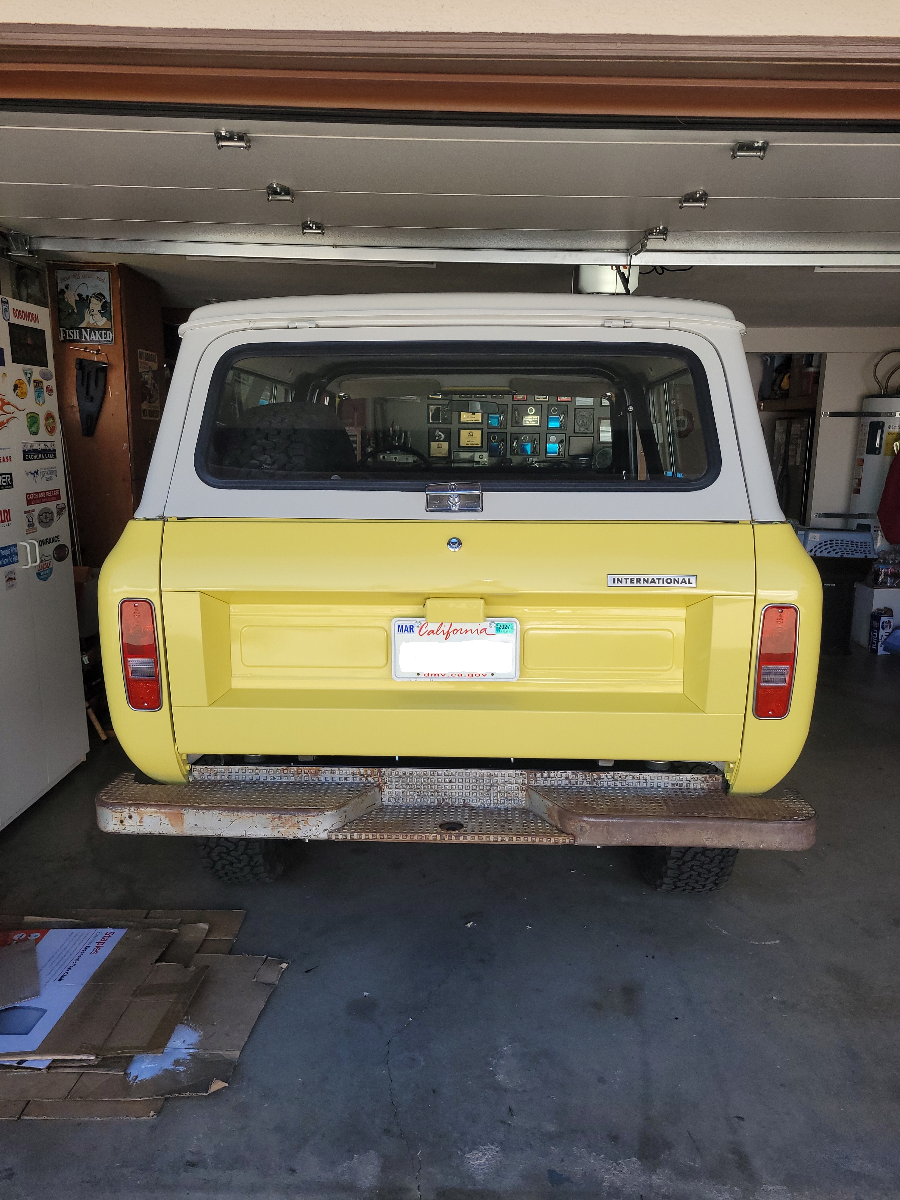

Here's an update on the Scout II project. I took it to a body shop near me in Menifee, Exclusive Autobody and Customs. They repaired the right rear corner that was hit by one of the PO. Who ever fixed it pryor did a poor job and just filled it with bondo. They did not even bother to pop out the dent or adjust the tailgate gaps. Exclusive Autobody and customs had to cut out the bad sheetmetal and replace in the lower corner, pull out the dent at the lower tailgate mounting plate and realign the tailgate gaps. My prior body guy at the equipment rental yard I used to work for did not get the chance to finish and block sanding the drivers side sheet metal before the business was sold. Exclusive Auto Body and Customs finalized all the block sanding, aligned all gaps and put a three stage paint job on it. Firts coat was a base coat of white, second was the OEM color; Sunburst Yellow and the final thick coat of clear was applied. I'm in the process of putting everything back together. This project is close to being completed. Another update to follow soon...

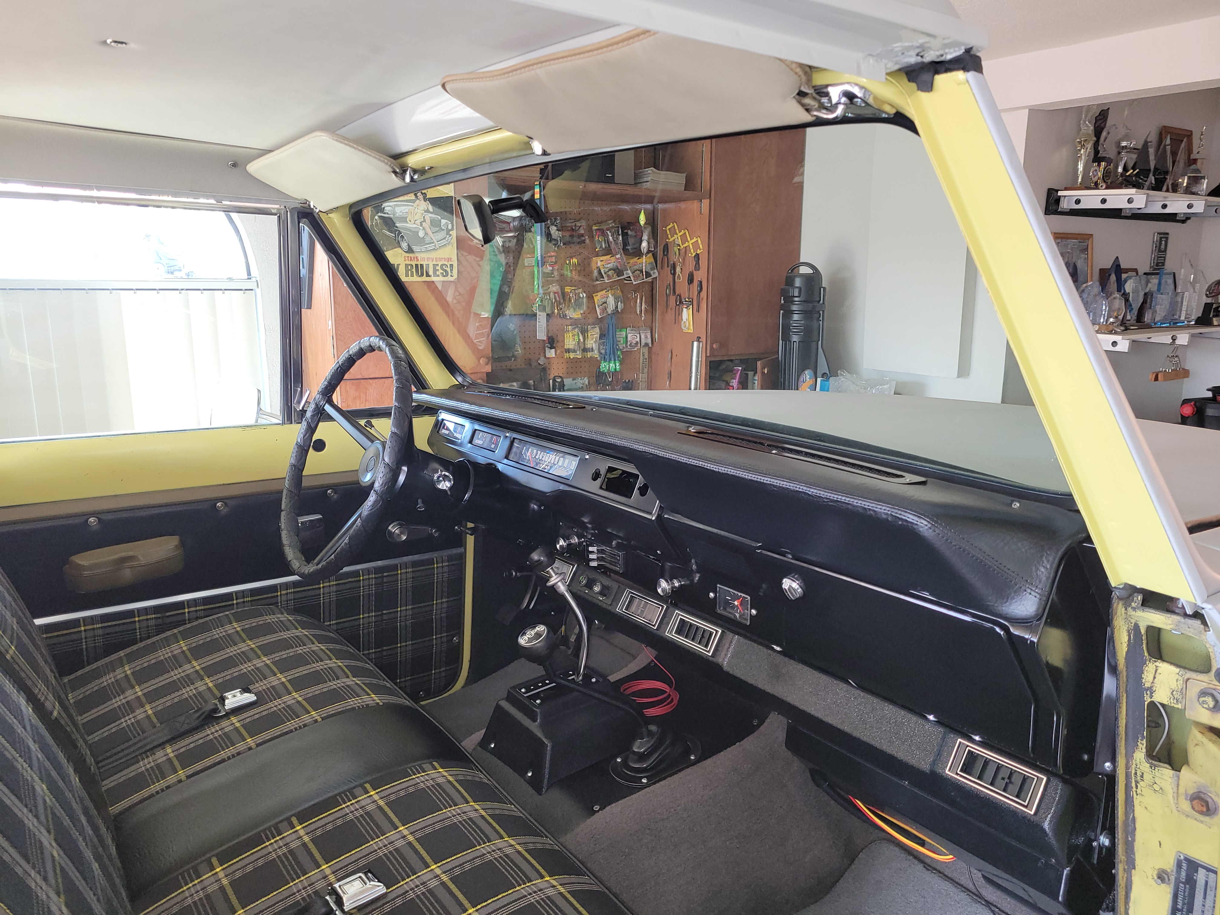

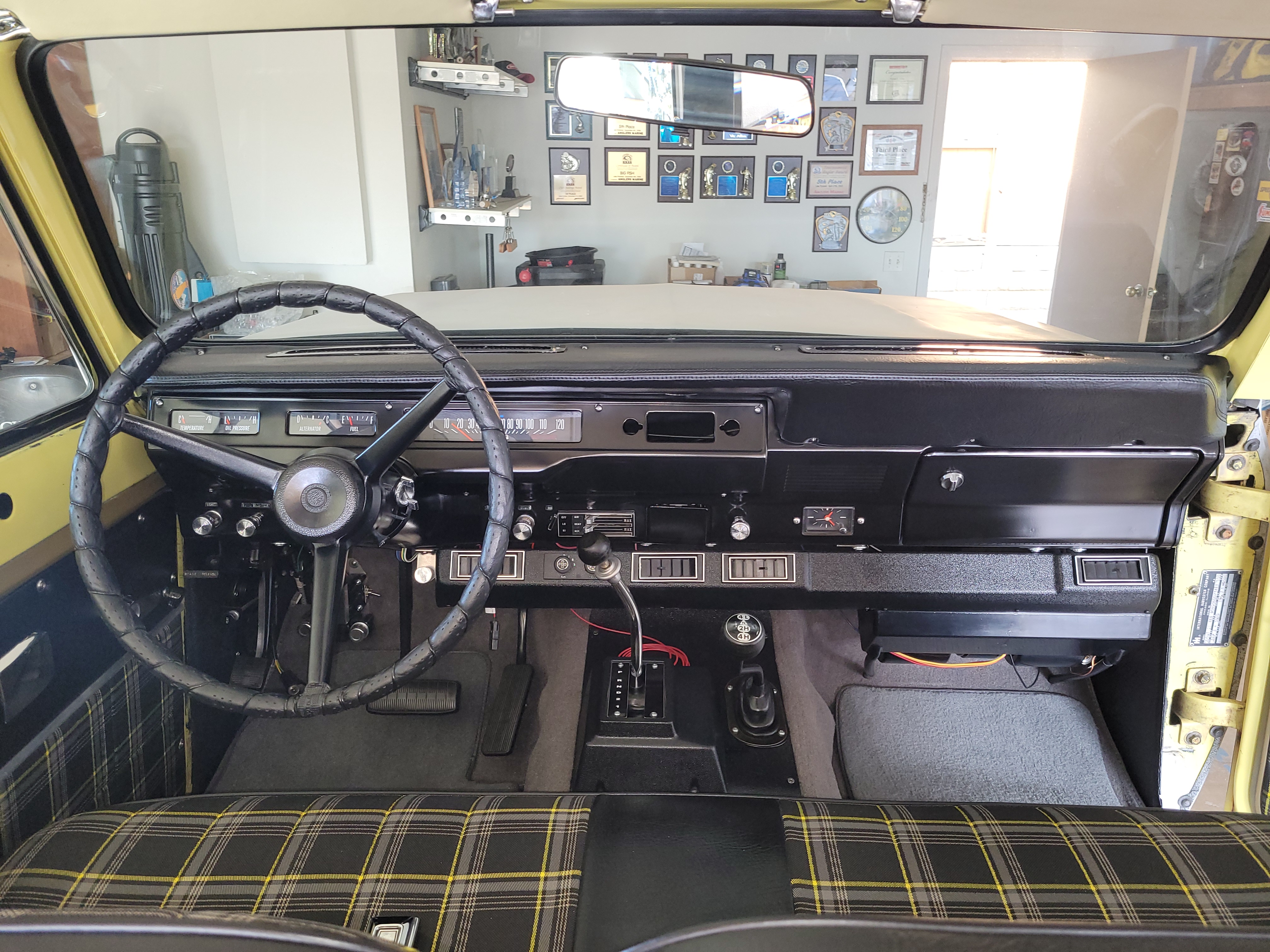

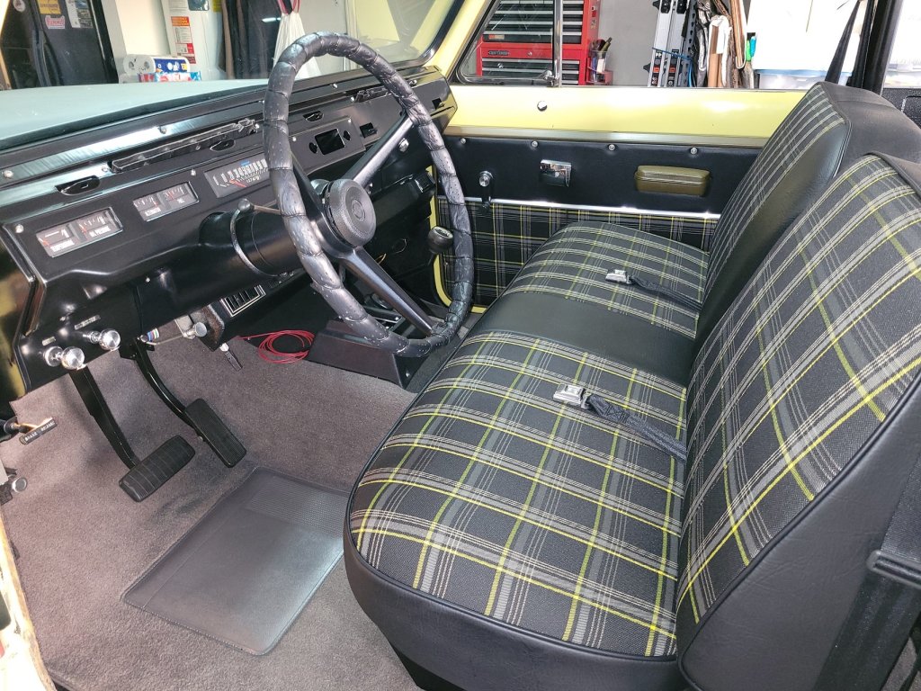

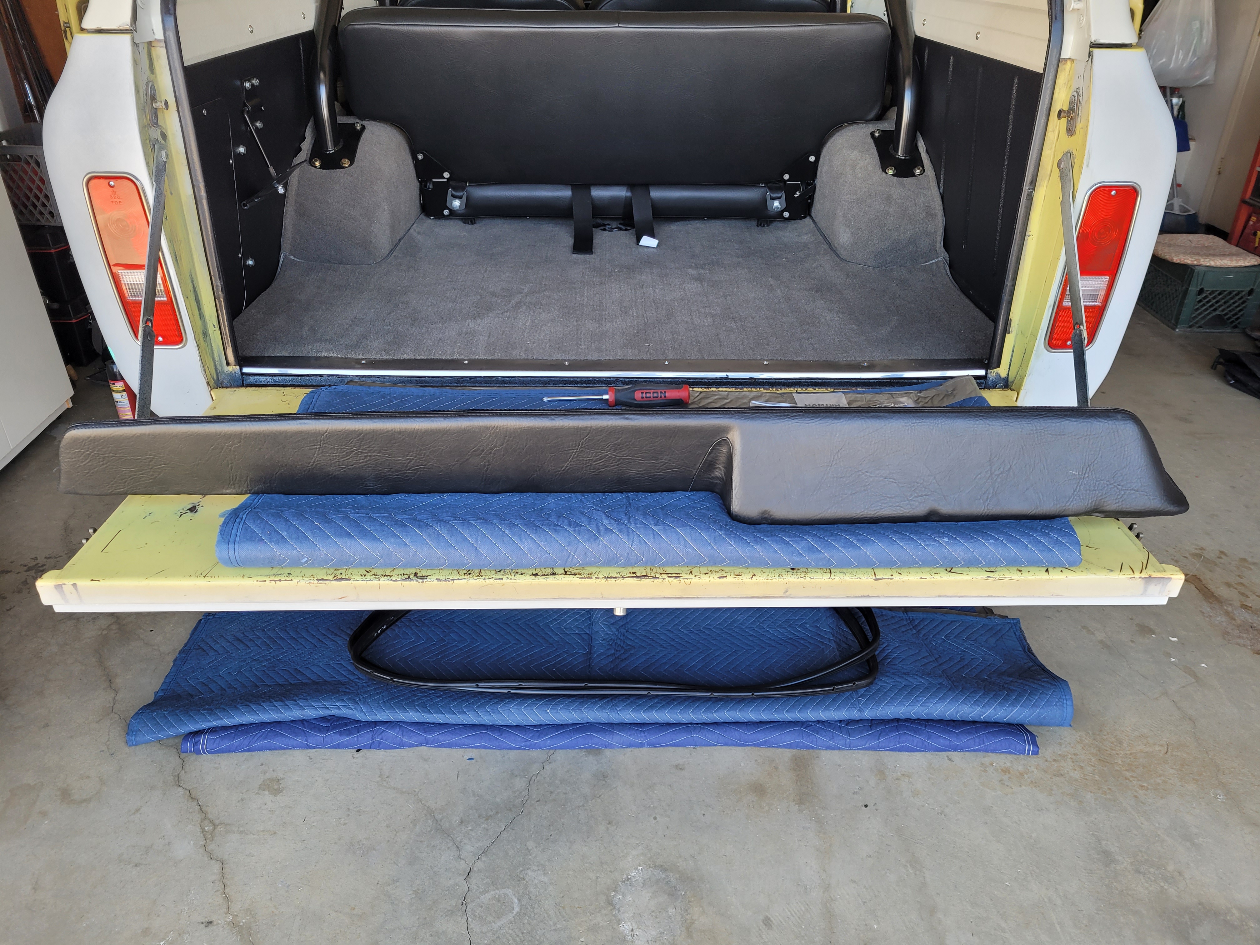

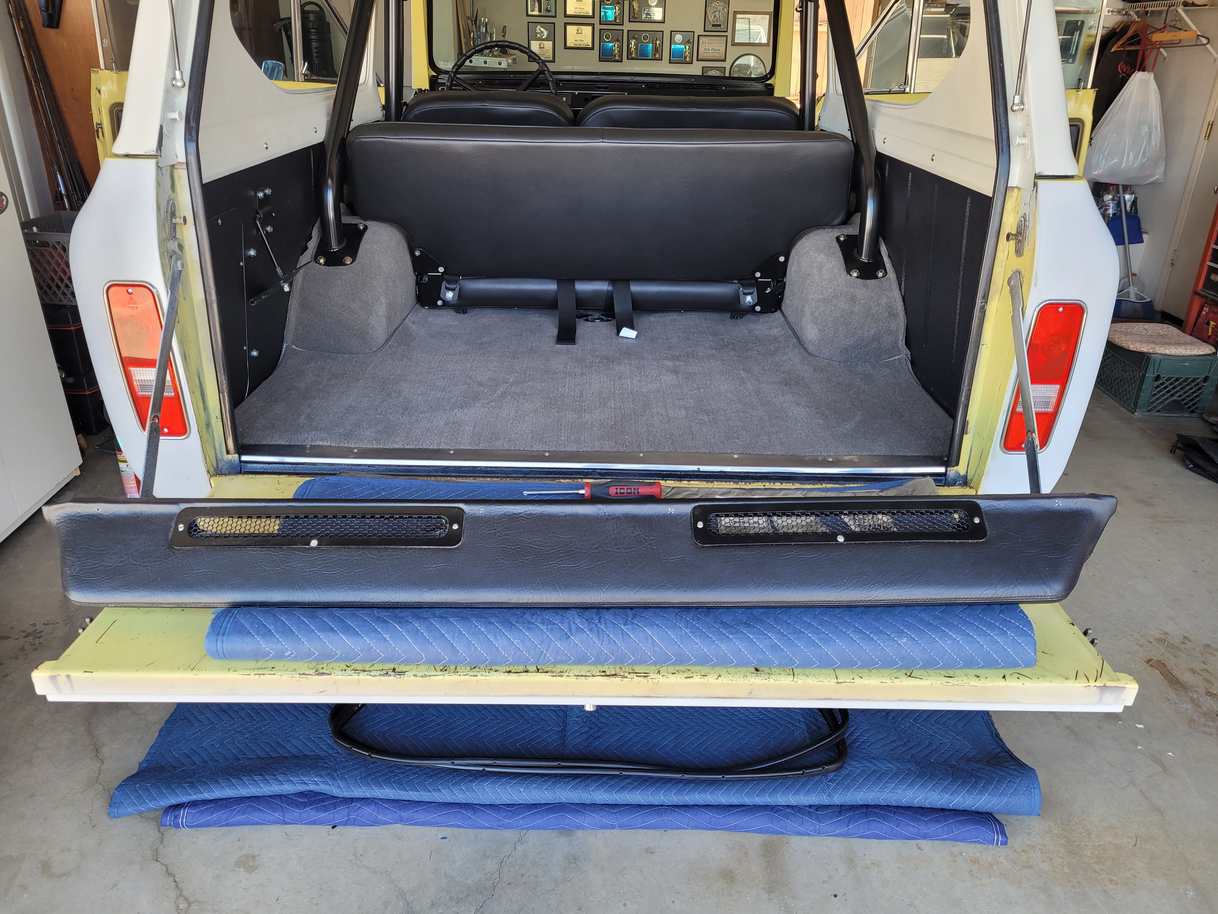

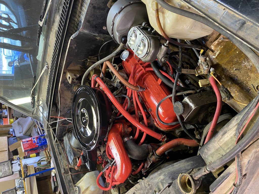

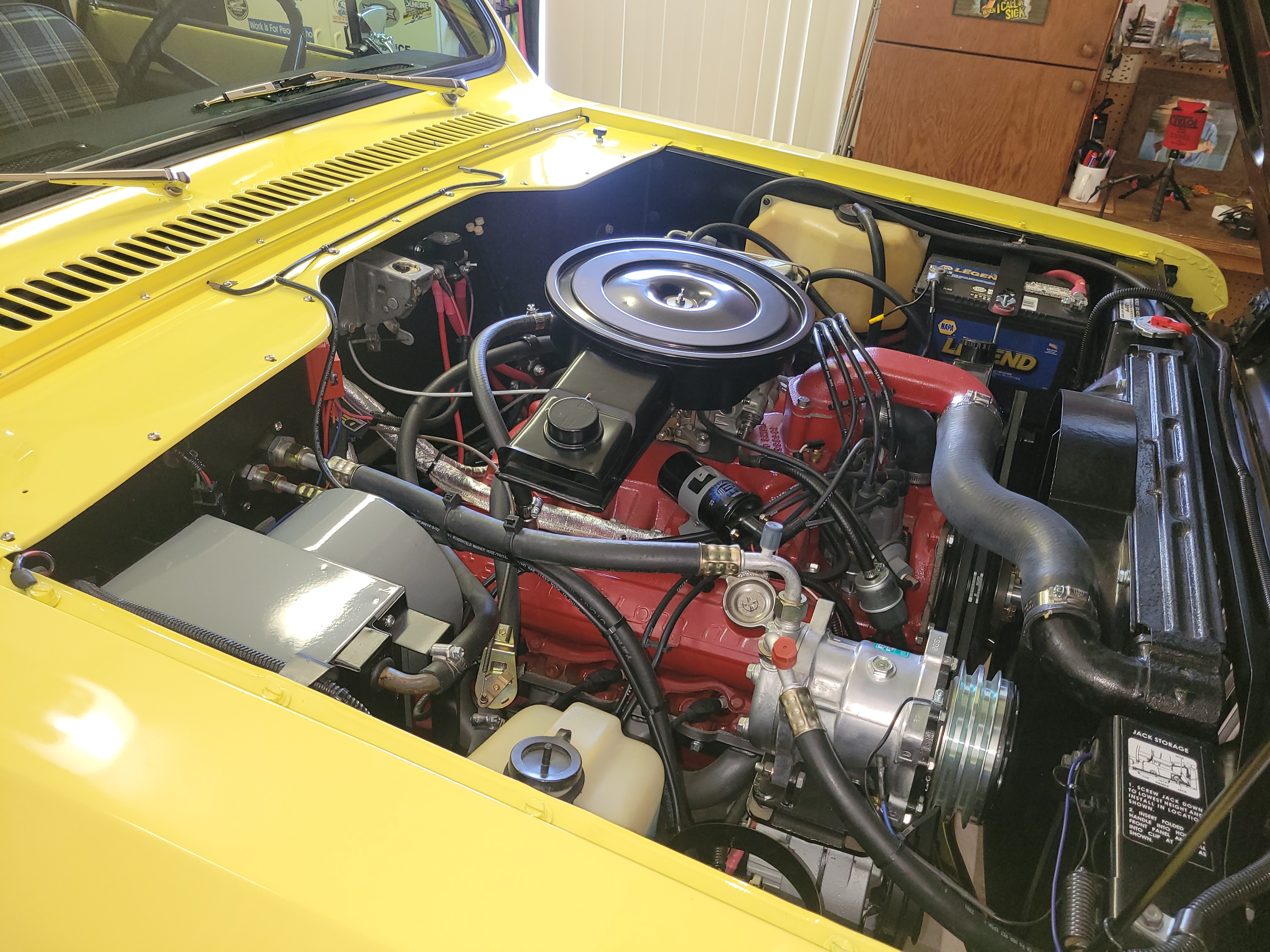

Well every one, she's 99.9 % finished. All that is left to do is finish hooking up the charcoal canister ( I left a post in the carb section for assistance), get the AC system charged and install a radio (last on the list). I want to thank all of the forum supporters who helped with advice, a special thanks to Darren at the shop for my numerous phone calls, Zaedster for also answering my forum questions when I needed help to get it started and especially Jeff for supplying us with this forum and the many forum questions he had answers for me as well. Have a Safe & Great 250 Year Celebration on the 4th of July celebrating our freedom!
