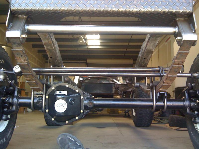

1. SOA and reverse shackle using CPT parts from ihonlynorth
2. Hysteer setup using partsmike setup
3. Custom built Dana 44 (hub to hub) with GM disk brakes from ihonlynorth - reusing the rear Dana 44

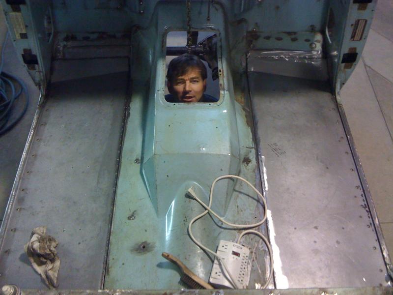

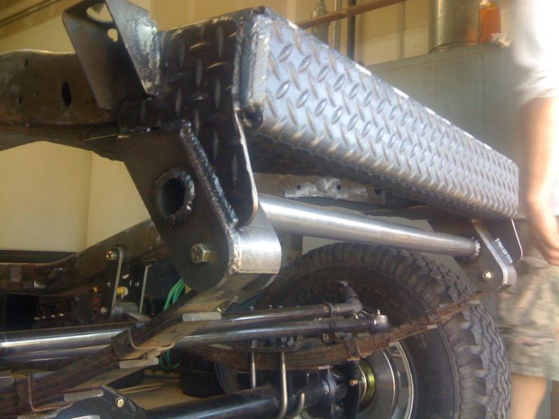

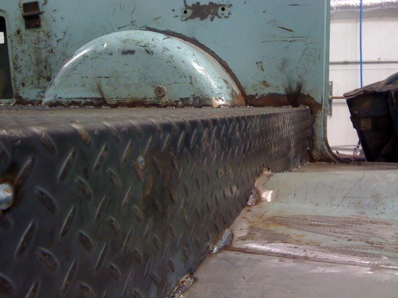

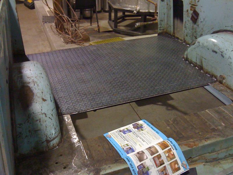

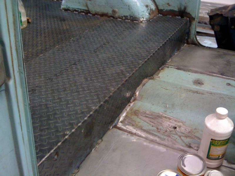

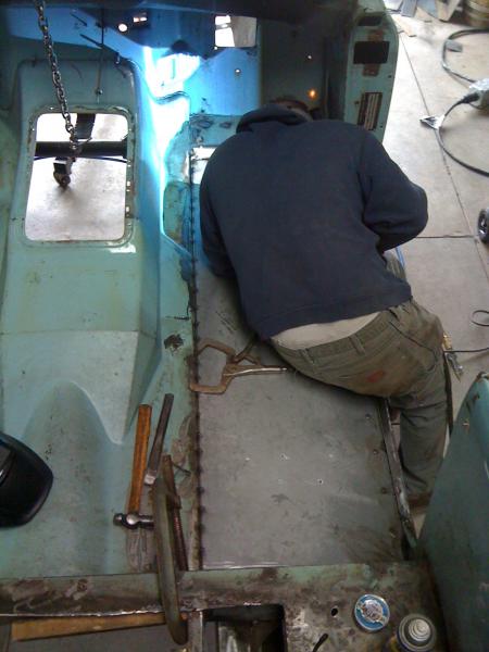

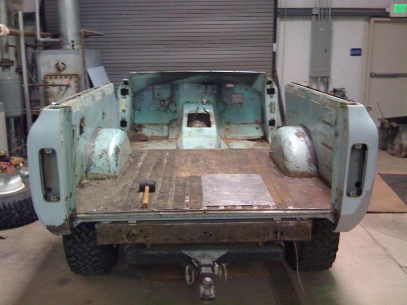

4. Replaced all floors (damn rust) using diamond plate for the rear

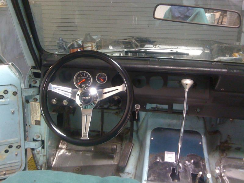

6. Lokar shifter
7. Stock Dana 20 - looking to do a twin stick setup (get those parts, Jeff)

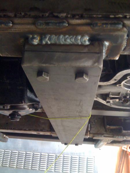

10. Custom built tranny and engine mounts.

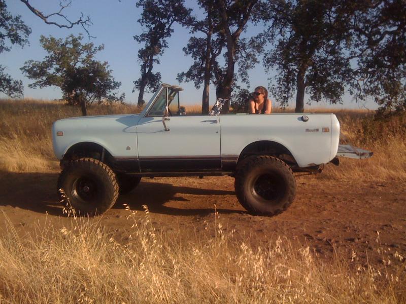

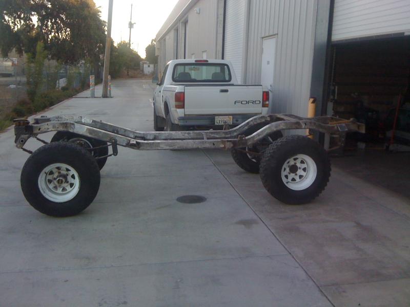

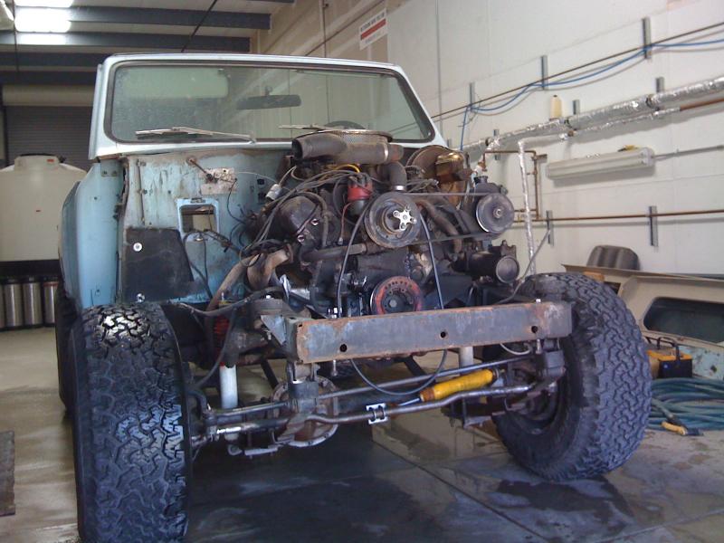

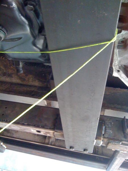

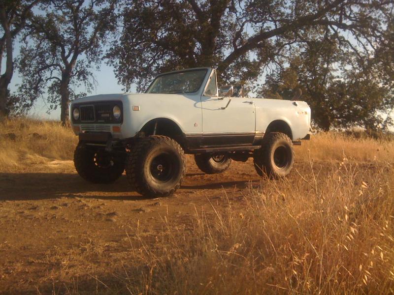

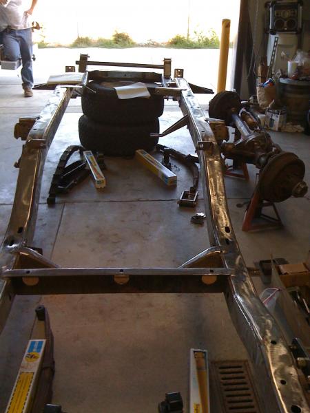

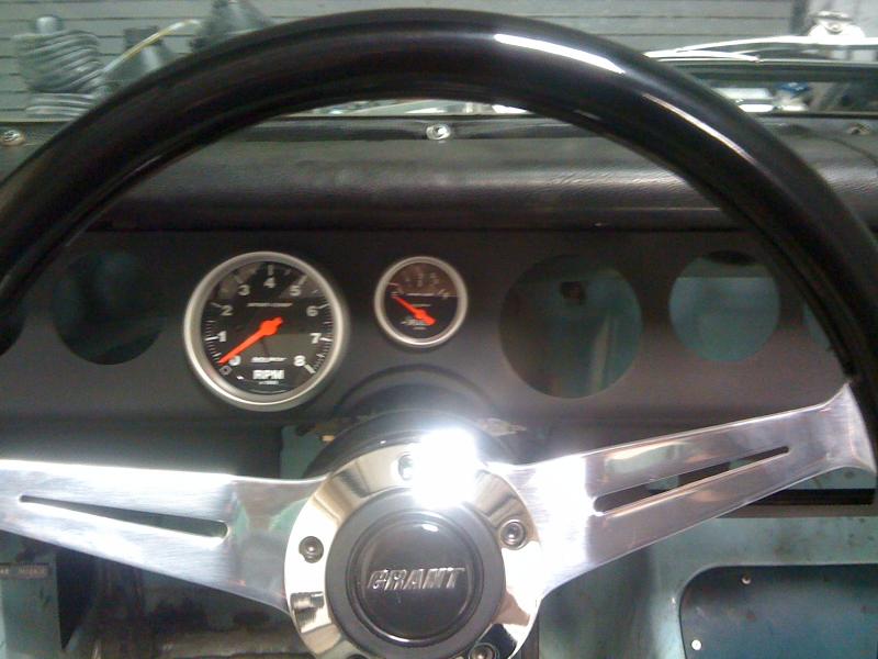

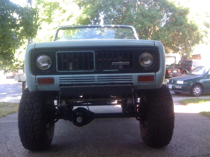

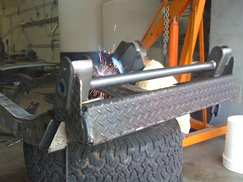

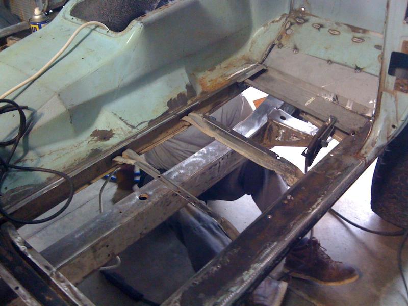

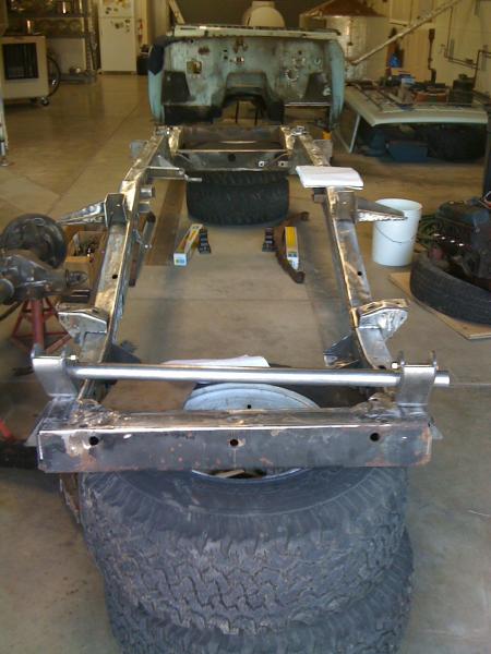

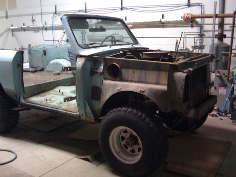

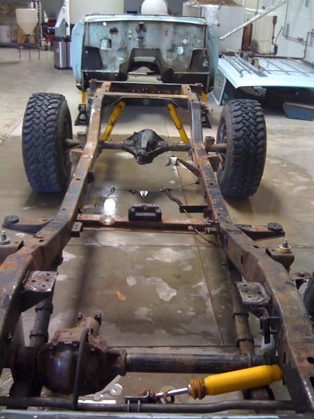

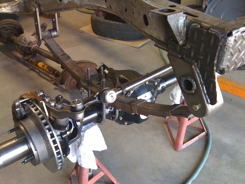

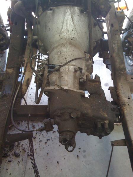

Alright, here are some pics of my progress.
And a few more:

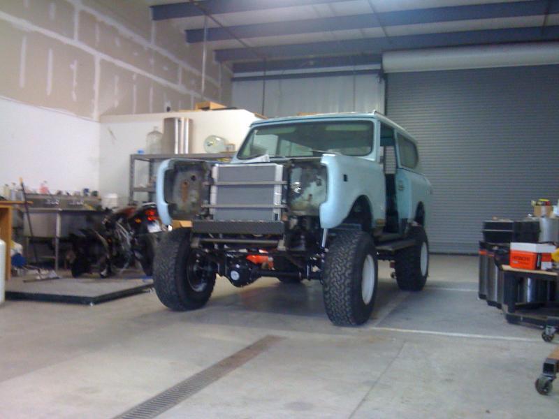

It was a summit radiator. The dimensions were close to 25x19 I think. I can double check on that if you would like. It is full floating and required a little fabrication but I think it will work well.

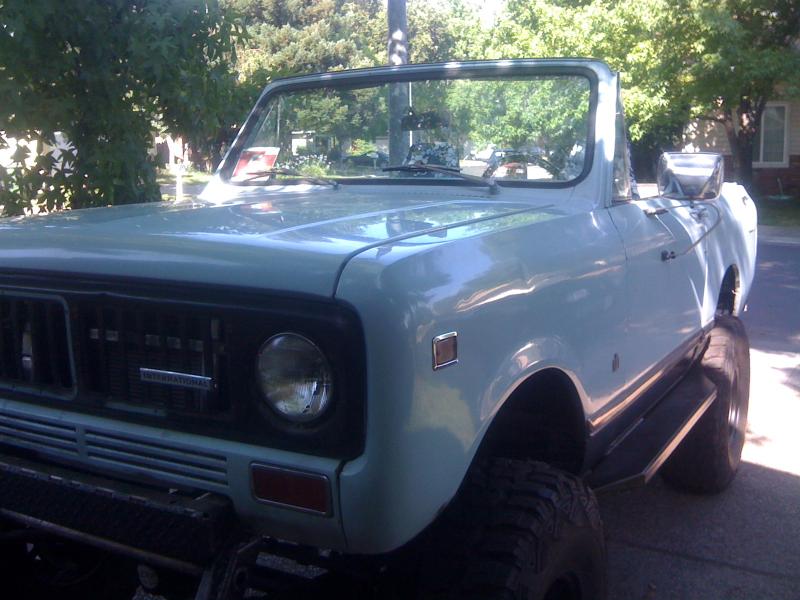

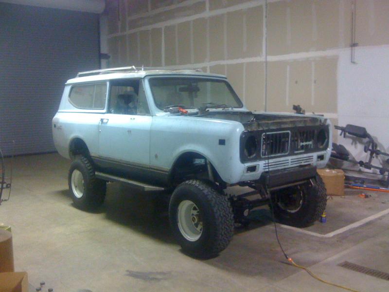

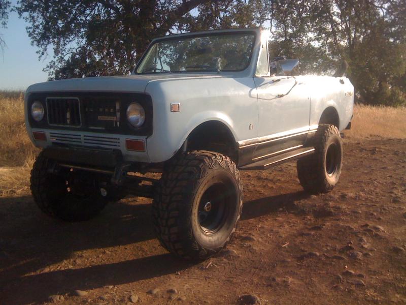

Here are some updated photos of my "in progress" build. Still a long ways to go but it is legally driving. I will post some engine photos shortly.
Man, that's a great looking project. Pretty solid chunk to work with. What gears did you put in?
Oh, and thanks for the pics. Makes the rest of us feel inspired!
Nice build, I really like how you broke the diamond plate for the rear step. It gives it a nice radious instead of having to weld all the way across.
