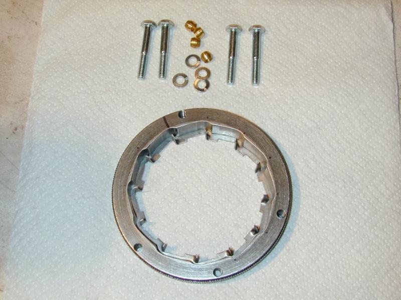

This pic shows a "bolt-in" sprag outer race, with hardware before installation. The difference in that item and an oem race is...the four small threaded holes in the perimeter and in some cases, the race has the perimeter serrations cut a bit larger in od and depth to provide increased "bite" when pressed into the case.

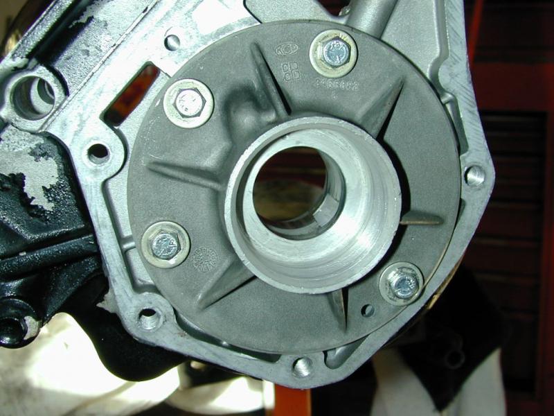

This pic shows the four bolts installed which assist in retaining the bolt-in sprag race, they replace the four oem bolts completely.
The rear drum support in this pic is a replacement, the original unit was fried both on it's internal and external bearing surfaces. That was due to a previous bogus "rebuild" that only lasted a few hundred miles before failing and wiping out all the friction materials internally, a real half-assed rebuild.
That support has the rear drum riding on it's od inside the trans, and the output shaft rides in the id. That drum support is "shrunk" into the case during assembly, I have one in the freezer right now for a rockcrawler 727 I have in process currently that will be spinning a klune unit in front of a d20.
