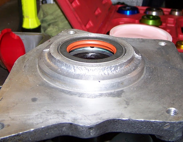

The first is from the 727 rebuild link on binder planet. It's his IH extension housing with his output shaft seals installed.

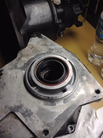

The 2nd is a similar shot of my extension housing's seals.
Which one of us has their seals in backwards? Or are they just different types of seals?

In the first photo, I think he used a different type of seal. The second photo is normally how that one seal should be facing. That way it will keep gear oil in the t-case. The other seal, which is placed just inside of the one shown, needs to face the opposite way, which will help keep the trans fluid inside the trans.
