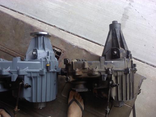

Behind my 700r4 I have an NP208. The stock one was so long that my driveshaft angle was so steep it vibrated like a king bed with a quarter machine attached. So I bought another NP208 off craigslist and shiped back half and output shaft to Tom woods to be machined down. They sent it back with a cv shaft also. Here are a few pics to show the difference. Also had the transfer case rebuilt while it was out. Test drive last night and it was as smooth as a cadilac!

Cool job travis. I did the same 700r/np transplant. What I found was at freeway speeds, I still had some vibration. The cv joint wants to have the rear diff angled up to match the angle of the drive shaft. I couldn't go that extreme without re-welding the spring perches, but some 6 degree shims definitely helped. I can barely sense the vibration now.

I bought those rear spring perches with 3 holes to move axle forward or backward and inch. So I had to cut off old ones anyway. After welding the new ones in with the old setup I spent hours and hours careflly grinding and cutting off again. So I angled my axle up almost 20 degrees to match the driveshafts angle coming down. Over drive is sweet although I am having a problem getting my 700 to lock up. I bought one of those B&M lock up boxes its but not locking up. I double and triple checked the wiring. Only thing I can find so far is my pulses on my speedo sender is 16 revs where the B&M instructions says 40 revs. I'll call them on Monday.

Did your first drive shaft have a cv joint? That along with your spring perches make a huge difference vibration-wise. I'm saving the spring perch project for when I do a locker/4.11 install.
No the original shaft was a stock Chevy with the slip yoke. I used a 1310 to 1350 conversion joint in the back to match the 44 output yoke.

I still have the stock length tailhousing on my NP208 and dont have any vibration maybe I just got lucky
Mine had about 6" lift when I did spring over. Driveshaft was really steep and that's probably the vibration.
