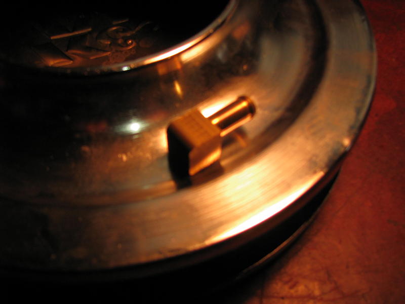

That'll give you what is called and "open" PCV system. I preferred a "closed" system that has the breather going to the carb. I did the K&N stuff years ago. Here I put a fitting in the bottom filter plate inboard of the filter.
The carb draws the vapors under heavy loads, so there's no residue getting on the engine. Makes for less pollution. The fitting was a 1/4" male NPT X 1/2 or 3/8" hose fitting. I cut the threads short so it didn't stick out too much, then secured it with a brass jam nut. Sometimes you can find these fittings called "bulkhead" fittings. That is they're made to attach to thin walled or sheet metal housing such as an industrial gauge panel. Anyway. A touch of RightStuff to seal it and it took me about 45 minutes.
