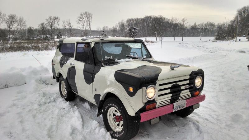

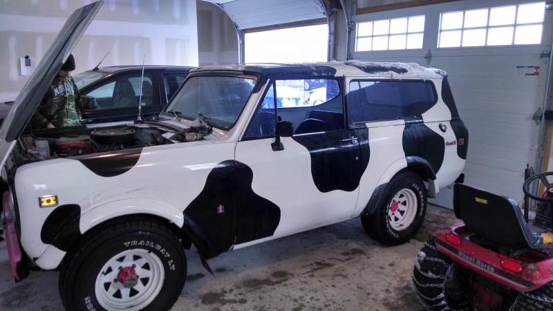

Finally made the leap and bought Scout after having one as a first car 20 years ago. Purchased this west coast 1972 Scout II off of ebay last month and I couldn't be happier, now that it is home.
Ok, so..... Lets just get the jokes out of the way... Under that paint it is still a Scout! I figure, lets make it work very well then we will worry about looks! I ended up picking her up during a snow storm and drove her an hour home in 12" of snow, she is tough!!
Condition: very good.... 46k miles.

Hey jersey boy, another transplanted jersey boy here. Normally I'd agree with your priorities, however in this case a few rattle cans of grey primer might be in order ;-). Or jersey brown might be a lot better than holstein. Any way congrats on the score and thanks for the smile.
Ha ha ha! Ok, here we go...it's on! all true though.

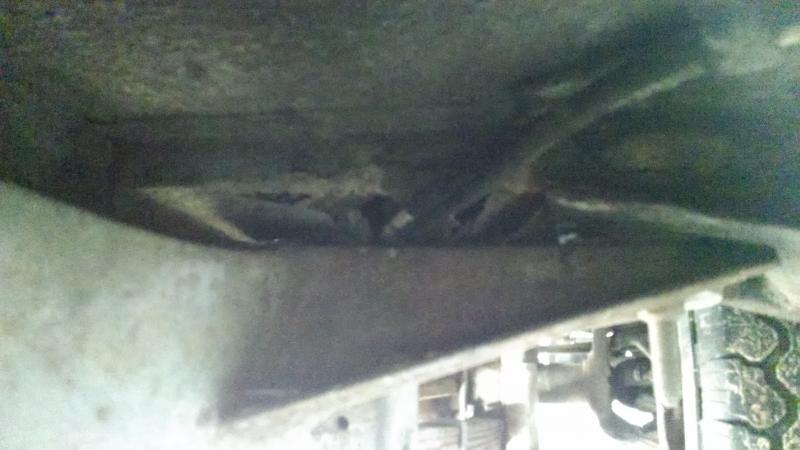

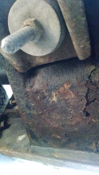

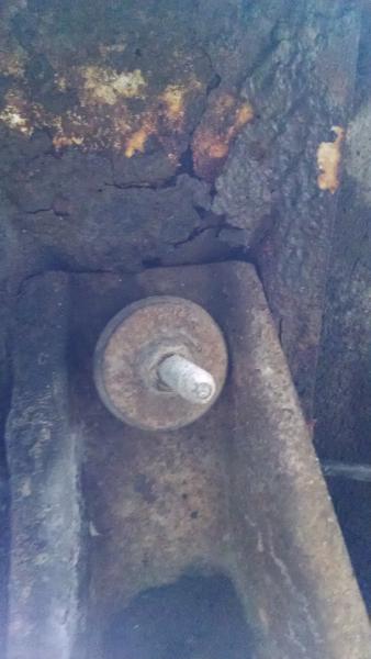

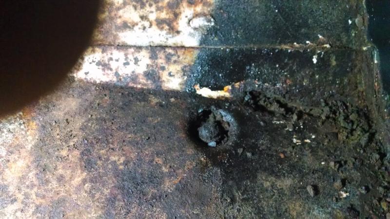

Here is my first problem. I want to replace the worn out body bushings as they are flat and she is sitting low. Everything looks great and I was getting ready to order the poly bushing kit from IHPA (I assume these are the best) but I see the body mounts on either side, at the front of the rockers, is rotten. Pics attached so I hope you can see, it is the parts that are attached to the body as the frame mount is fine. Rot doesn't extend to rocker or floor pan, so I am wondering if there is a way to get a piece "fabed" and cut the rot out with a grinder! Important - I'm not a mechanic or a fabricator! My welding skills are "for emergency only" but I am looking for a smart solution that I can pull together myself. I would like to do all I can myself, but will take what I cant handle to a pro so it is right!! Hopefully I do not need to strip and remove the tub for this.

Bummer about the rot. If the mount is that bad, the floor boards are probably like swiss cheese too. You'll need to remove the floor mats to do the body bushings so that will reveal what you've really got there. On the bright side, when the floor boards are out replacing the mount is easy. I would start looking into a mig welder that will run .023 wire.

Got milk?
Body paint aint so bad. Moooo. But at least rattle can the bumpers and hubs. Unless your better half approves and wants it like that.
The cancer around those front body mounts is fairly common. I have replaced a few. A little 110v buzz box is good for doing the light work. I had to turn my 220v lincoln all the way down for the sheet metal. I wouldn't be surprised if a portion of the floor is heavily pitted either.
The poly bushings are good. I have two sets currently installed on two of my scouts.

Good call by the way, better half said "maybe you should leave the paint". Rattle can the bumpers and other pink parts black, black rims and maybe we can live with it for a while! "topless" always looks good anyway!
Rust and rot are my biggest fears because I have no experience repairing it. Of course, now I see IHPA has the exact parts I need to replace (front floor mount & wedge) so the job is getting more manageable. I think I forgot the first rule of IH Scout ownership that I have learned reading these forums.....dont panic!
Ok, so now I need install help and suggestions. It appears I can jack that body up enough following the instructions in other threads for bushing replacement to cut out the bad parts and slip in the new parts. Ive hunted around the floor boards from underneath and cannot find any rot so assuming there isnt any more to be found I need some direction:

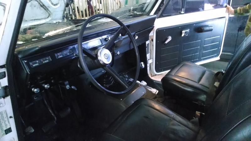

1. I have original seats and floor mats which are in good shape. Should I just strip it all out entirely? I don't want to ruin the original floor mat but want to do it right!!

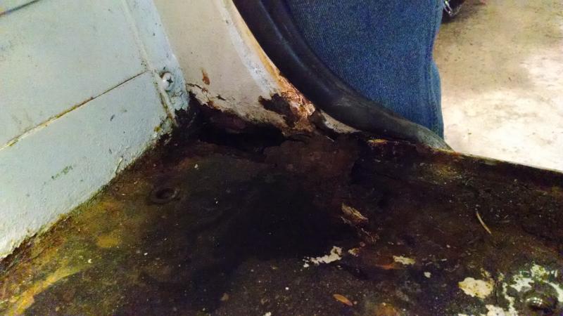

My floors looked good, until the floor mats were removed and the holy cow it looked like a colander. After doing all the replacement work the whole interior of the tub was line-x'ed. After 12 years it's still holding up well.

Pulling the mats now and definitely more rust around the edges than I thought. Will look at new pans.....

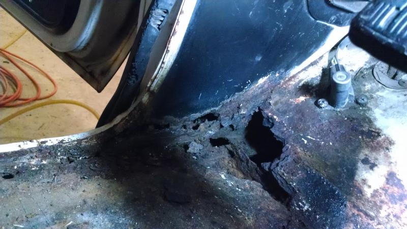

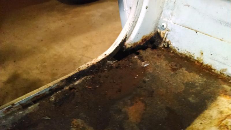

I got the mats out and found the extent of the rust
looks like I will be ordering new floors, floor cab mount, mount wedges for each side. I think the rockers are good.. Probably door pillars to be safe
any thoughts are welcome....

Yup, fairly typical cancer spots. I forgot to mention that, to my surprise, that ole yeller didn't have the cancer. Especially being parked out on the street for like ten years with out a top before I acquired it. I think I posted photos of it when I stripped the interior. My 73 beast on the other hand needed half the driver side floor replaced, along with a patch panel between door a rear wheel well.
Agreed with what others mentioned about the mig. If you actually decide to get one, a good starter lincoln or miller 110v is good for doing thin material like sheet metal body repair but fall short on anything above 3/8" to 1/4". And it's fairly portable using almost any 110v outlet. Solid wire with 75/25 mixed gas is the way to go, as long as no wind prevails. Flux cored wire is mostly for outdoor use, but creates more splatter.
