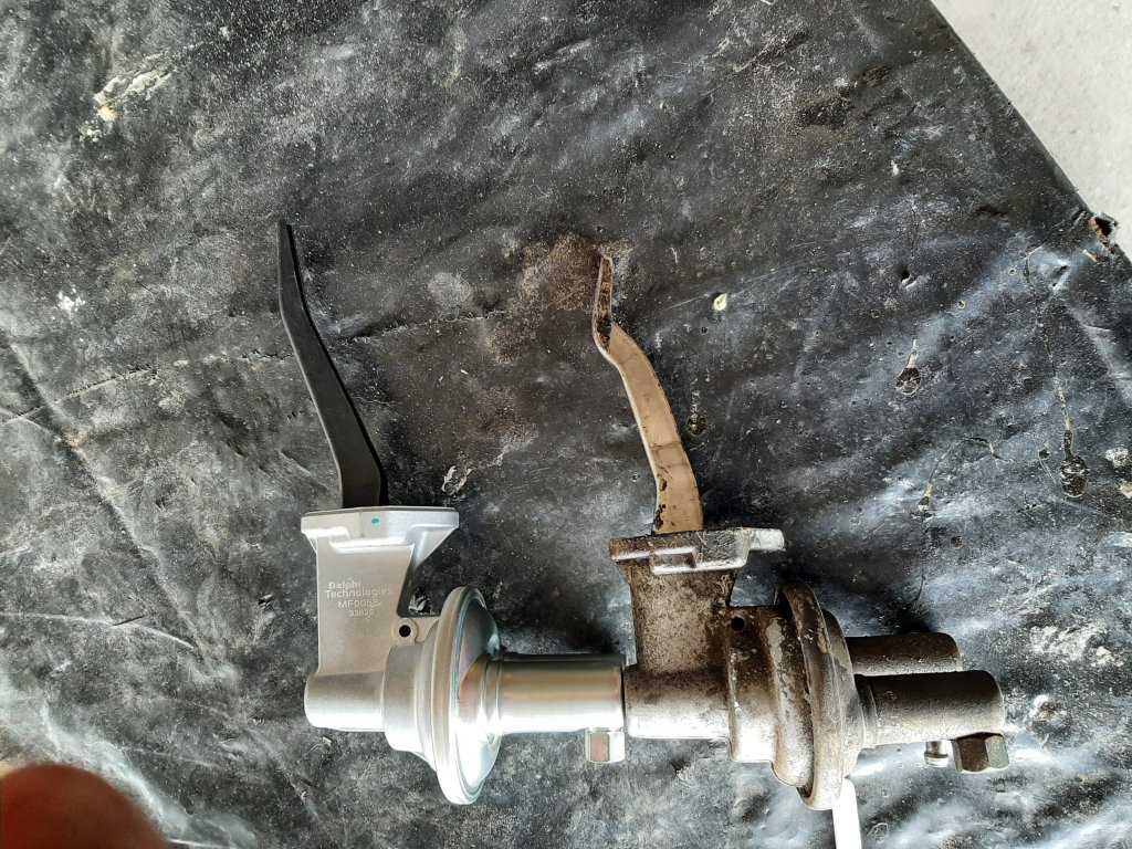

The attached photo shows the original pump on bottom and new one on top. Will it work? That seems to be the only one that comes in when I order one(MF0058), even though the photo looks like the original pump.

I just tried the Delphi MF0058 on a 345 and it ran for about 30 min then broke. It ground a slight dish in the arm and the pump broke internally. Guess it could just be a cheap, faulty pump out of the box? Put the stock one back in and it’s been fine. Gonna try a Carter M6959 and hope it’s the shorter arm style like stock.
The Delphi was the one I broke as well. I’ll try to find the Carter part number.
I should have known something was wrong with the Delphi when it didn’t bolt in easy.
I didn’t think I’d ever get it mounted, actually took 2 of us! I thought it was just a tight spring.
Yeah, I knew it was a red flag when it was so hard to put in. But I swear I’ve successfully installed one of the longer arm pumps into one of my Scouts at some point cause that’s all the parts stores list.
