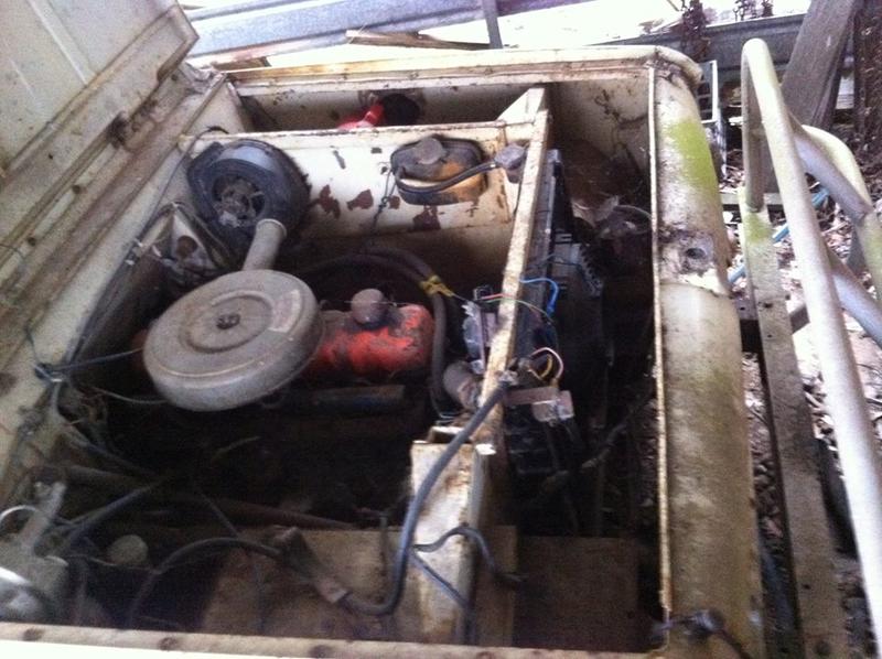

Hi guys
I have just picked up a 66 Scout 800 and found it needs a new engine and gear box... It has a Dana 20 twin stick transfer case but thats all the info I have at the moment as I haven't had time to have a good look over it yet... I have a chev 383 with a turbo 400 just been built.. What I am wondering is if the transfer case will work with the new drive train or would I be better off finding a new transfer case as well?(sorry to the Scout purists)

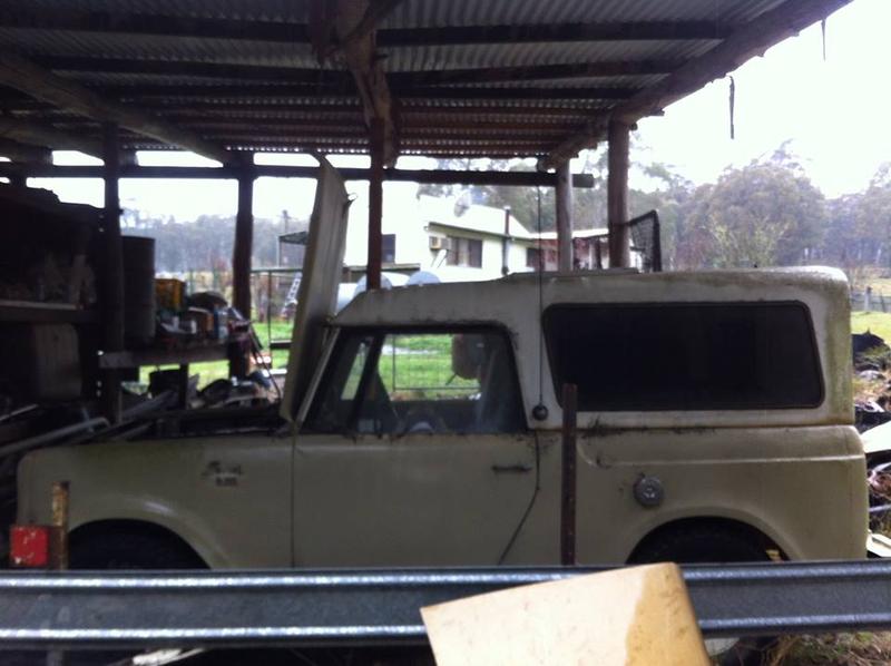

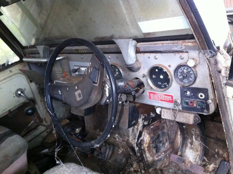

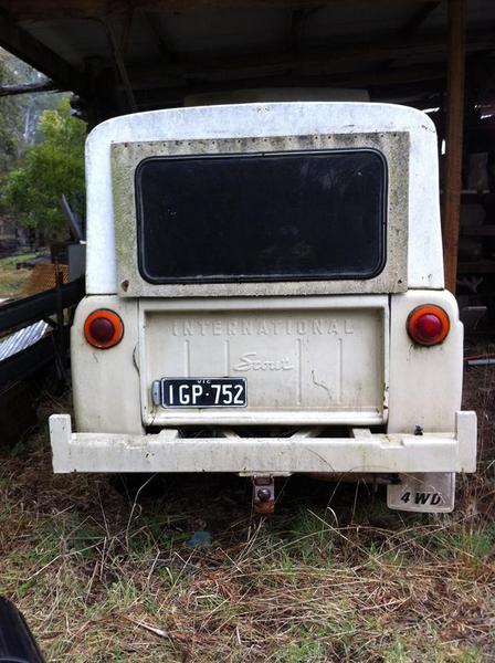

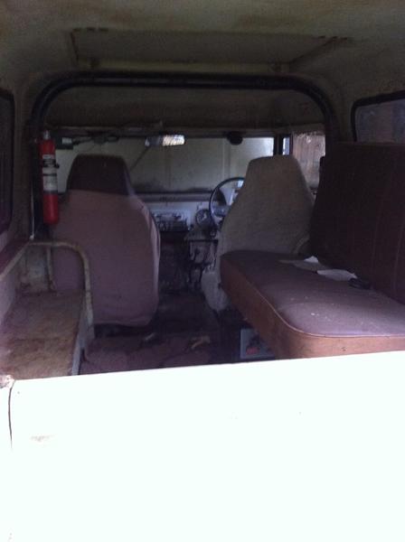

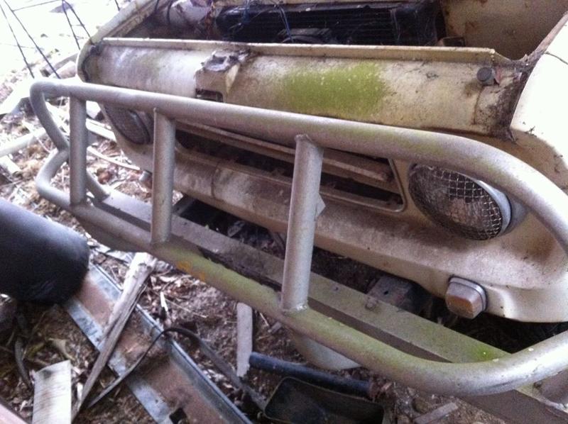

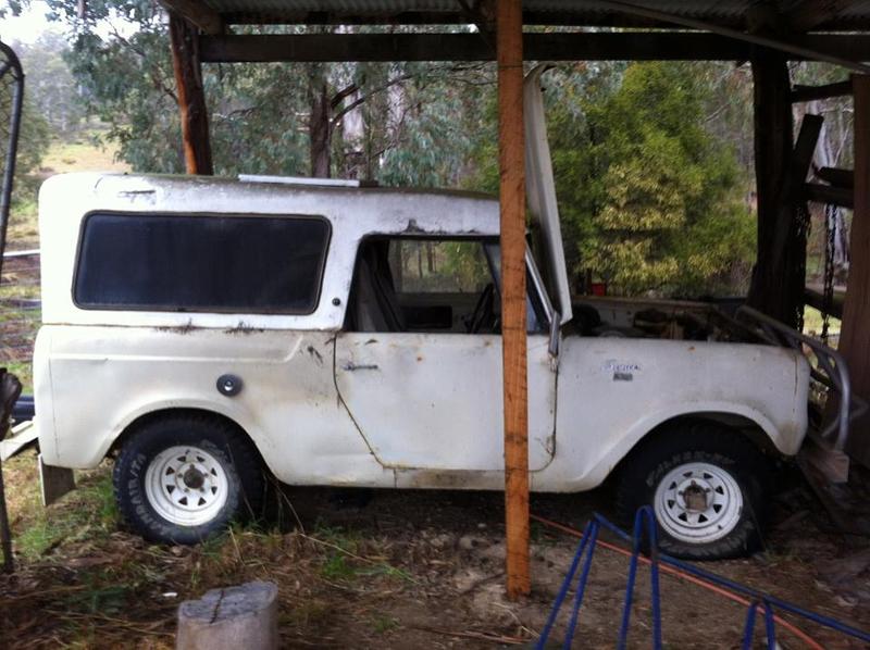

The old mans Scout I found in the hay shed, he passed away 15 years ago and hasn't been moved since.
It does start and it does run but has a very leaky engine and the cooling system is shot so im thinking it will be getting an upgrade.
I have a chev 383 engine and a turbo 400 tranny built to go in a holden wb (being in australia) so should work with an adapter to the Dana 20
im open to suggestions on what parts to use or other ideas.
Im picking it up once wheat harvest is done (around Christmas)
