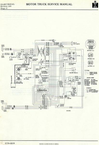

Here is a schematic for a c-100 through a c-130.
You probably have some weak connections at the ammeter, the ignition switch, and possibly the bulkhead connectors.
Check for voltage drop between the battery and any one of those connections, say between the batt+ and the b terminal on the ignition switch with the lights or wiper on. Also check for voltage drop between the battery and the I terminal on the switch. Any connection in the path from batt to the ammeter to the switch which is not good contact can make for such a drop in voltage that any load can reduce the voltage to the coil enough to kill the engine
tarnished connections can also make your charging voltage high if the regulator can't "see" true output or voltage.
Cleaning all conductor ends and connections is some labor, but cheaper than chasing your tail throwing parts at it. ;)
