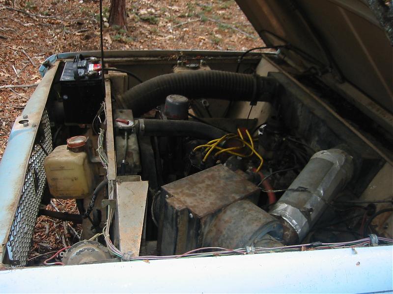

I do have one that I just found (that I will post) of under the hood from the other day, but its of 4' away. Dont know if you can tell what's what by that far away, but from other posts ive seen you on im guessing you might be able to...?
Thanks, chris

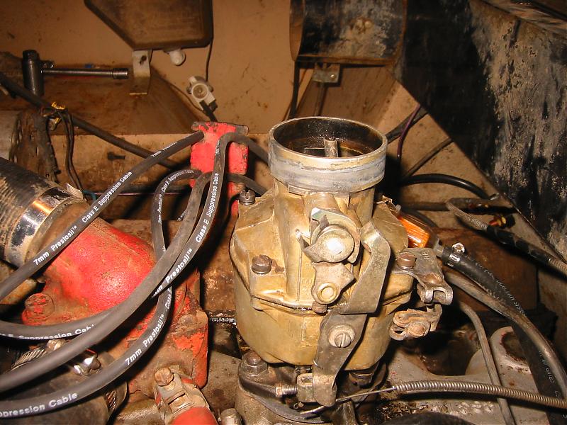

Pics.
Best I could from your image is that you have a carter bbs series carby.
I am really struggling to make that out, more is impossible. A close up photo would help greatly.
Shore looks like a rochester to me from that view! I got a few of those, one of 'em came off the '35 IH c-1 peekup I got going on right now.
Zoomed in and compared to old yeller's mixer. Sure look the same and again mm's right. Model b rochester or similer.

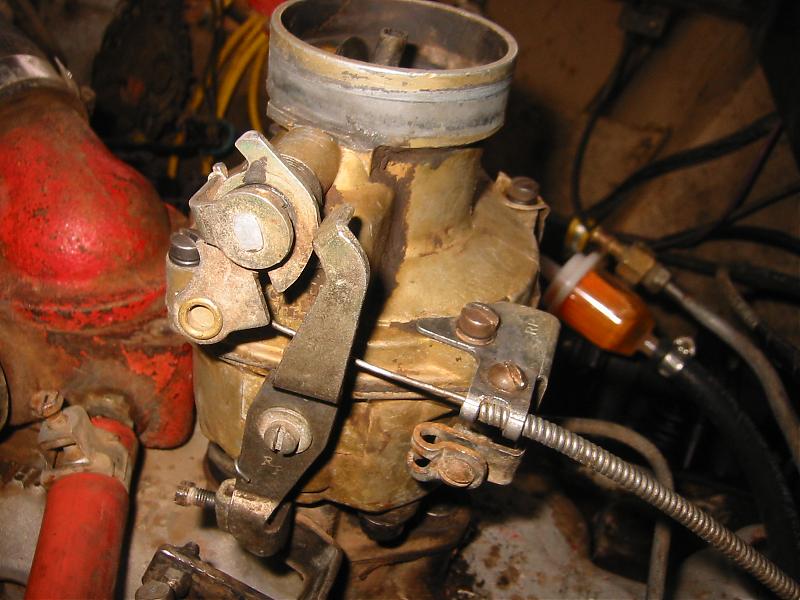

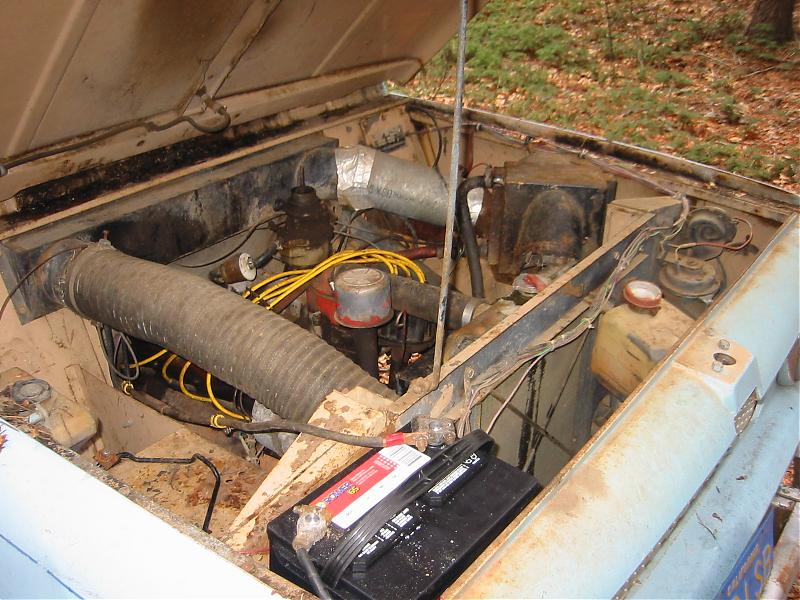

Got her down the hill to my shop and took a whole bunch of pictures. Rebuilt the carb and pulled the distributor and made sure it was all cleaned up and set right.
Problem im having with the carb (really the electric fuel pump) is its just flooding the engine so much that it filled the crank case with fuel and now I gotta drain the two stroke fuel out of the crank case and refill it with fresh non-gasoline reduced oil.... :icon_rolleyes: cant believe I did that. Im thinking the gas in the oil isn't doing a whole lot for the hydraulic lifters or the cylinder compression.... Wondering if that was the problem along. Gawd I hate having to unravel other peoples problems.....
So is the oe fuel pump long gone or non func then? Sounds like a fuel pressure regulator and gauge are in order.
The oe pump was bypassed before I got the vehicle and looked like it was in service for quite a while so who knows how much flooding that engine has seen... Yeah, a regulator and gage are in the works. Gonna start at about 3 psi and go from there....
Fyi, I think im just gonna rebuild the oe pump since it looks like there's a vacuum assist built into it and maybe run the original. Dont know just yet.
The oem fuel pressure spec for all IH I-4/sv motors is 5.5psi inlet pressure. All the carbs used originally on these engines operate perfectly at 3.5>6psi.
Typical aftermarket electric fuel pumps for carbureted applications are sold at rating of 4>7psi, and 7>14psi, some are rated much greater for race-app carbs only. A fuel pressure regulator should always be used with an electric fuel pump along with a gauge to set it, the tick marks on the inexpensive regulators are useless and meaningless.
Do a search on this forum for keyword "fuel pressure", there are more than 30 returns for that keyword!
Is the electric fuel pump pushing or pulling through the oem mechanical pump (perfectly acceptable and I do that all the time)?? If so, and the oem pump diaphragm is punked, then gasoline is pushed directly into the crankcase.
That rochester carb will support an inlet fuel pressure of 6psi if it's done correctly and the float height/drop is set.
