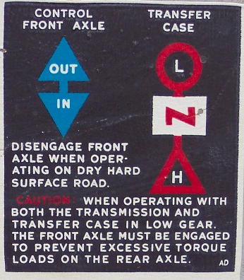

The 61 Scout I have has a Dana 18 twin stick. Pattern for it is left stick controls front axle. Forward out back in. Right stick is low -forward, neutral - mid, high - back.

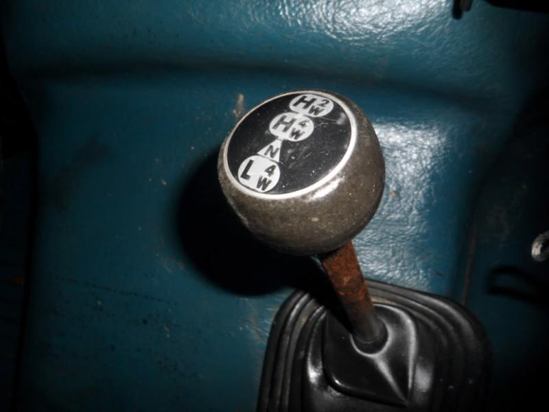

If you have the np-202 transfer case, the shift pattern is as follows:......
-forward-
2 high
4 high
neutral
4 low
-rear-
