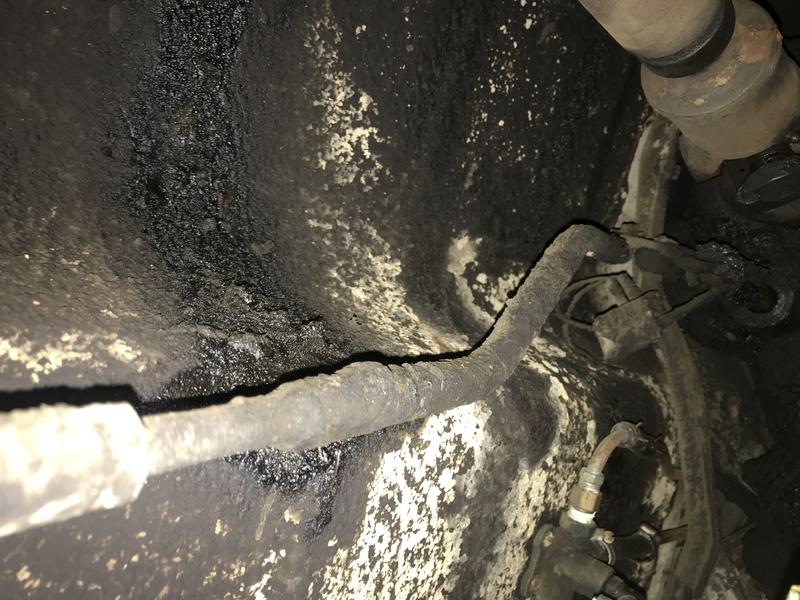

Another good point. I believe it would depend on what unit you have, weather it was capable of 2wd low. I have a NP202 in mine, the shifter atleast can only select 2/4 high neutral and 4 low. No idea if the t-case itself would be capable of 2wd low, but there are 2 seperate shift links on the 202. Again pics would help ID both units in your setup.
So 4th being 1-1, My 68 in low range 4x4, 45 is top mph in 4th gear. Seems the most logical diagnosis that you are in low range. Already mentioned by other members.
If you have the single lever transfer case shifter, crawl under and have a look at the linkage and the two sliding shafts that go into the gear box. If they are corroded or mucked up, they can jam up. Shoot some penetrating oil on the sliding shafts and have someone work the lever while looking at the movement.
Attached a photo of the transfer case linkage. The long bar is connected to the lever out of view, and the other end that you can see, connects to the sliding shafts that enter the transfer case I referenced earlier in this post.

I freed up the stick by disconnecting it spraying some penetrating oil on the thing and now it is as loose as a goose.
I will crawl under tomorrow to see if she is stuck in low range. I found a sticker for the shifter in the back of the truck, shows a 4 speed, which of course means nothing.
Thanks for the pics. I will be taking a look tomorrow for sure! I like the idea of the transfer case stuck in low range. Could be an easy fix. Unless it's not. In my case, scratching the surface invariably leads down a rabbit hole of millions of little things.Good news, is I think the brakes will be sorted out tomorrow, and therefore when I get above 35-40mph I will be able to stop. :)
