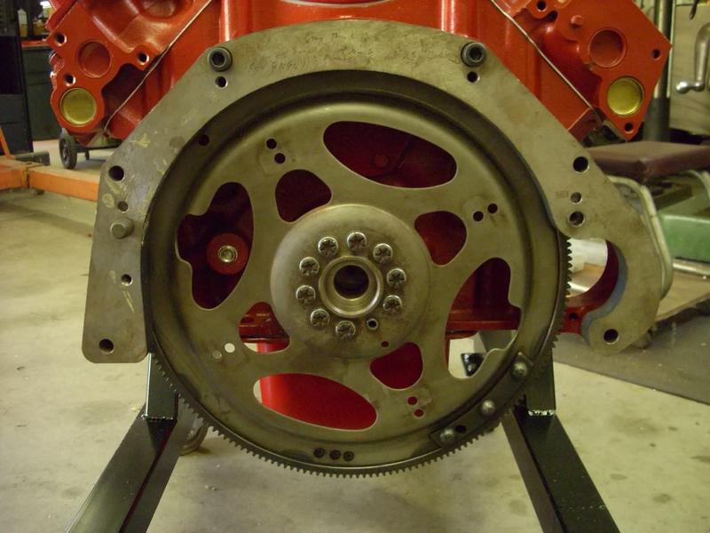

Maybe this pic will help. Its of another 345 I built but has a flexplate like yours. It should give you something to compare.
Just wondering, but does the hole on the outer edge of the flex plate, in line with the roll pin,have anything to do with the alignment? Almost looks like the hole is there for that reason.
Might have something to do with fixturing during the mfg process. The real clocking indicator will be the big weight riveted to the outer rim on a perpendicular radial line from the roll pin to the outer diameter. Easy to see in db74's photo. That it the heavy side. If you look at your crank, one hole will not have threads that is the index point for the roll pin to go in. Now assuming (ass-u-me) :smilewinkgrin: you have the tf727 trans you will have a spacer that the goes between the crank and the flex plate. You need to index the roll pin to the correct through hole.
