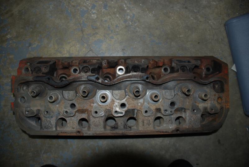

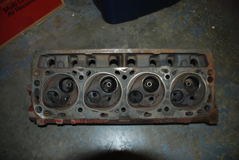

An ic 392 block,....must use ic heads. No way any other heads match the jacketing and the head gaskets are significantly different. We've addressed this issue several times in other threads in this same sub-forum.
There is no such thing as "five stand heads" and "nine stand heads". All heads are drilled/tapped for nine stands. The five stand versions simply have threaded plugs installed in the unused holes.

I read over all those other threads, I just never saw where anyone had said "this is better than that" and why, thats why I asked about which is better. If you recomend the 9 stand with welded rockers I'll go that route, I have 3 left and right sets of the welded rockers with stands and shafts sitting in an old oil pan, I am pretty sure I can scrape together two good sets out of that. I did notice you where running out of the stands, I am sure I will have alot of extra of those after I am done, do you offer some kind of credit for sending in all the leftover parts? I also have a ton of push rods as well, ball/ball and ball/socket types.
Also, just posted some pics of a set of heads I have in the basement, trying to figure out if they are ic or not, last pic is a 345 head next to the one in question.

Thanks! I went through the other thread, didnt see alot in there about the heads, I appreciate the fast response.
You are right, not as much about the heads but figured in the context of your question you could see the block differences also.
I looked through it and used it to figure out ive got an ic 392 block and a 345 block that I pulled out of some dudes tool shed. There was also 3 sets of heads in the back of an old travel all I bought from him, now I know two sets of ic 392 and one set of 345, the other set of ic 392 is tore up however, got a broken valve stem stuck in the guide, rust throughout......... Probably junk. Next question I have is does anyone know where to get main caps for a 392 and a 345 block? Are they the same? Will used ones be okay to put on there?

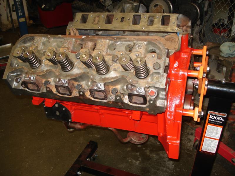

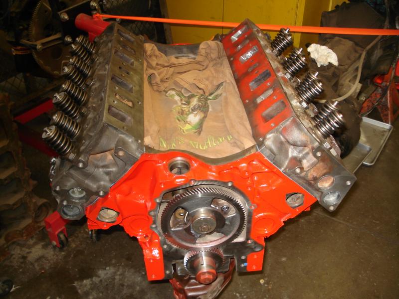

Well, here goes the news, pulled the 392 apart.....some of the lifters where so bowled I could use them for breakfast cereal, couple of cam lobes flat...po had left the hood off and carb uncovered.......water in intake manifold led to mass of rust in bottom of plenum.....water made its way to the first two pistons on passenger side, front of engine, rusted on piston walls.....praying some honing will clean it up. Cam bearings totally shot, chunks in oil pan, looks like someone chisled at them when I got the cam out....good news....main bearings and rod bearings had been replaced recently, still in great shape except for some gouging caused by po cranking engine without pre oiling it. Need to replace all them. How long does it take to ship bearings to alaska? Oh, carb complete froze and nastified. Will be replacing that with edelbrock perhaps. Looks like its almost time to order some parts, need headers, engine mounts, trans mount, carb, few other things. Also, complete valve job in order as well, good thing is has hardended seats already installed. Nother month and maybe will be able to fire it up!!! Cant wait.
Okay, just wanted to update......got the 392 cleaned up, just got done lapping the valves/seats, got them sealing very nicely, no valve job required...that was a relief, got he heads on and torqued in today, oil pan on, timing cover/balancer on.(not in picture however) slowly puttting this thing back together, will be sending my Holley 4150 off to mm for his miracle work. New cam, comp h260 grind. New bearings all around, oil pump rebuilt. 727 back from rebuild at shop, new torque converter. Got my headers and engine/transimission mounts form iho the other day hopefully will be able to use them soon trying to get that engine in the Scout before butt nasty cold weather sets in around here.
