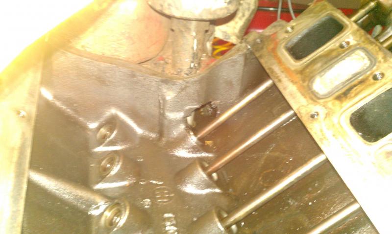

I'm still going through the motor and I had a few questions. First is the hole to the timing and dizzy normal? (the first picture).

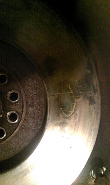

Second is I looked at the fly wheel yesturday and have these heat cracks in it. Can I still run this or should I get a new one? (second picture)

That rough hole is normal. They have to knock out the casting flash and it ends up looking like crap.
Those are usually surface fractures and they will 99% of the time go away upon re-surfacing. Have a close look after resurfacing and see that they are gone. If you can see them extending around the wear surface edge you should get another one.

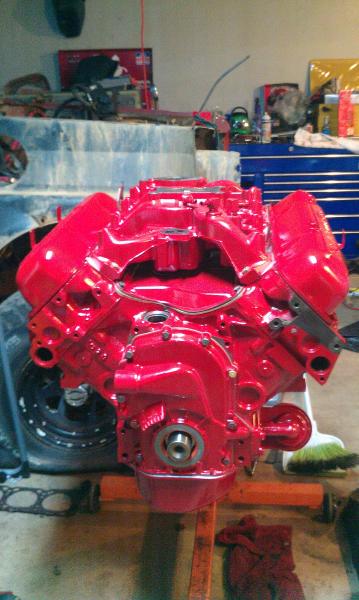

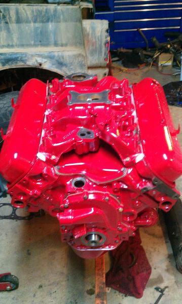

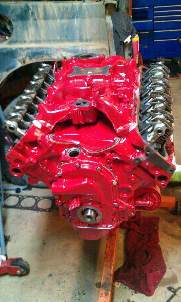

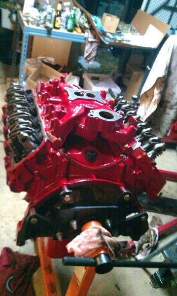

Yep you caught me. I tried to suck it on with the bolt and trashed the threads. I tapped it and it looks and feels great. I havent tried to put the pully on yet but that will be this weekend. Here are some pics of where im at. The color is red ut the pis make it look pink and purple. The gasket kit I got from IH Parts America is working out just fine.
