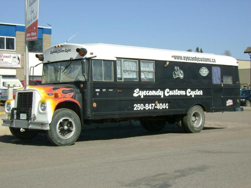

As this is my first post let me introduce my self. Sam from smithers, bc. I run a 72 IH bus as a motorhome. It is all painted up "flat black with flames" like a hot rod. We use this bus at the drag races as our base. I am a motorcycle mechanic so I don't do too much automotive work. The distributor was pulled from this unit in order to purchase the correct "pertronix electronic ignition" system. I know that it does not need to be removed for the install but the parts guys insisted on seeing the distributor for themselves.

Thanks for the comeback! I did read elsewhere in this forum a little more about this procedure. It sure could be a "sticky" in these columns. I got it! I found tdc but had no way of knowing if it was comp stroke. (with the valve covers on) it let out a couple of big farts when I cranked it over so I rotated the rotor 180 and it flashed! It also puked gas everywhere from the carb. A new carb kit for the little 2bbl Holley is under $40 so its coming. It sure is nice to be able to "just ask" when you have a problem or need a little advice. Thanks again for your help! Sam.
