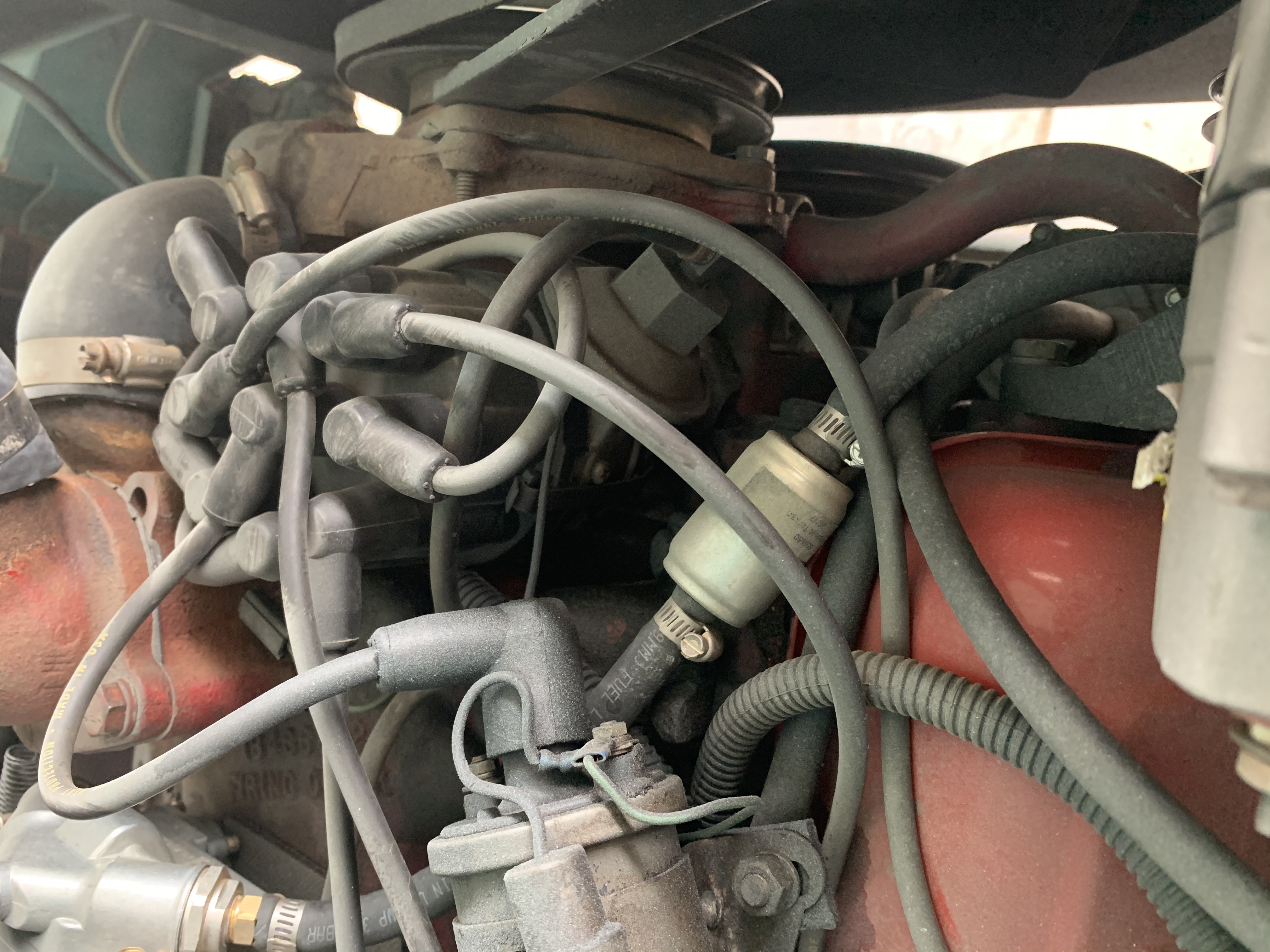

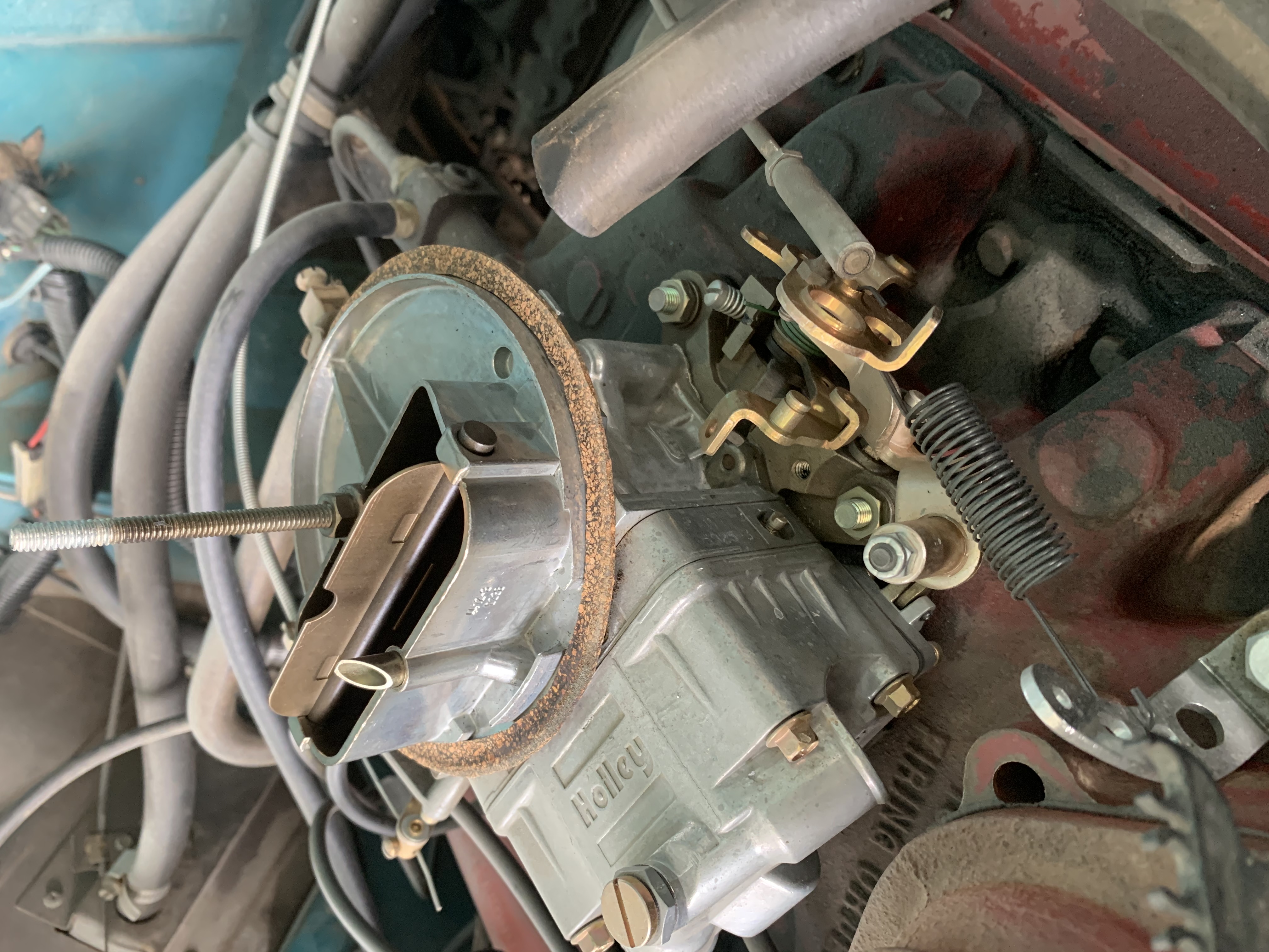

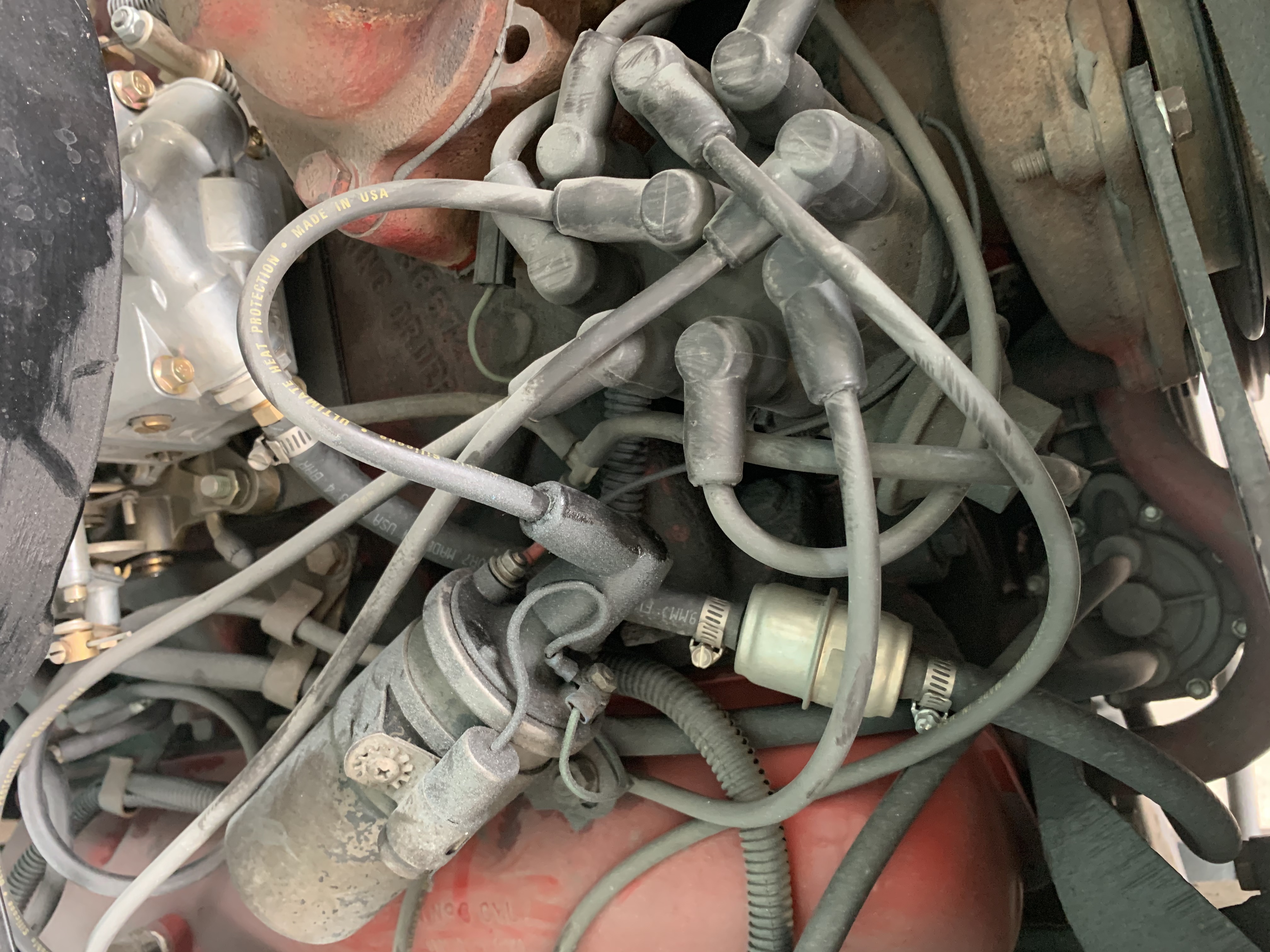

Congratulations on your purchase and welcome to the forum. I have some thoughts for you. First, these engines do not require hi-test (premium) fuel to run optimally. They are low compression, low-revving, asthmatic breathing beasts of burden. With spark and fuel systems in good working order, they will deliver their utmost performance on regular grade fuel with boring consistency. Is there any way you could be more specific RE "amps gauge dancing like crazy"? Perhaps a link to a youtube clip of this would be instructive. Pictures from multiple angles under your hood with the air cleaner canister out of the way would also be helpful. For anyone to really provide any meaningful analysis and advice for you, we first have to know what components are in place atop your engine. If you are unable to provide these specific component details, this is where quality pics and/or video can do your speaking for you. There are a number of us on here who can make positive ID of things and also potentially point out issues simply by being able to hook our peepers on them. We need to know what carb you have, not only the brand of it, but also the model and the list number. We need to know what type of choke system it has, if at all, and whether or not it is functioning properly. The seasons have changed since you first started driving this rig and even though you're somewhere in CA, the ambient low temps have certainly dropped at least a little.

I see the carb is a list 4412 500cfm flavor. I'm assuming this was on the truck when you purchased it and not something you installed? You won't like what I have to say, but I'm going to tell you flat out that's the wrong carb for your 304. Way too big. Those 4412 versions are more geared towards engines that can turn high revs and are running them consistently, such as in circle track racing. The carb you should be running will look almost identical to that one, but it will be a list 80350 or 0-7448. Those are 350 cfm rated and calibrated much closer to what would have been on your engine originally. Like the others have stated, your idle speed sounds like it's down around 400 rpms. Too low. Should be about 650 for manual trans and 750 in Park for auto. If you suspect that your battery isn't being replenished while driving, you can buy an inexpensive digital multimeter. Probe across the battery posts with it set to measure voltage on the lowest scale while the engine is running at a proper idle speed. You should be seeing over 13 volts even up to 14.5. If you're only seeing 12 volts, then you have a charging issue. Back to your carb though, both for your long term enjoyment of the vehicle and for coaxing out what precious little fuel economy these engines can give, I don't see you ever hitting the mark with that particular carb.
