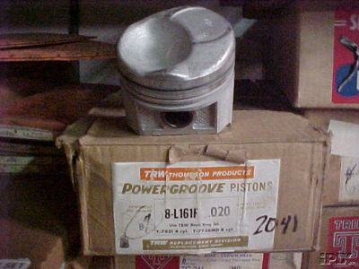

Pictured is a contoured piston used in both the non e 152 and 304. A flat top is as indicated "flat"
