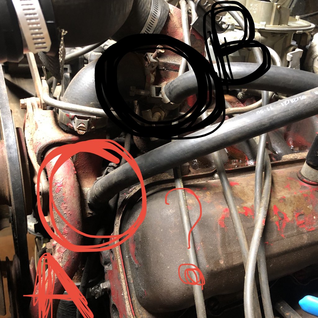

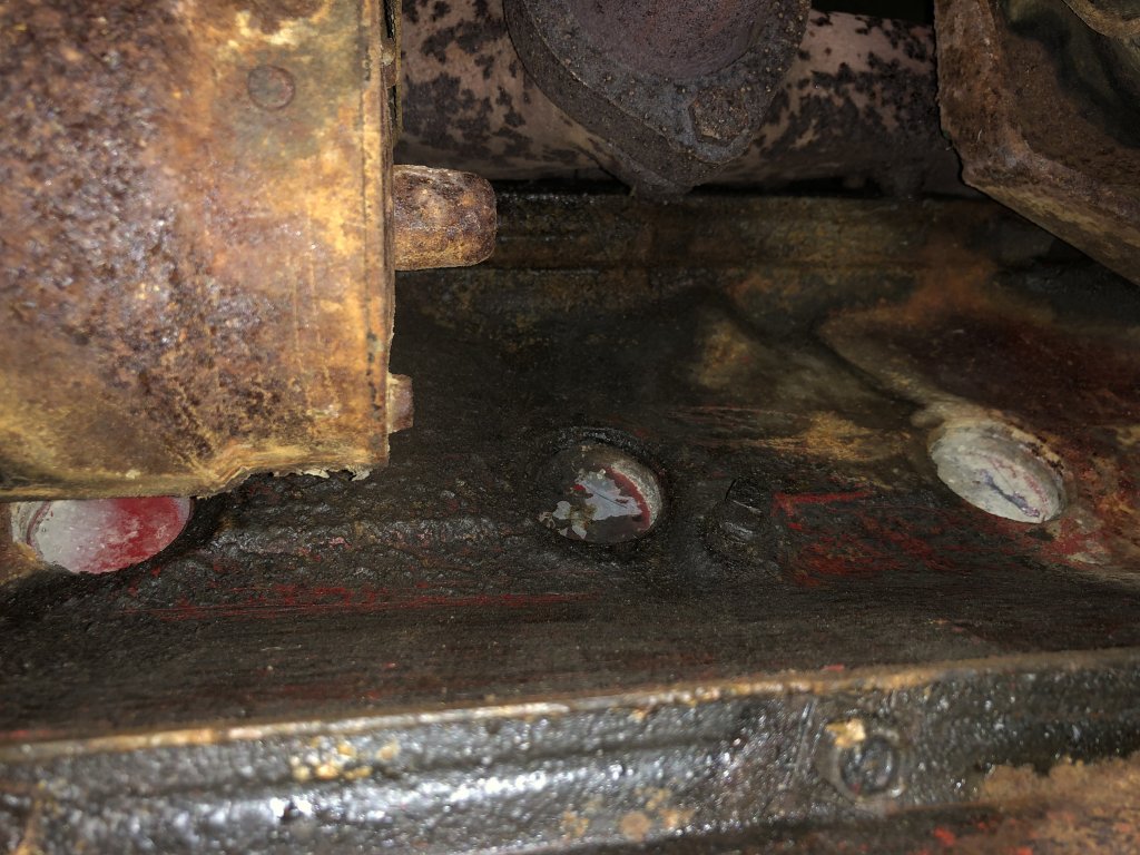

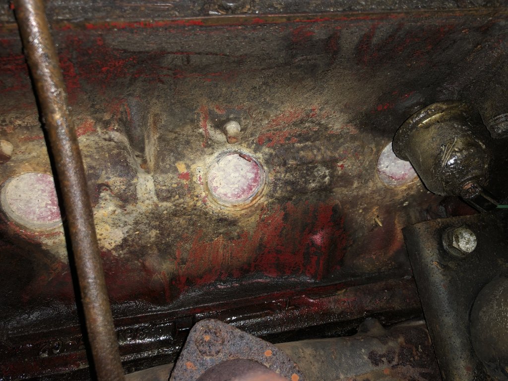

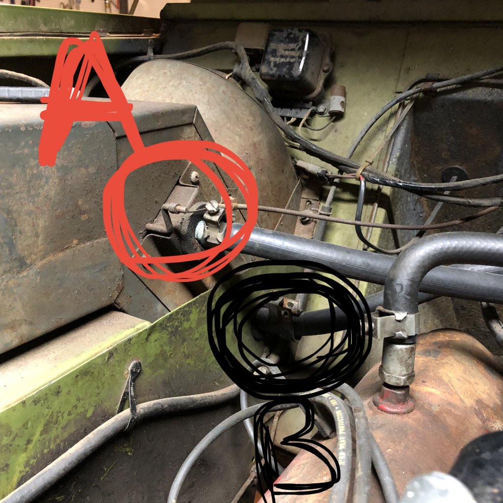

Ok, thanks again for going through this. I’m pretty sure i know what’s next now that I’ve rebuilt the carb. I attached a few photos to make sure I do what needs to be done. The 6 drain plugs don’t seem that crazy. As long as I don’t need the additional ones that look to be a pain in the ass. The other photos identify what I think to be the correct line to tap into for the filter setup.
  1. Are the 3 drain/freeze/core plugs on each side sufficient to remove? For a total of six large plugs and replacing with brass?
  2. Am I tapping into the (A) line that goes to the heater core? Or do I have this mixed up?

One 1/4" plug for each side for the water jackets. Careful there's also plugs for the oil gallery. Draining the jackets pretty much empties the block.
What I did for the filter is pull the heater hose off the thermostat housing and put it on the filter outlet. Then a short hose from the housing to the filter inlet. This way when the pump pulls from the block, or when hot enough the radiator, or both; all the coolant will get filtered in a short time returning to the engine through the heater system
Ok, so the line from the thermostat housing is the heater core inlet then. I will find somewhere on the firewall to mount the filter. The 1/4” water jacket plug is the one in the attached photo?
Yes, next to the core plug.
I wouldn't mount the filter anywhere. This is only temporary. Give yourself enough hose length to stay away from the belts. Also, no pressure so keep the cap loose. As I posted, it only takes about 20min to 1/2 hour of fast idle to clean things up.
