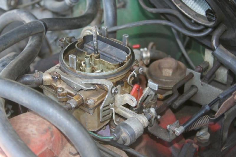

it starts right up on one pump and idles well. It has the the typical flat spot off idle and I no longer want to mess with it. Tired of dying in the middle of an intersection! I am ordering a 2300 with electric choke to replace to 2210.

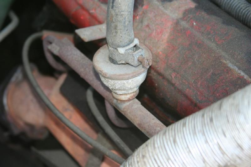

can I remove the smog plumbing from the exhaust manifolds and plug the holes with the proper threaded fittings, without mucking up something else? If I get everything back to being dependable, a set of stans headers will solve this issue.

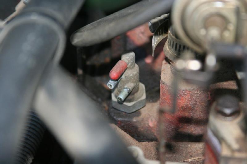

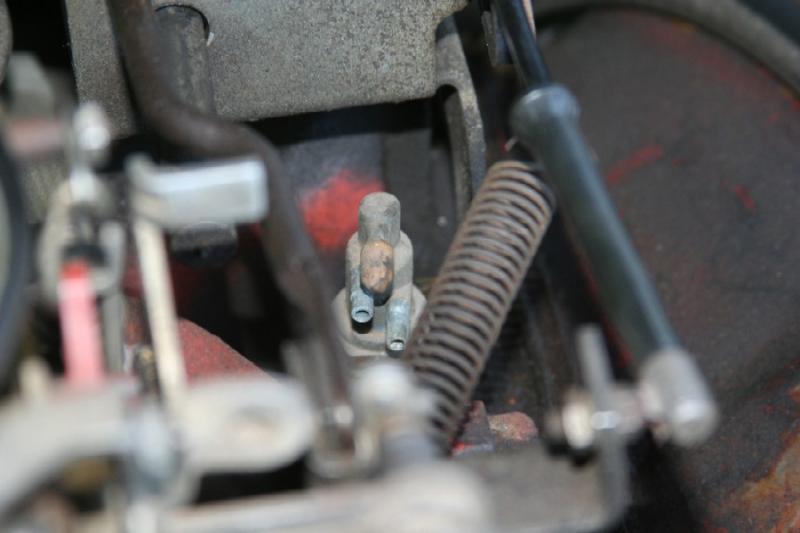

what are the two vacuum port fittings on either side of the rear intake manifold used for and can I "optimize" them with a plugs as well?

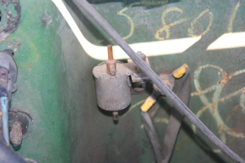

what is the vacuum "module?" on the firewall used for? It has nothing connected but has tees for vacuum lines. Does a properly "optimized" motor need this?

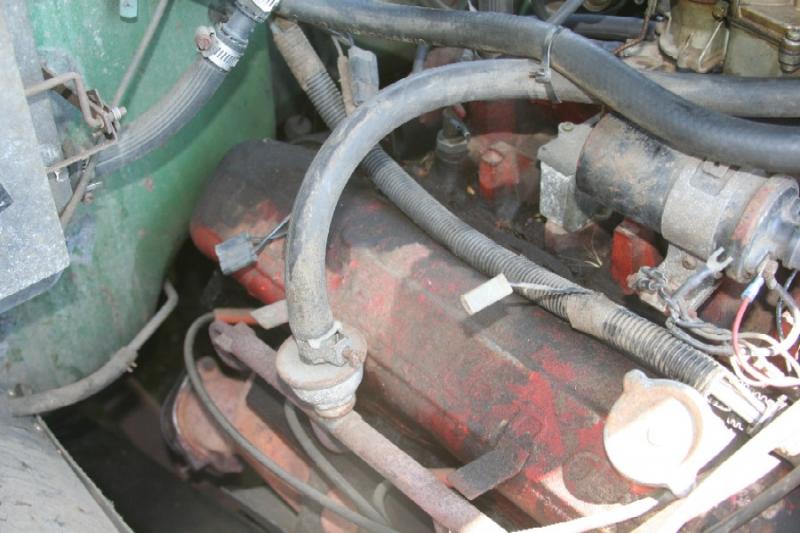

there are several loose electrical connectors on the passenger side of the motor. Any input as to their use and relevance would be appreciated.
You can plug them without any ill effects to the motor, just another area to look for a leak
Those are temp activated vac ports (coolant), you won't loose any vac without anything hooked up to them, with the correct plug you can block them.

the egr canister is taking up space and has nothing connected to it. Can it be removed and plug the manifold?
Yes, I got mine in the kit from ihon

They sell a 2300 350 cfm carb and kit with different options if you call them. Its not too hard make one with a thick piece of metal just trace the egr pattern out, cut, drill 2 holes, and add a gasket.

All intake manifold penetrations/vacuum switches penetrate the water jacket, so to delete those items the coolant must be partially drained. Those are vacuum switches operated only by engine coolant temperature and are used to make minor changes in ignition and carburetion peripheral settings when the vehicle is in use under all potential driving conditions. Eliminating all these items has no affect at all on engine operation if done correctly.
The n=8 a.I.r (air pump) tubes can be removed and the penetrations sealed with appropriate fittings. Again we've posted about this over and over so just do a search for typical methodology. Likewise the air pump itself is removed from it's bracket and set aside
the small module on the bulkhead is also an emissions device that would normally have a vacuum hookup, it's only used in a "deceleration" event from a cruising speed and is also controlled by engine temp. Simple remove it.

The egr valve can be eliminated, we have in stock a special block-off plate for that use. However, when eliminating egr that is actually functioning, you will most likely have to slightly retard the base engine timing so that you don't have detonation (ping) under a partial throttle load.
Non-connected wiring harness items are nothing. The harness itself is designed to be used in all versions of the fullsize vehicles of that era, no matter which engine and accessories were ordered into the rig at manufacture. These harnesses (and vehicles are nothing similar to the Scout II, so many things we do with these units can't be done to a Scout II and visa-versa.
Your oem air cleaner will only fit the 22xx series of carburetors due to it's mouth diameter which is a "special". All aftermarket air cleaners will have a 5-1/8" opening and also include a "punch-out" that is used to mount a fitting for connection to the oem flame arrestor located in the valve cover, works exactly the same as a stock unit.
The '74-'75 model year vehicles had the engines dropped down and moved back, there is a considerable amount of underhood room for nearly any air cleaner without impacting the hood.
