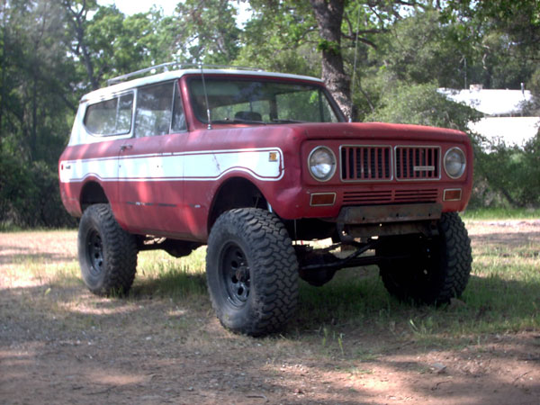

Ok, here it is..
1973 Scout II 345, 727 Dana 20 seen here with some 4" shackles and a bump steer that would scare the bajeebies out of anyone..
Got it for $200.00 licensed for under $60.00
planned SOA to fit 35" tires.

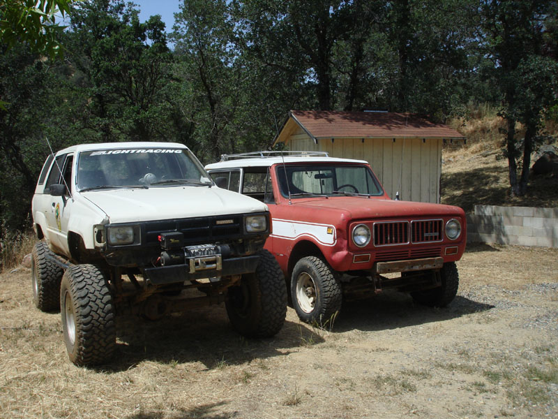

Here is my gage.. My buddies 4-runner. This wont do.. :nono: the Scout must show its beef on the outside not just the inside.

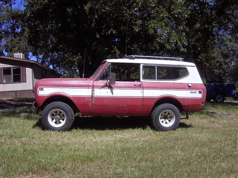

Well jumping well forward, due to time. Here is where I am at currently..
35" mtrs
SOA
tune up the engine
on the schedule..
Repair broken trans. Mount
repair bent tie rod... :mad2: ( will worry about tougher one at time for hi steer )
4.56 gears and at least rear locker..
That should allow me to have some fun when the snow hits this winter...

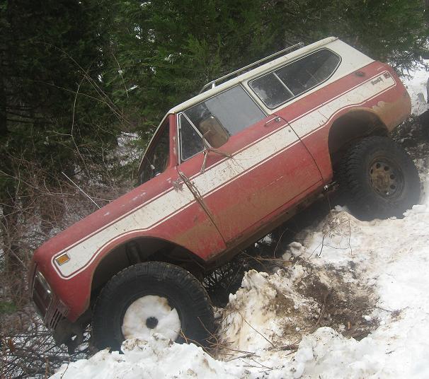

1st Snow
Well, I would have to say that my Scout does wheel extremely well in the snow. However, it seems that even a good wheelin' rig is only as good as its driver and this driver is not immune to mistakes. Here is my first stuck.the ol' Scout did hold together well and after returning the atf that poured out the trans tube I was able to drive back down the trail.
:icon_4laugh: I made sure not to lose anymore fluids.. They were kept secure, and consumed while waiting for rescue. Not to condone that though. I was definitely reprimanded by the way better half at home. :nono:
Yes. The pucker factor was around 9.2 I still had seat cushion when all was said and done though.
