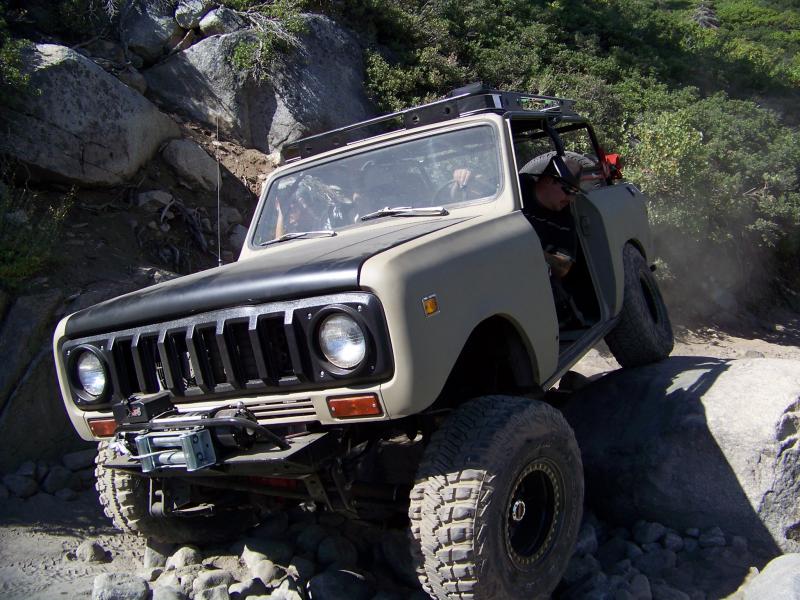

Here is a pic of the tires in the rubicon last August, we made 3 halfway in and out runs last year on them.

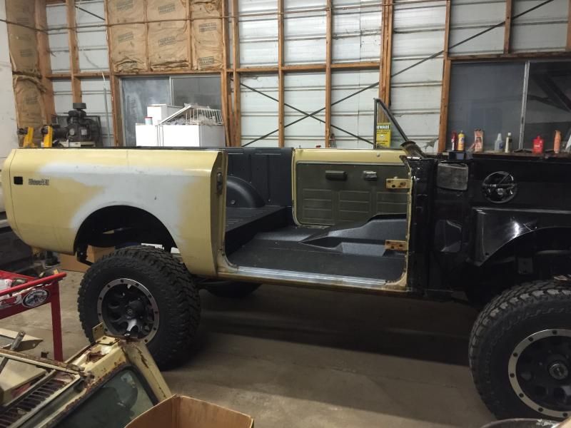

Okay update. Not much to say on this one I havea lead on possibly trading someone my SUA axles for his which are set up for SOA. And I have been doing more floor repair:
Used this product called rustmort by sem which is supposed to kill rust in pitted areas so using that on the floors then will topcoat with a silver filler to smooth things out to get ready for the bedliner floor coating, then on the body parts with the rust pit issue I will rustmore then smooth with a polyester filler

If your wondering there is still a frame under the Scout. My cousin has been buying and selling scouts for the past few months trying to accomidate all the parts to restore his so in all the moving around of his scouts I ended up with an extra frame to do all my fab work to then when I am done I will powdercoat the frame and swap the body over.

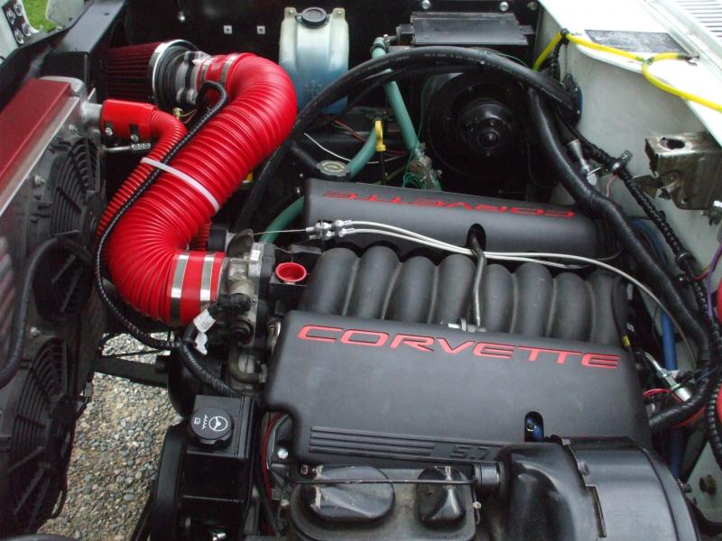

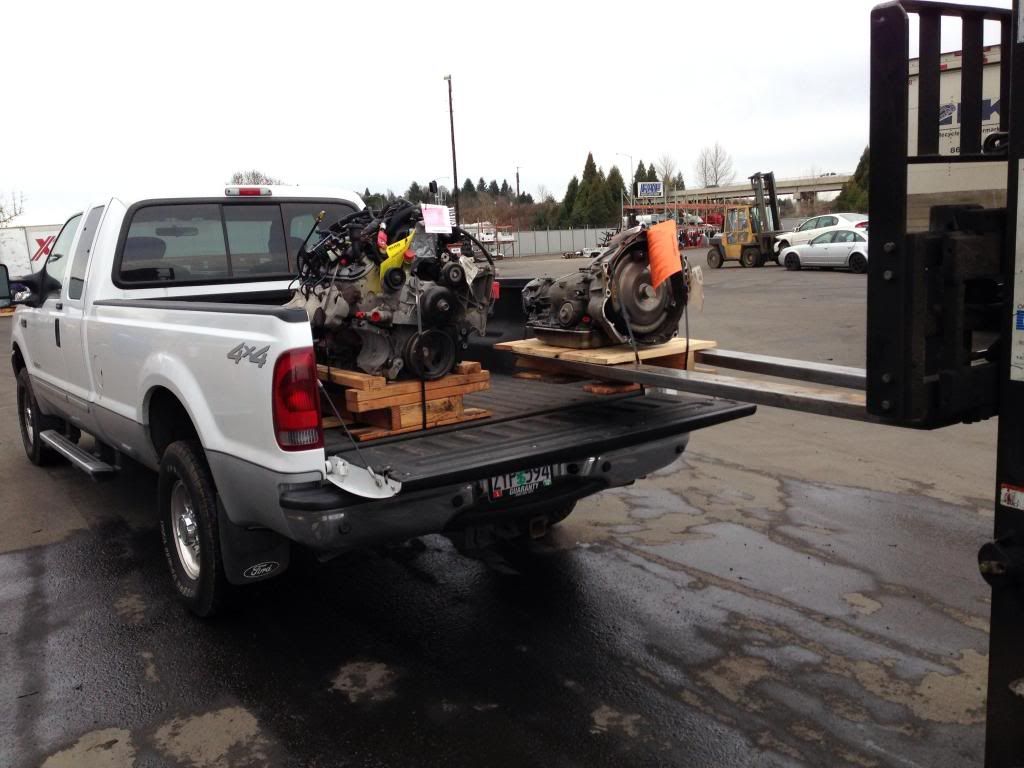

Decided to go the ls route, so hoping to pick up a 5.3l later this month. Will be selling all the stuff I have for a TBI setup a bit later this month.

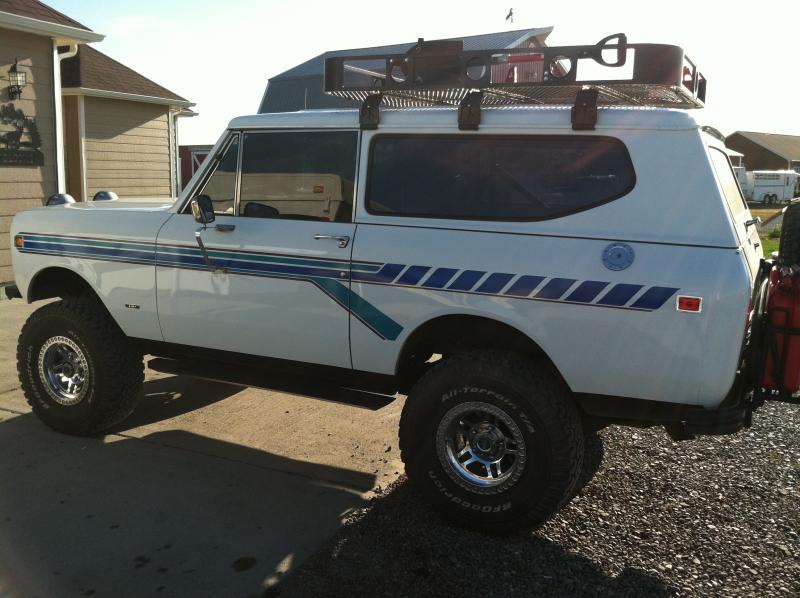

It looks quite a bit different and rides alot different. Just for fun here is a couple of my old ride from when I was younger:

Update time, I had the rusted pillar repaired by a local restoration shop and had a spray in bed-liner put in. Next month I will be taking a trip to Colorado to pick up a fully assembled roll cage as well as front and rear bumpers as well as rock sliders from d&c, I May also stop by corbeau seats on the way. I also have since received a tuffy security console as well as a lokar cable shift system for a GM column shift setup, I also recently received a custom built aluminum radiator for the ls swap meant to be a factory fit for for the Scout.
