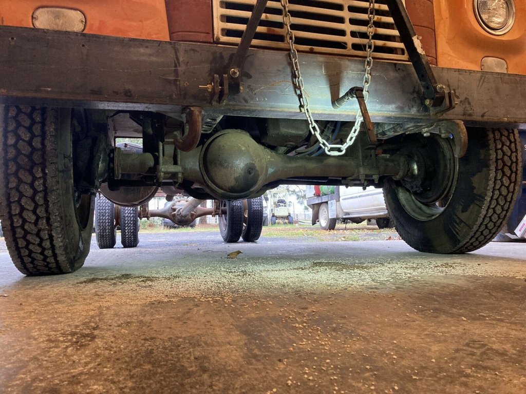

There is a Loadstar 1600 4x4 for sale on e-bay right now that claims to have a Dana 70 front end but it doesn't have the traditional Dana60/70 pumpkin cover. (See attached picture. Perhaps I should contact the guy selling that truck and see what info they have on the front diff. To me the 1500/1600/1700 loadstars are a definite step up in truck size but I did read somewhere that the 500s didn't sell that well because generally buyers in that category were opting for a loadstar instead. I also read that some of the transmission choices that International offered applied to both the llght line and the loadstars though so it is certainly conceivable that the differentials could overlap as well, The rear differntial currently in the 500 is much larger than any Dana 70 I've ever seen and I expect it is an IH axle. If memory serves me correctly it is smaller than the diff that was in my 1700 but not by that much. It's certainly conceivable that the Light Line 500s and the Loadstar 1500s would have used the same drive train so that's a very good point. Was four wheel drive a factory option in the Loadstar line in 75?

IDK what the GVWR is. Maybe Netpro can tell us what his is. The FA-28 I-beam that they came with has a 4000 lb rating, as does the FA-52 Dana 70 driving axle that could be optioned on the 200/250 trucks.
Thanks for the additional info guys. The LST says the GVWR is 13,840. It calls for a FA-28 4000# front axle and a 10,000 rear axle and spring with 9,840# tire/rim. The truck has five lug split rims and 750/17 tires. It says there is an RA-20 housing and a 4.87 ratio carrier.
