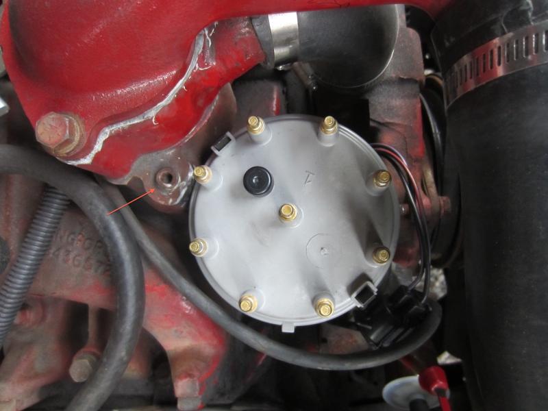

Thank you very much. I am a rookie mechanic and just taking it step by step. Also my engine temperature gauge is not working and I cannot locate it on the engine. Do you know the general area where it is on the block?
thank you very much. I am a rookie mechanic and just taking it step by step. Also my engine temperature gauge is not working and I cannot locate it on the engine. Do you know the general area where it is on the block?
The temp probe is located on the intake manifold adjacent to the thermostat housing, right side (passenger side in the usa).
Photo, where the plug is installed.
I moved mine to another location, hence the plug in this photo.
