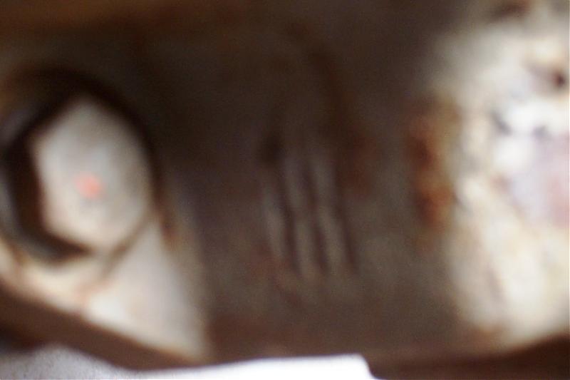

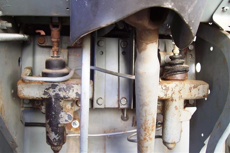

Hi all:
I'm working on the above mentioned truck. Its on a International m-1200 chassis w/ 304-v8. Here are a couple pics of the master cylinder. It has IH cast into the housing. Need help as to what system I have. I have never seen anything like it. Looking for rebuild or replacement parts.
Thanks,
mjolnir

I sure hope I am wrong but I think you are going to find it very hard to replace that mc. To be honest with you I have never seen anything like that before and I have been around awhile. It might be a very common spec part in the aftermarket truck body industry but I doubt it. Imo, your best course of attack is to have it professionally sleeved. With a stainless steel sleeve, your mc should last longer than most of us will be alive.
Another possibility is a hydroboost. There are Ford and GM trucks that have a verticle linkage like the one you have there.
800 hydroboost? - binder planet forums

I have microfiche at the office that covers this model, iirc. I'll see if there is a mc rebuild kit number. The trucks that have the horizontal and vertical linkages like the one in the link provided were p35s I think. I know where there is a lo mile m-1500 in a jy in jersey, I have to go there anyway.
