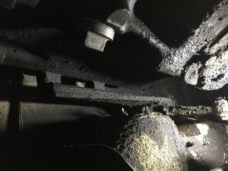

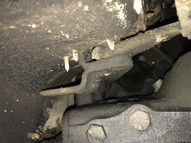

Hi I'm new to this site I have a 1968 travellall 1100 5 speed manual that was 2 Wheel Drive and I'm in the process of converting it over to four wheel drive. I have the front axle installed and the divorced transfer case installed along with the driveshaft to the transmission. I have most of the linkage to shift the transfer case into four wheel drive I was wondering if anybody had a picture of how the linkage bracket bolts up and if it bolts up to the transmission?

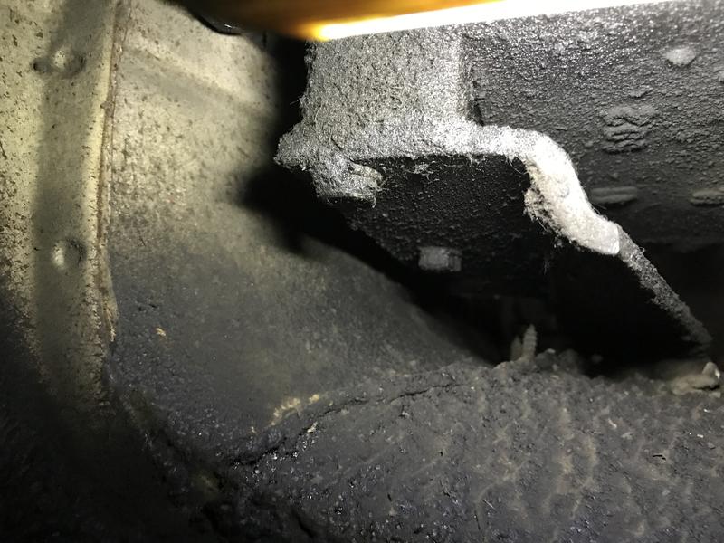

I have the setup you are installing in my 68 T-ette 4WD. I'll sneak out and see if I can get some useful photos for you before it starts raining.
Pictures added.
thank you, the bracket in the first two pics that is bolted to the tranny is the only piece i dont have. i should be able to make one from these pics.
