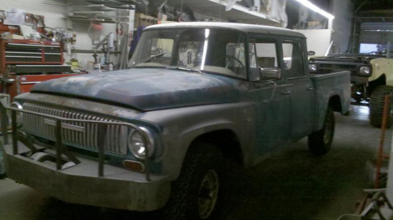

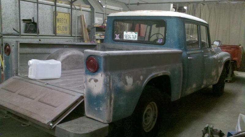

I just got one in the shop today to do some restoring dont know much about em but there pretty roomy and big dont know what year it is mayby you could tell me from the pics

I will guess it looks to be a 65 or 66 year model. What does the registration indicate? The grill is not from the 67 style. Doesn't really matter much as long as you are happy with it.
Both look great! Yet I'm curious about the 65 or 66 1100d , is it get'n custom color or factory? And look @ those bumpers, nice I thought I had some huge custom made bumpers on my 1100d p.u. Those are the nicest I've seen!
Ya seems to be a 65 and we are painting the dash and interior gray and light gray on the dash owner has not decided on color for the out side but I have been real busy with rust repair
