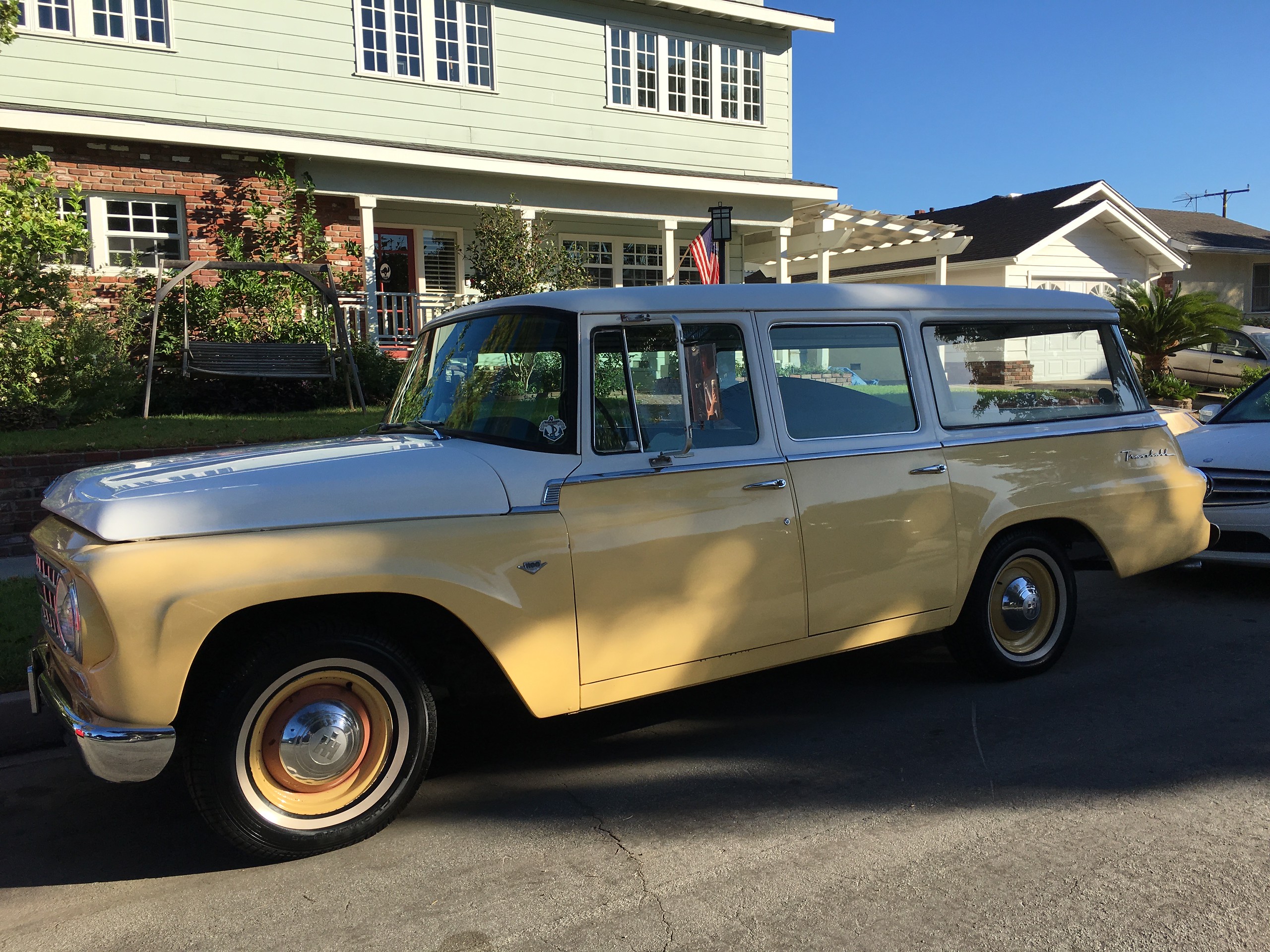

I hope to pull the 304 out of my Travelall for a rebuild.
Anyone know if the following are not too hard to come by...?
- Pistons & Rings
- Cams & Lifters
- Rod & Main Bearings
- Gasket Set
I know I will need to have the specs on how far over for the pistons, how far under for the bearings.
Just wondering if parts are readily available.
I need to have this thing back on the road & useful.
Thanks & Happy New Year!

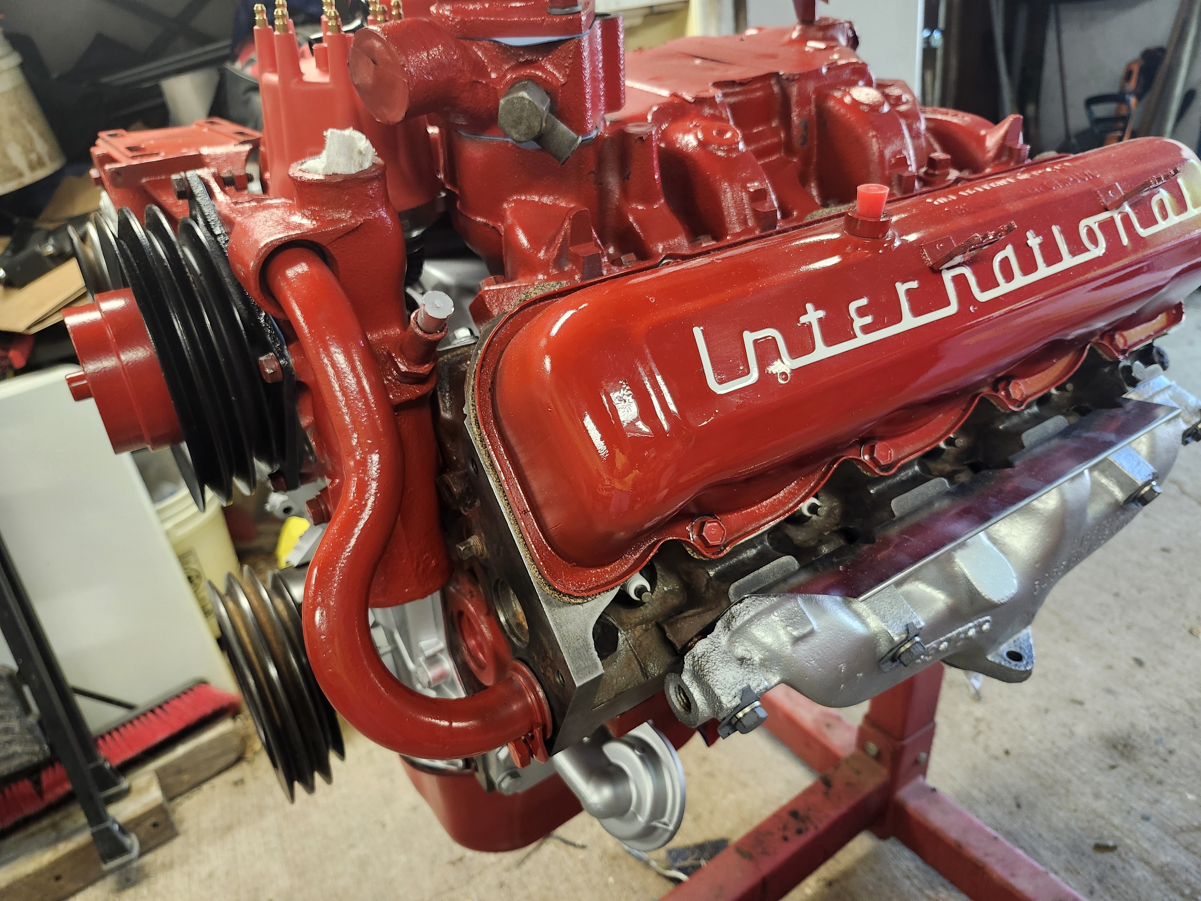

I had my 304 rebuilt 2 years ago. My machinist did all the cleaning and inspections and ordered all the parts. I put it together. I didn't ask him where he got the parts but it wasn't an issue. I think it was cheaper for him to buy all the parts rather than me having to buy it.
Whoa, that looks amazing! I will be asking many questions when I get to mine, so I can do the build as stock looking as possible, with the engine & the engine bay.
