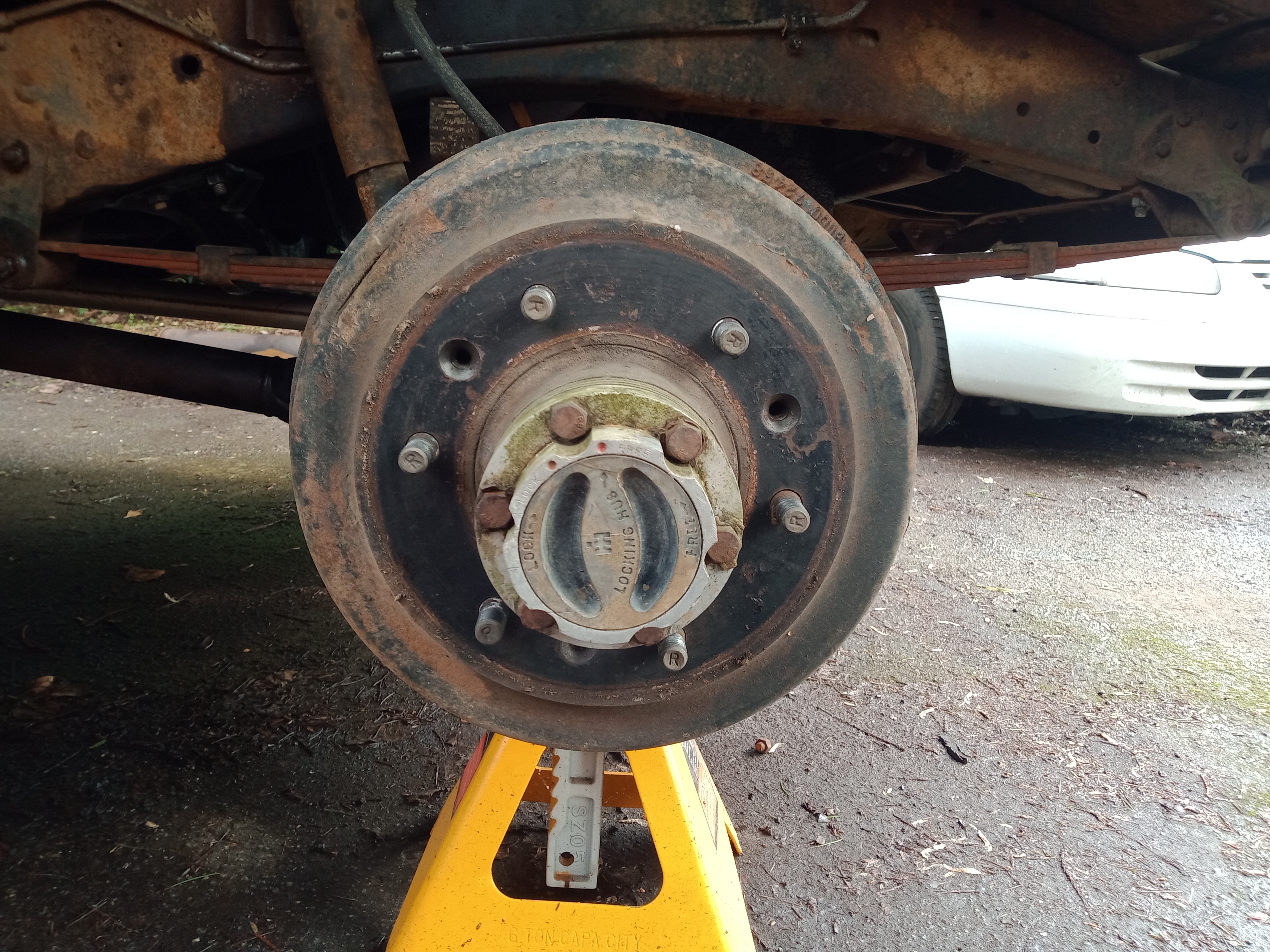

I don't think the disk conversion is particularly that tough, just have to have the ability to design and machine all of the parts. I do think there should be a commercially available drum that can be made to fit that application. There are online catalogs that have detailed dimensional drawings of the drums they offer. That is where I started for the rear 3/4 ton drums I put on my 68 1200 Travelette. I just sold it but here is a link the the build thread. Included are some photos of the front and rear brake fixes. I was fixated on retaining the stock axles and hub caps for the OEM look.
