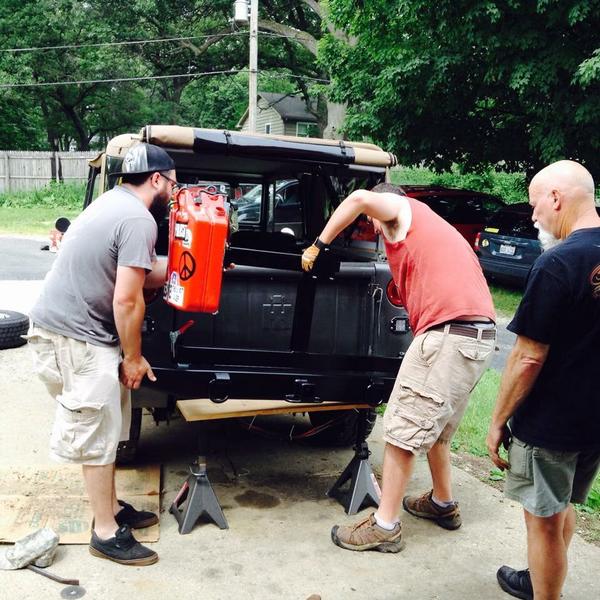

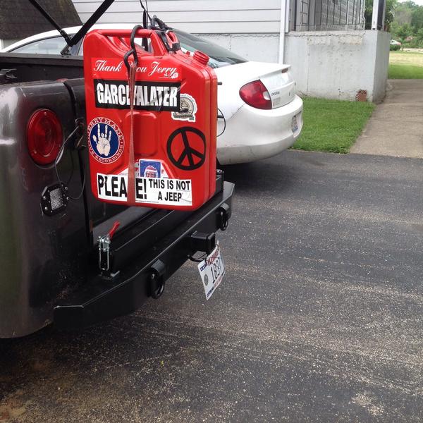

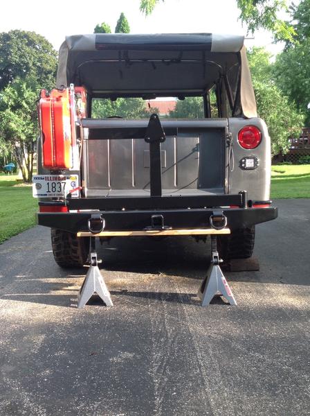

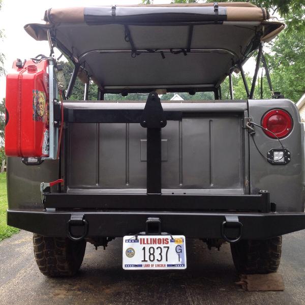

Anything Scout came thru. Now its time to install. Bumper looks great ! More pics later.

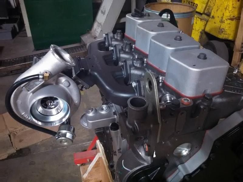

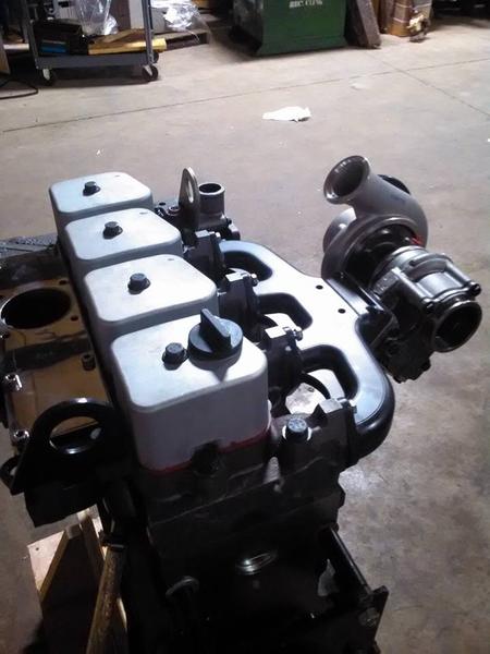

Cummins is on the rack. Getting ready for some fun.

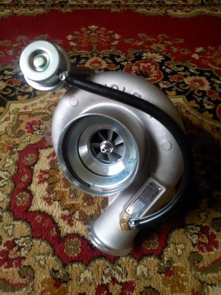

Going compound in the future. Steeds speed manifold super hx 30w direct from holset. Crate motor. Going to be p pumped 5x12 injector. Gonna o ring the head and add head studs. Possably a gorilla gerdle ..... 300hp target. 4k gov.

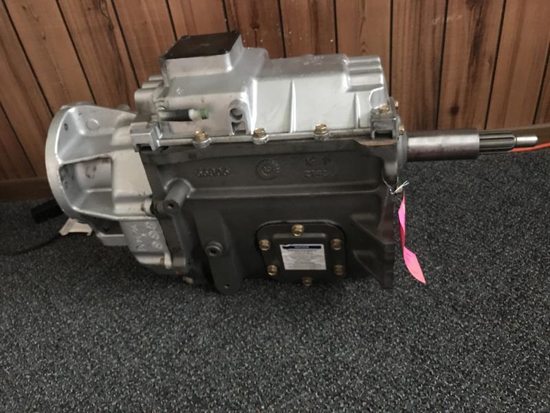

scouts going to be converted to d 60s nv4500 atlas 2.
Disk brakes. Power sterr and power brakes will have onbord air for tools
stay tuned.......

Still collecting. I have the nb4500 and clutch ,adapters
The atlas should be shiped anyday npw. Atlas 2 trail series I have a p7100 punp in the shop getting buld up. Picked up a nice acc braket for the cumnins Aswell. Low on cash. Id like to get my head studs in the. Paint Then assemble the motor. And get it to run
Plan is to have it down to old iorn off road. Somtime in spring summer. For body work and install.
