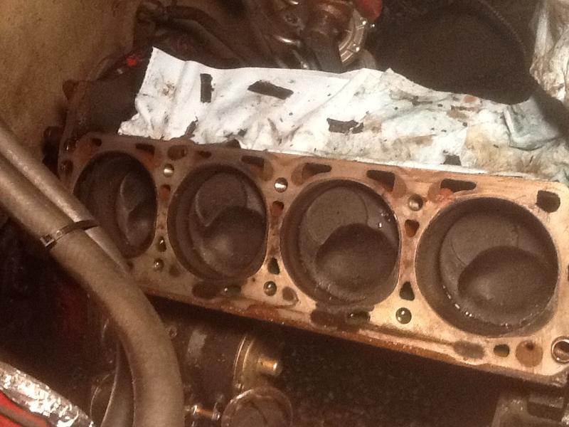

Robert, here's the block I want to put the 392 e head on, the head is non ic, & no air/inj. Pretty much the same as the old head combustion chamber wise.
That block is a contoured piston engine.
You can't use that head in your picture.
You will need the early round chamber head.

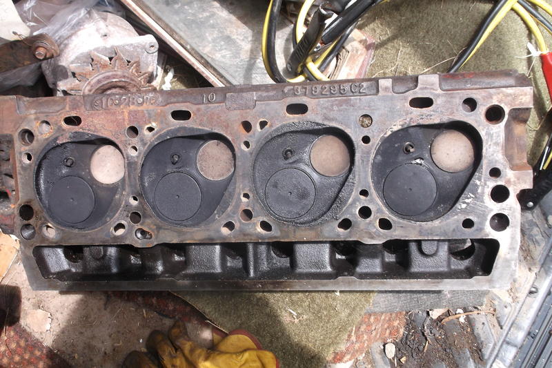

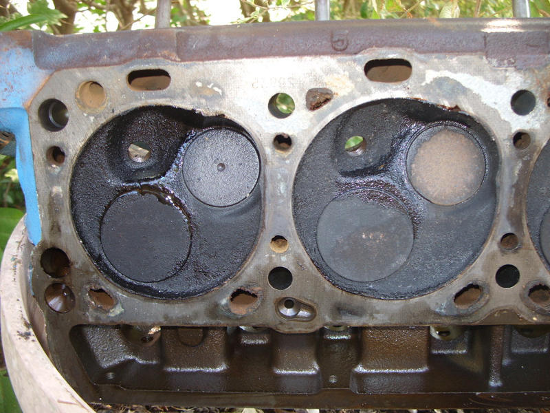

You need a head like this. Notice the round chamber.
Borrowed from another member.
Ok, thank you ! So then which 345 head would work, 1 with the same style combustion chamber ? The very early 345 ? Jeff

ok, thank you ! So then which 345 head would work, 1 with the same style combustion chamber ? The very early 345 ? Jeff
We were discussing a 196/392. The contoured 196/392 piston crown is likely to big to fit into the same styled 345 head.
I can only consider recommending you use a round chamber 196/392 head.
