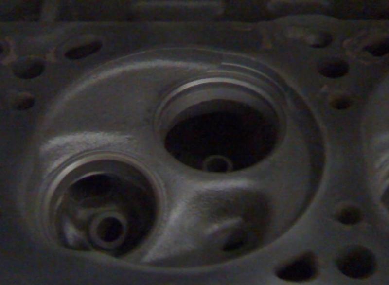

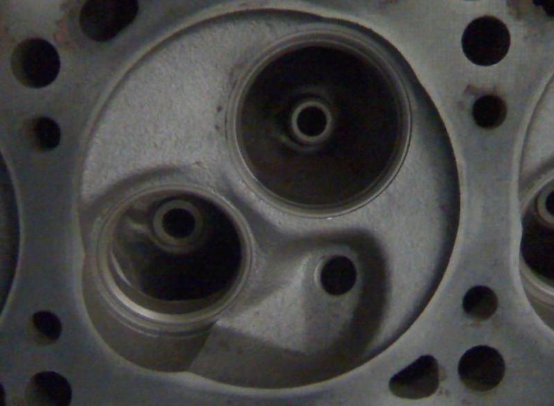

Pictures of the head combustion chamber.

That will definitely require the "contoured" type of piston. They are available.
The open chamber design of the contoured cylinder head will flow better but with flat top pistons, yield a low compression ratio. Using the correct contoured piston will give you the best results.
