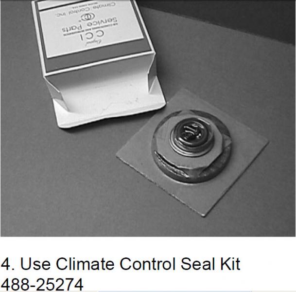

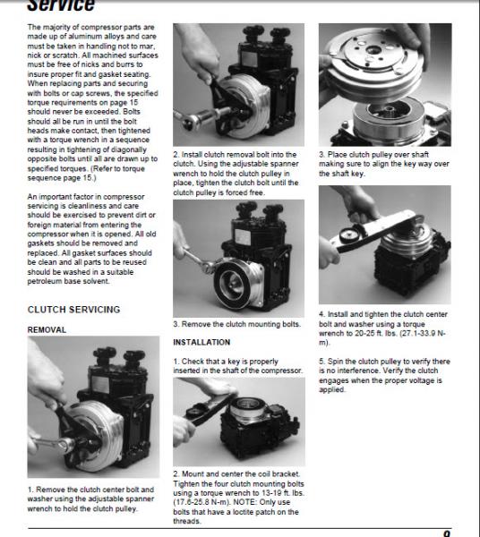

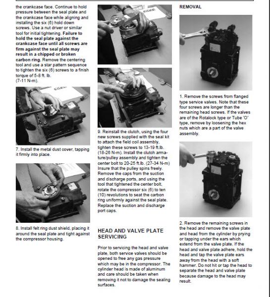

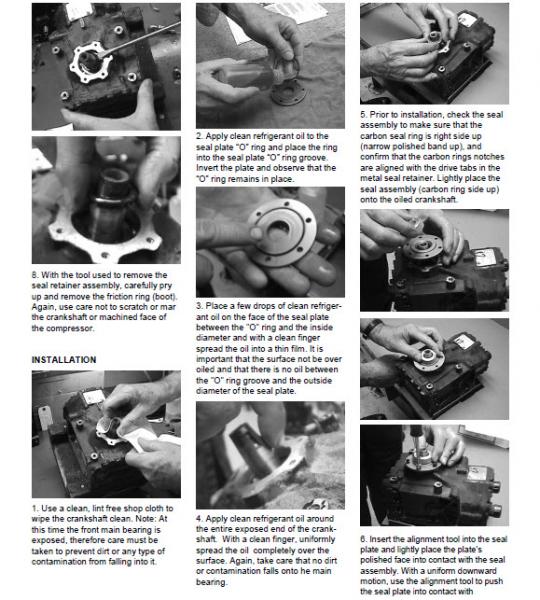

Posting this up for pigpen aka scouty
here some info on the york compressor.
